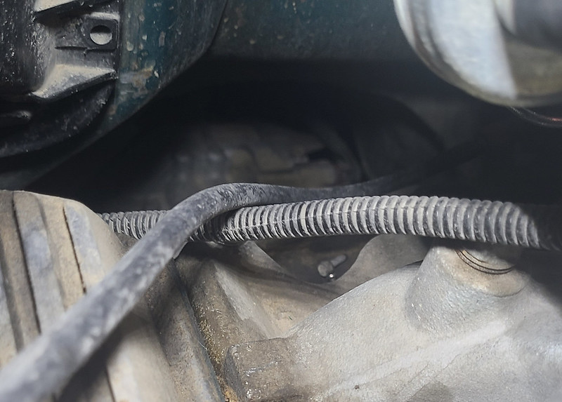

Last night I started doing the diagnostic pinpoint test on everything in the ignition. I checked the pickup and it it tested perfect. Next thing was to check the ground at the module... and nothing.
So I dug out the wiring going to the dizzy. Back when I was melting down DS modules I spliced in an actual ground wire, otherwise the entire ignition grounds thru the distributor base contact with the engine bock. It is weird, it is like in the 6-7 years the heatshrink shrunk more so one end was actually open. So I crammed my multimeter probe down in there and I have ground. Test the connector at the module and now I have ground there.
So I plug everything back in and hit it last night, it fired right off.
So tonight I go back out and I don't have ground at the module again. Give the splice the same probe therapy and I have ground again. Hit it again, fires right off again. As far as "cold start" goes, it is 32* out.
So later I am going to head back out and redo that and see if that fixes it.
