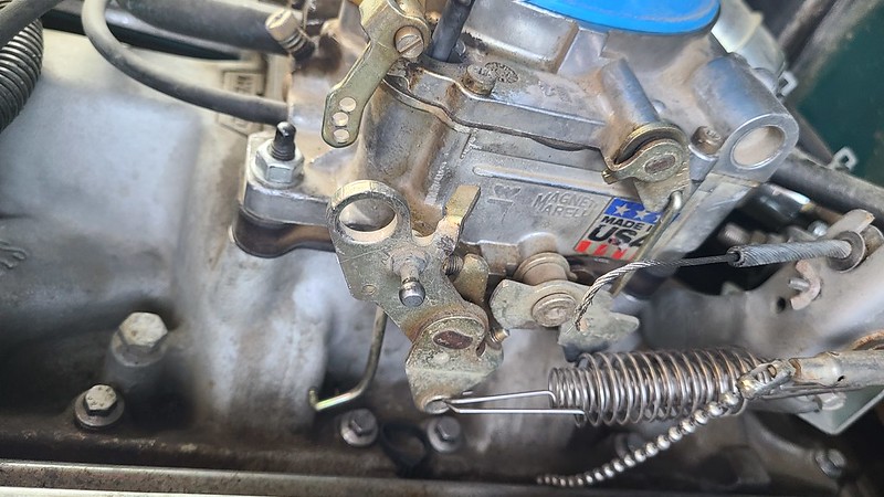

So this morning I went to back it out and pop, gas pedal went to the floor. My heart sank, this thing has to be ready to set sail early Saturday morning and throttle cables are unobtanium.
Huge shoutout to @r-hindl71 for doing an emergency mayday run to the only u-pull-it in Omaha that showed a first gen. Of course it was a 2.3... and the 2.3 cable is a lot longer than a 2.8 cable.
It was of course the same inside the cab and it clipped into the firewall the same. The engine bay side needed rerouted over the woods and thru the river but it in the end it does work.

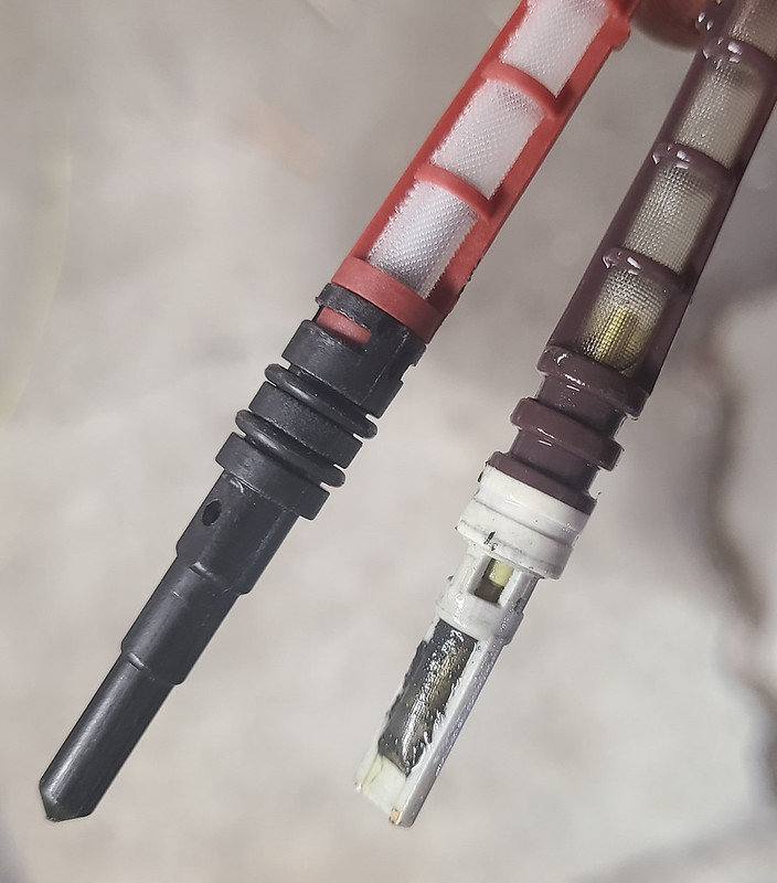

So once we were able to attain more than idle speed I sneaked it into town and had dad evacuate the A/C so I could check out the orifice tube.
Ran it home and pulled it apart... fun fact when you get the evaporator with the orifice tube they don't actually put the o-rings on the tube. Instructions are of course nil as well.
And it was in backwards too for whatever difference that would make.
So I learned two things tonight
1. If you leave off the orings it is very easy to remove the orifice tube down the road
2. If you install it backwards it is very hard to grab because the short end doesn't reach the end of the tube like it does when installed correctly.
