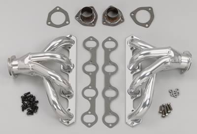

I'm doing a v-8 swap in my 92 ranger 2wd 5.0-354 stroker with an aod. I was going to use some tri-y headers from my 86 ranger that i made work with an aod but they dont look like they will fit that good on this one. I'm looking for a full length hp header, kinda thinking of making my own so they fit where i want them.:icon_welder: thanks all

anyone ever run block hugger headers on a ranger v8 swap?? summitt has some for sale.
http://store.summitracing.com/partdetail.asp?part=SUM%2DG9063%2D1&view=1&N=700+150+
Im running cast manifolds that came on my original five o and they fit perfectly. The left side dumps straight down and the right side angles back. With my stroker i have a feeling they are restrictive but custom headers will come next.
mine are from hedman driverside goes toward the back and pass side goes straight down to clear the starter like a hugger.there for ranger swaps
i have a 5.0/ AOD in my 84 Ranger and Mustang Shorties work good, some cutting of the pass upper frame rail will most likely be needed but thats all that i had to do.
Mine are Hedman's too. Very close tolerance on the steering shaft, but it fits.
