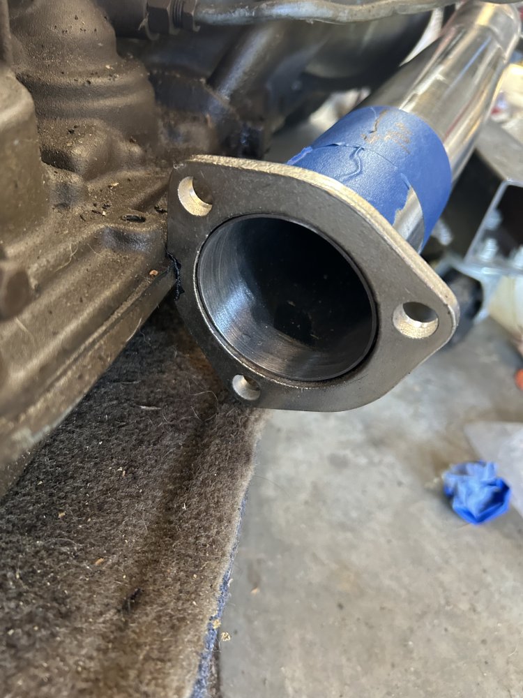

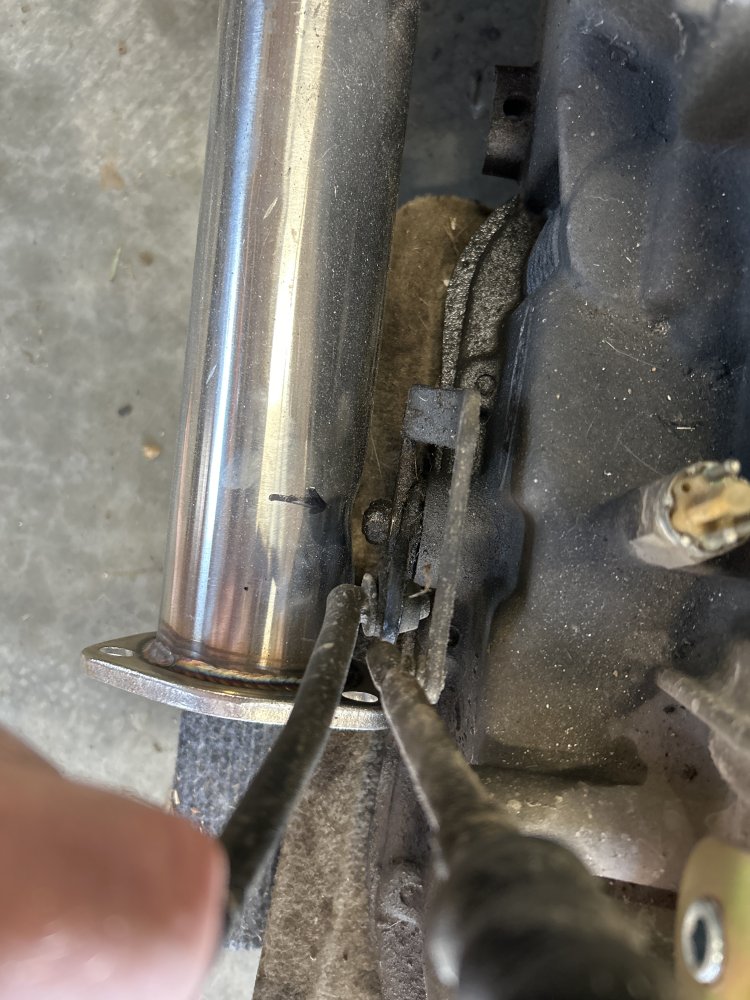

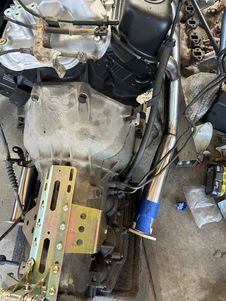

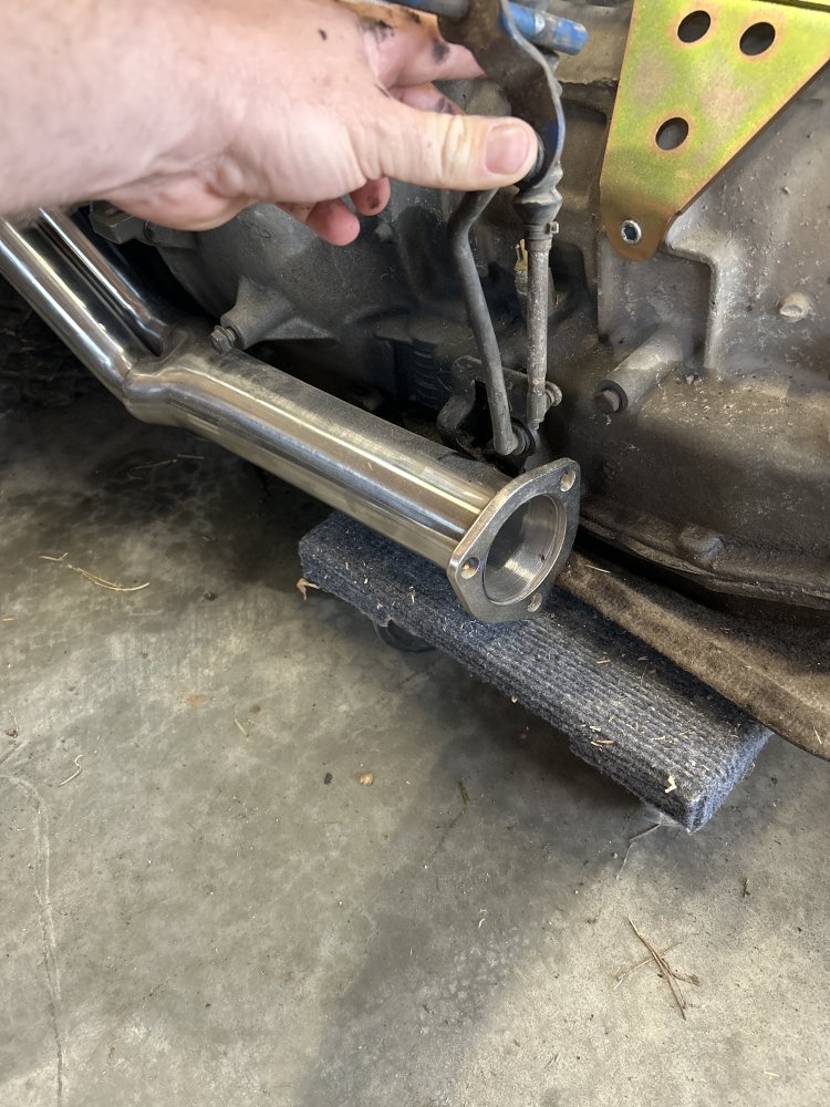

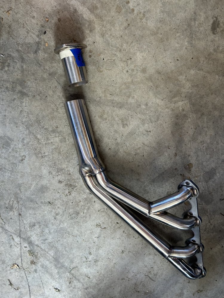

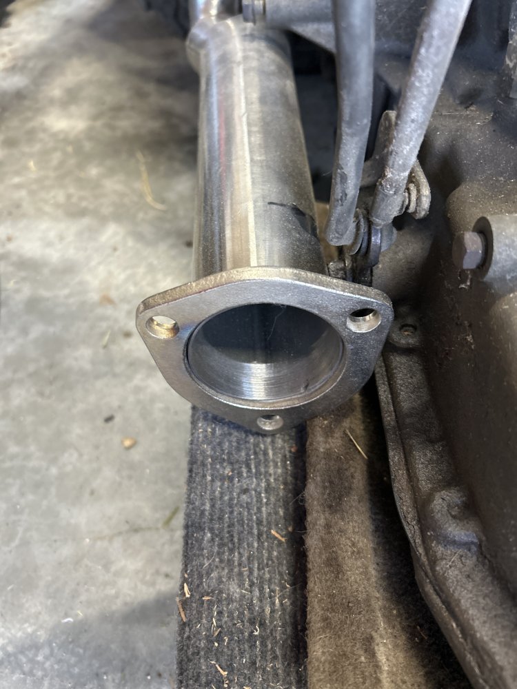

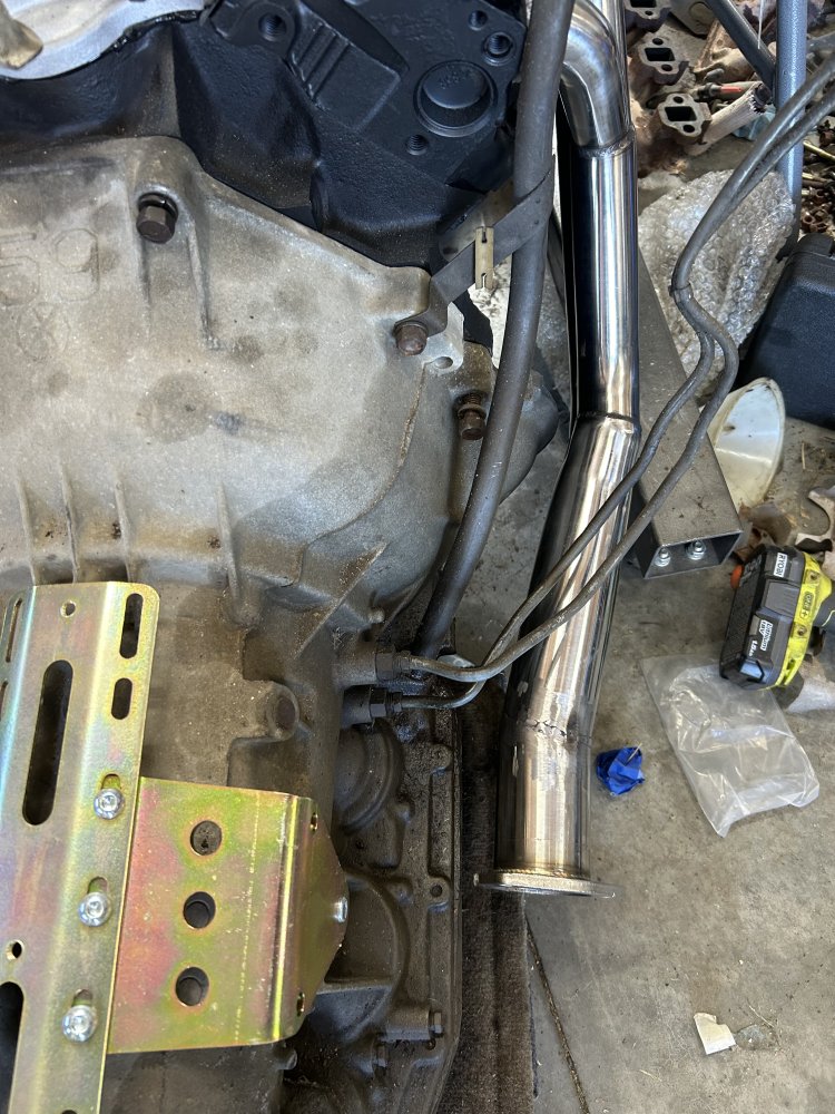

My welds arent near perfect but good enough for the life span of these $99 eBay stainless try-y headers for a 65-66 Mustang. I’m building a 351 AOD 2WD Sport Ranger and was hopeful the wider 351 would allow the headers to clear. It did not. Starter fits fine, the collector hit the transmission at the trans pan (passenger) and the header tube rubbed the (driver) gear selector shaft.
l had to slight dent the driver side were the AOD gear selector is. That was easy. Used a large impact socket and my vice. Passenger side had to be cut with a 4” angle grinder, pie cut, cleaned up and I welded it with Amazon flux core stainless on my 110v welder. I know haters gonna hate but that’s the only welder I’ve got and for the cost of the headers I’m not sending them out. I’m happy with the results.
Running GT40’s on stock rebuilt 351 and have an 8.8 w/ limited slip already installed in the Ranger with 3.73’s. V8 swap in a flare side 2002 2wd this summer. Posting for others who may do the same.

Who cares if the welds aren't perfect. No hate here.
Those look just like the set I got off eBay to put 351W/4R70W into my '73 F100. I bolted them to the engine on the stand and saw that they were probably going to interfere with the transmission. (I don't have the transmission to bolt up yet.) I was planning to heat up that header and try bending it out a little.
Please post photos of the drivers side - hoping to get clarity on how much interference there will be related to the front driveshaft. I know everyone says its impossible, but I would love to see photos of the driver side.

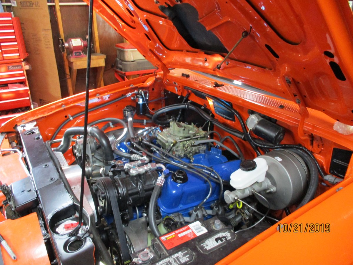

Depends how you define "fit". It took some fabrication but the 351 fits in my 93 just fine. The heater box was missing when I got it so I used a Vintage Air street rod HVAC system to keep the flat firewall. If he can modify those tri-y's, I'll bet
he can handle it.
