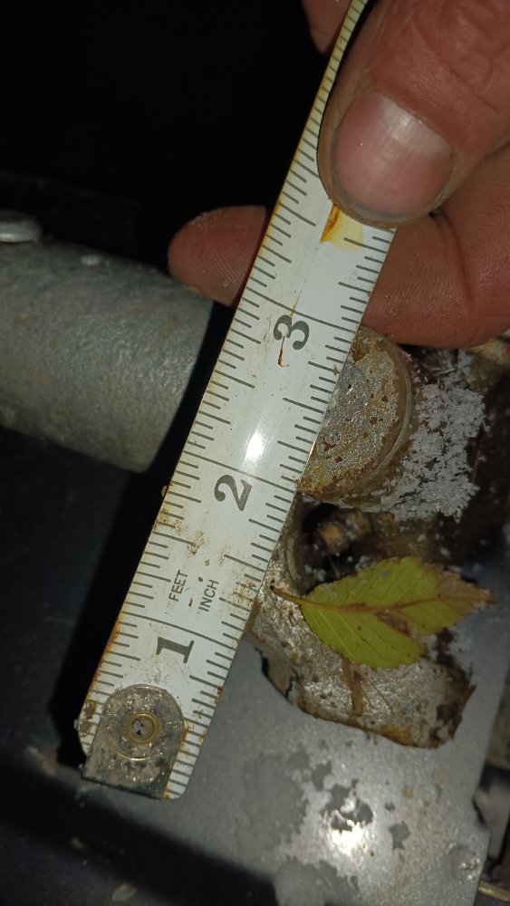

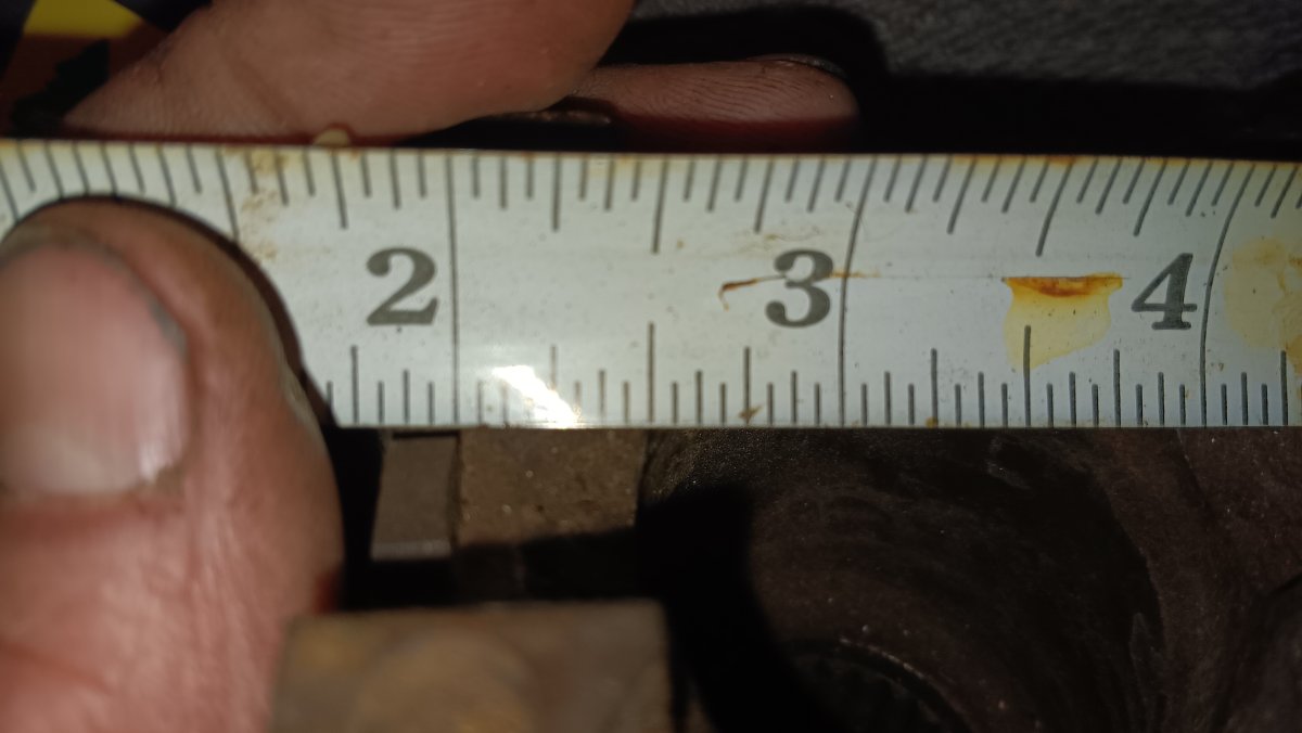

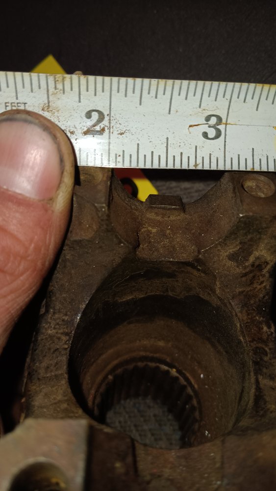

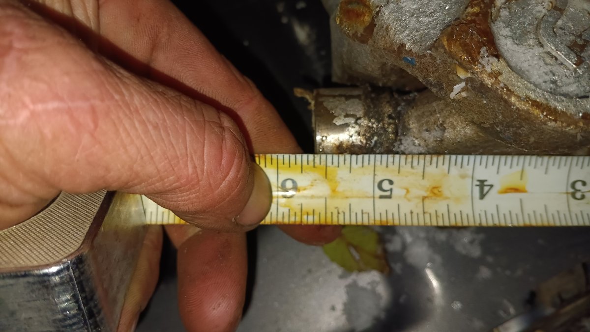

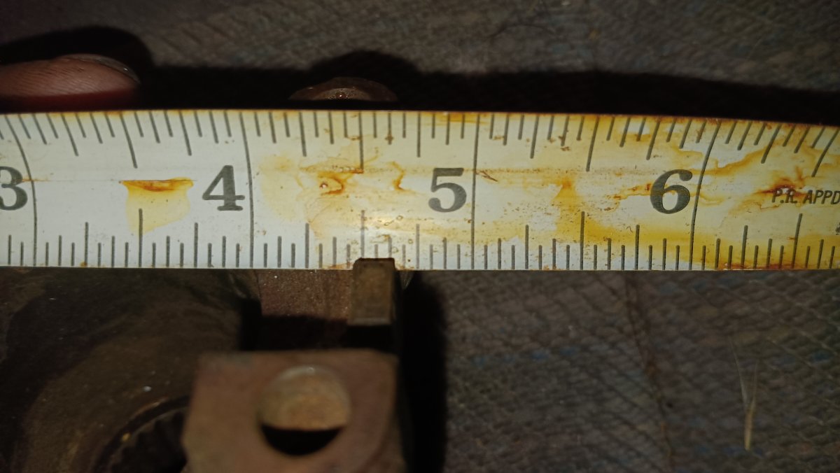

Hey Guys, sorry for the massive delay... Life kinda got in the way, things were misplaced... Anyhow, I'm back to trying to get this thing goin again, so here's some pictures of the drive shaft and yoke... I burned 2" in all the pictures for ease of taking an accurate measurement.

Hey, sorry bout the massive delay... Life happened and long story short I'm back to working on this thing again...
Anyhow, I burned 2" on all the pictures taken for ease of trying to take accurate measurements...
