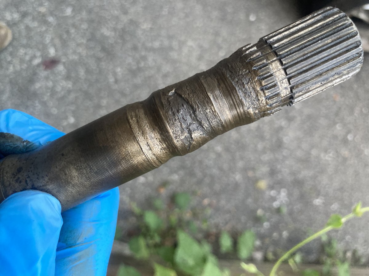

So after a scary incident where my drivers wheel flew off, I’ve gotten motivated and have opened up my wheels and spindles and removed the drivers and passengers axles, leaving just the yoke / small-axle / diff in place still. I’m going to replace what is needed.
The pic below is my drivers axle. Although the recent incident WAS this side, I doubt the condition of the axle end was caused by it. My lugs flew off while I was cruising at like 25-30 mph and my truck dropped a foot onto the rotor and I coasted on the rotor for 20-30 feet. I don’t see why this would put unusual pressure on the axle shaft inside the spindle. Both hubs were unlocked and the manual transfer case was not in 4x4. The rotor got chiseled and the hub fell off and was crushed by a passing car but that’s it.
Or maybe the angle somehow did this?

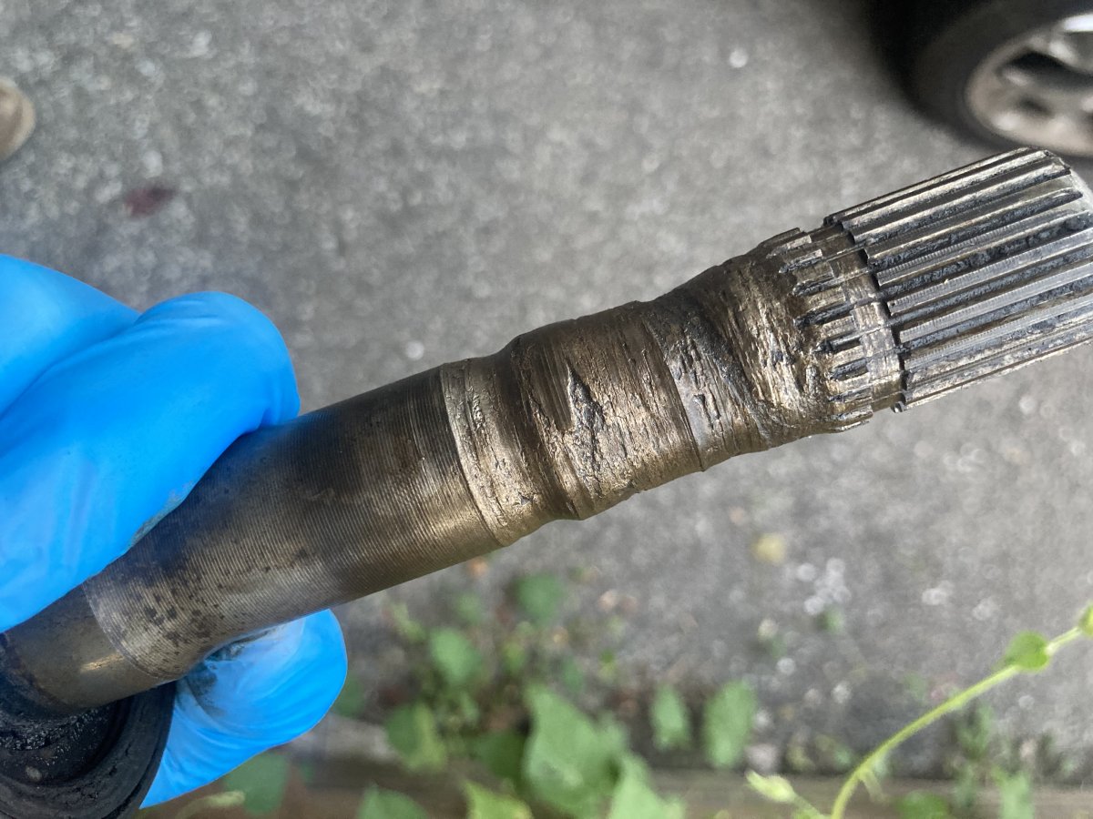

Anyways, I’m in the process of putting new U-Joints on the front, which is when I finally noticed this..
First two are drivers side, third is passenger.
What is this wear and tear from, if not this incident? Just extreme positioning while off-road 4 wheeling, causing this axle shaft to lean into the spindle a ton?
And do I need to replace it? I was about to order one but then realized the spindle covers the exact section that is damaged so that area of splines isn’t needed anyways. Obviously the small edge of the spindle lines up perfectly where the splines first disappear.

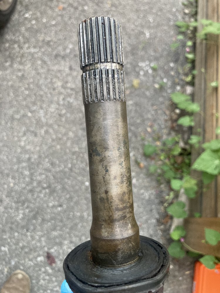

I’ve tried wiggling all of the U Joints in the truck and here are the only two results I’m a bit confused about…
This U joint seems fine, but I’m probably going to drop it all and change it anyways. It’s at the front diff, between the yoke and the short axle segment. But I’m concerned about the way the two piece assembly can be moved in and out of the diff like this. Is this normal? I know there’s a clip inside the diff that retains the shaft end. But should there be some play like this? The U joint itself isn’t budging, it’s just the shaft entering the diff in and out a little.

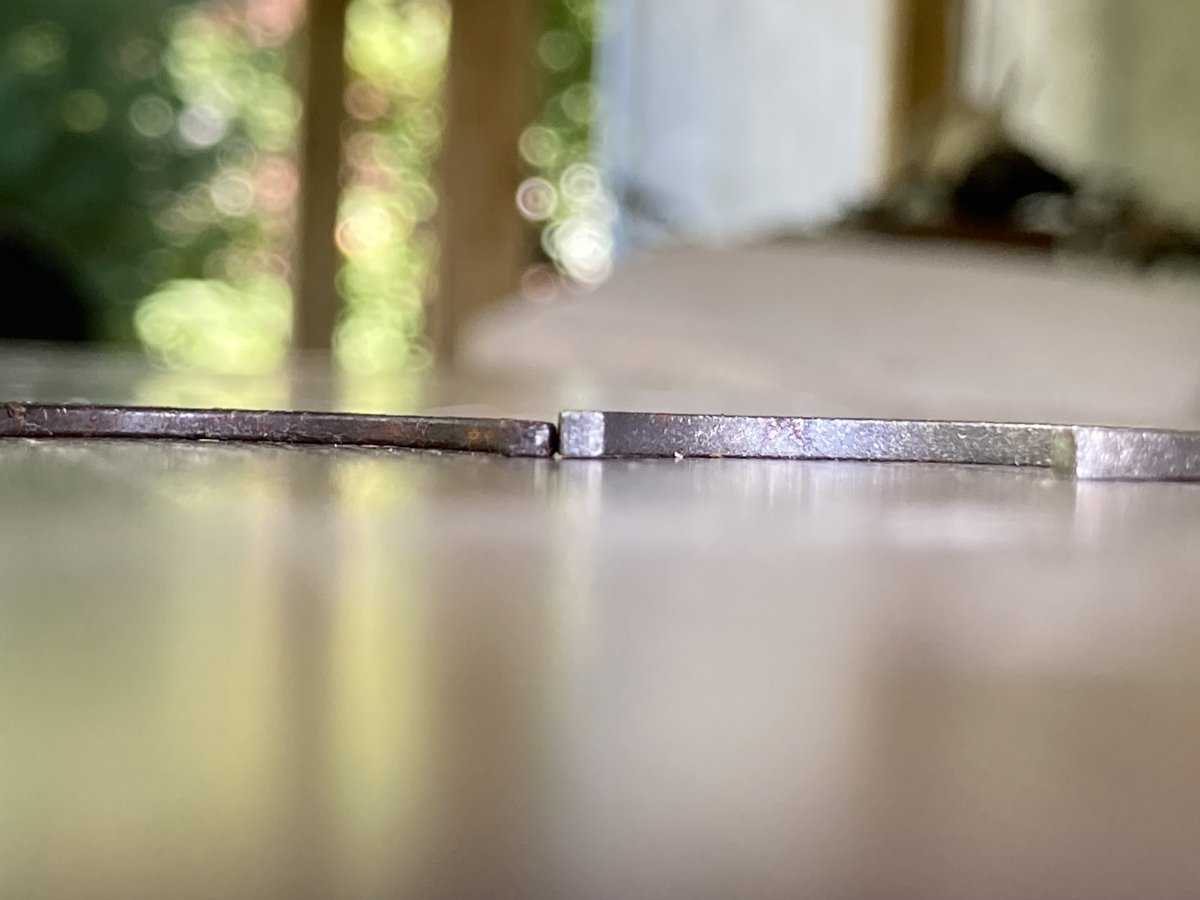

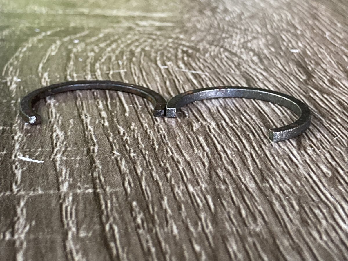

So i took a photo of the old clips and the new clips. And sure enough, there is a major difference in thickness. The new ones appear to be around 50% thicker than the old ones. That’s a pretty big deal. I would measure them accurately but my calipers finally just died yesterday.
Are these clips sold on their own? And to certain predetermined spec? And does anyone here know of any brand/model of them that is thinner than others?
I may need to go in person to an auto parts store and put some (new) calipers up to whatever ones they have, if they even have them for sale separately.
I would just reuse the old ones but some of them were brittle and broke to pieces, naturally!

Get the clips in and then smack the yoke ears with a hammer to release the tension. Before you pick on the clips for width the groove in the cap may be different to accommodate them.
That’s basically what my video shows. I smack the whole thing on the vice jaws. Easier to show than to describe accurately.
Sadly, I am really thinking that they couldn’t be budged back out at all, or shocked out by hammer tapping as mentioned. The snap rings just barely were able to squeeze in. I had to really work the second one in with a screwdriver and hammer tapping. So there was absolutely no leeway at all for either side of the joint to be backed out. Like the clips aren’t going to go “in” to the steel of the shaft ears, so i think the caps are as far out as they’ll ever go.
I am suspecting that the yoke ears in 1988/1989 were designed with current clip thicknesses in mind and somehow those thicknesses are no longer standard. Maybe some clips are even over engineered these days.
I may have to create some kind of jig and completely remove some of the surface of….. 24 clips. Ugh.
Or maybe these MOOG clips are just stupid thick?
