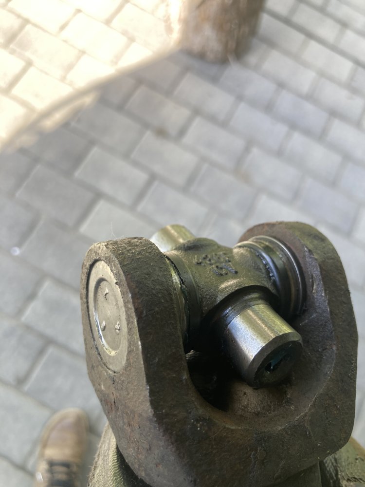

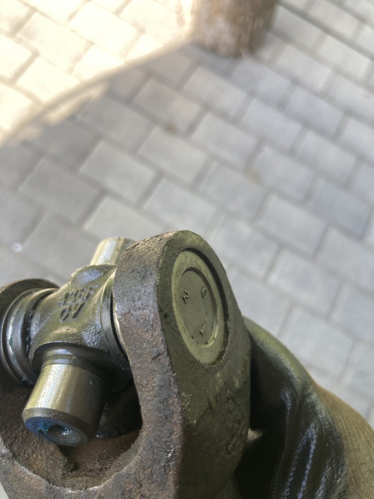

Ok so here’s a new u joint, different than the first.
And here’s now a third yoke I’m testing. This one is the slip yoke by front diff.
Again the same exact result.. I can just barely get the thicker clips in, and when I do, the u joint is nearly seized and almost requires a tool to rotate.
Also i took some pics of what the outside of caps look like. Note how much the caps need to be pressed in to make the thicker clips work.
They‘re not even, but I’m guessing the total extra distance is about equal to the thickness difference of the clips. It’s pretty significant, probably about 1/16” in total.
