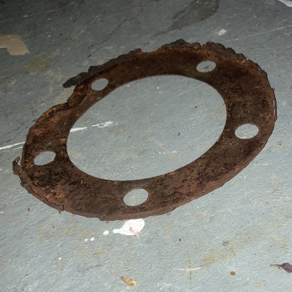

Spindle seats has me curious too. feels like another picture is in order...
It’s this piece of super thin metal. The other one has more of the lip remaining. I looked at enough videos and photos of other people doing the spindle / axle rebuild and nobody else I saw has it at all. And nobody mentions it. But it’s in the parts diagrams of the front hub system. That’s the only reason I know it’s called the spindle seat.
My theory is that it helps to prevent the spindle welding itself to the knuckle.
In any case, I didn’t want this mostly deteriorated thing sitting in my setup so I just omitted it.

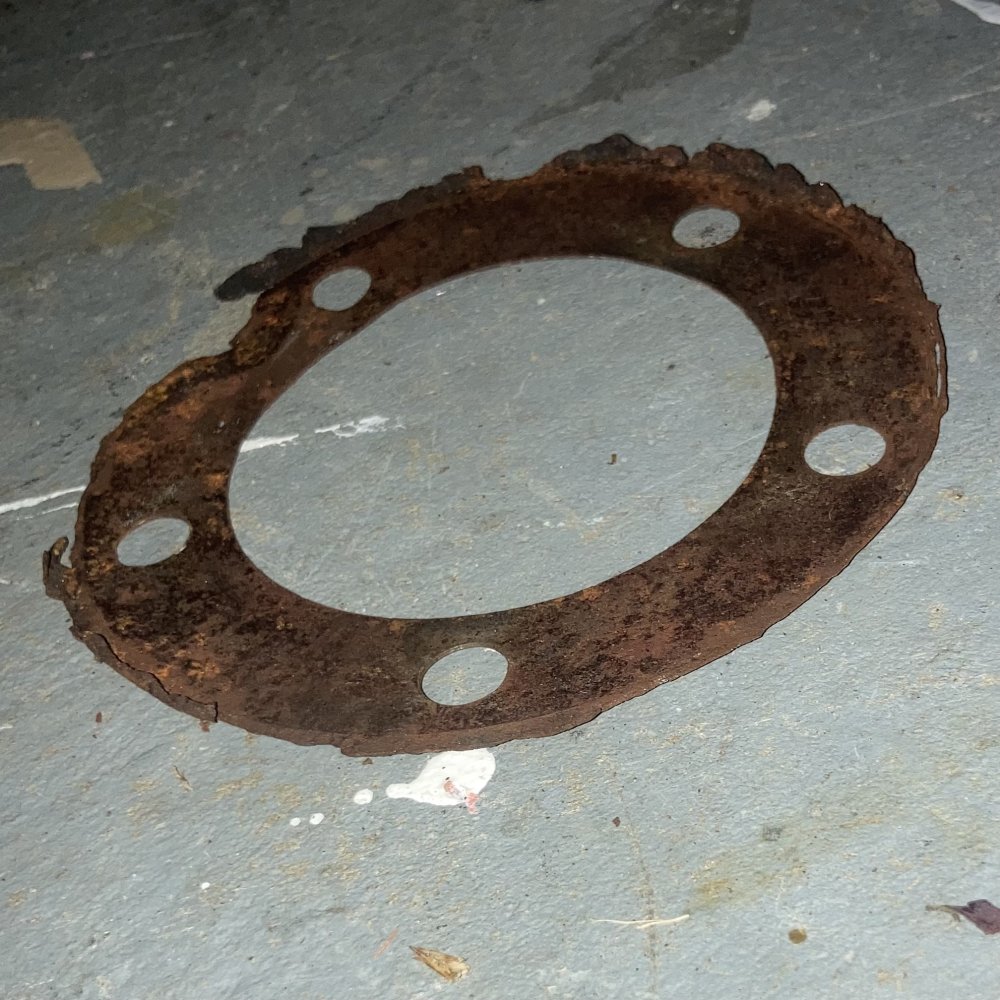

4x4 U-Joints and Axles : Wear Inspection and Replacement
You taught me something today. Perhaps mine are stuck to the spindle or knuckle and I just never noticed them.

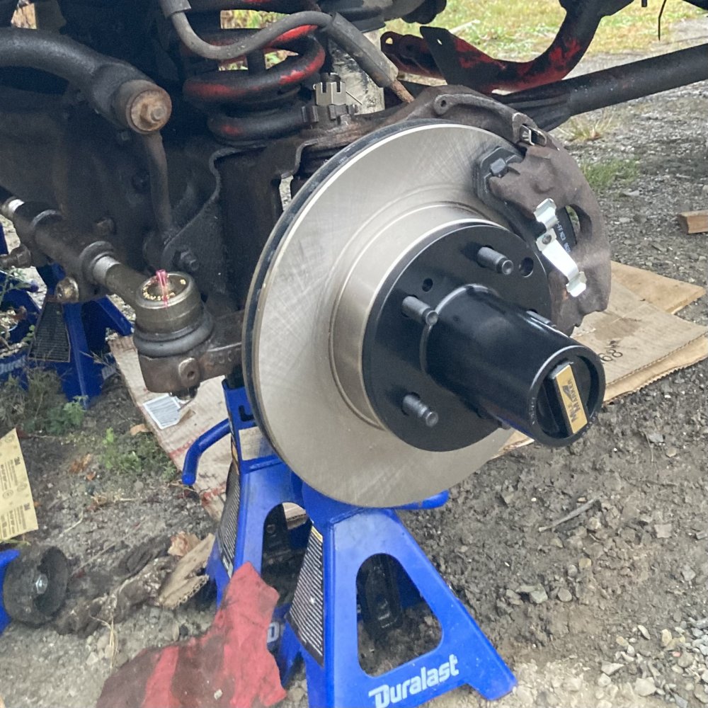

Obligatory pic below of some of the work finished, although this one doesn’t show the more difficult work such as the axle shafts and front differential. But you can still see the fresh tie / steering rods which is fun. New rotors and pads too, and new locking hubs.
I am leaving the front driveshaft out for now. I need to take more time with the u joints on that. This aLeo allows me some time to decide if I want to drill out the bracket holes in front diff and use U Bolt for the u joint instead of the little OEM clamps.

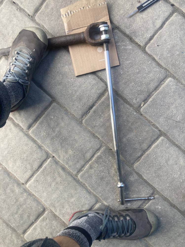

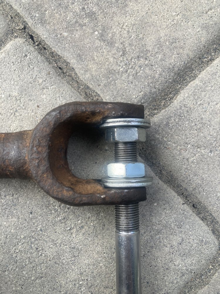

I also want to share a method I figured out for expanding a yoke if it is necessary. All of my yokes were pretty much dead on 41.3x millimeter wide, except for one that I hadn’t measured before and turns out was a little bit bent in to around 38mm wide. I had the idea becuse these parts were sitting right in the table in front of me, and I didn’t want to be banging on the yokes with a mini sledge. It’s jsut a classic expansion via nuts and threads. I happened to have these washers which seated perfectly into the flat sections inside yoke ears. This made the expansion a breeze. Took maybe a few quick attempts and it ended up spot on. Just keep the one nut clamped still and turn the other to press out. The only tricky part is keeping the shaft from rotating, but this is the shaft from a slide hammer so it conveniently had a horizontal piece at the top which i could step on to keep it from rotating.

Never seen that before, but I's good to know about. I think I'd have done the same thing in your case.
Spreading the yoke was the method I talked about in post #43, only with all thread, glad you made it work!
Oh i didn’t even remember that! Haha I really need to pay better attention sometimes :0
