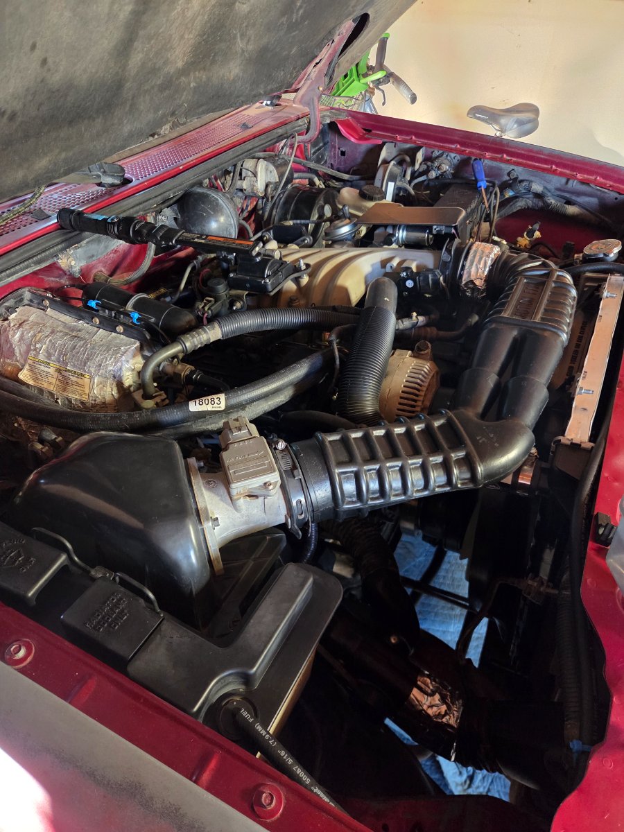

Got everything back together after a headgasket job and replacing mucho parts. I have crank but no start and I'm quite sure it's the timing/distributor/plugwire setup. I think I'm doing it right but probably not, I probably got it wrong somewhere, if anyone could help out with how to set it back to factory timing, thank you. Even my dog looked at it like, " yeah you aint got that set up right"🙏🙇‍♂️

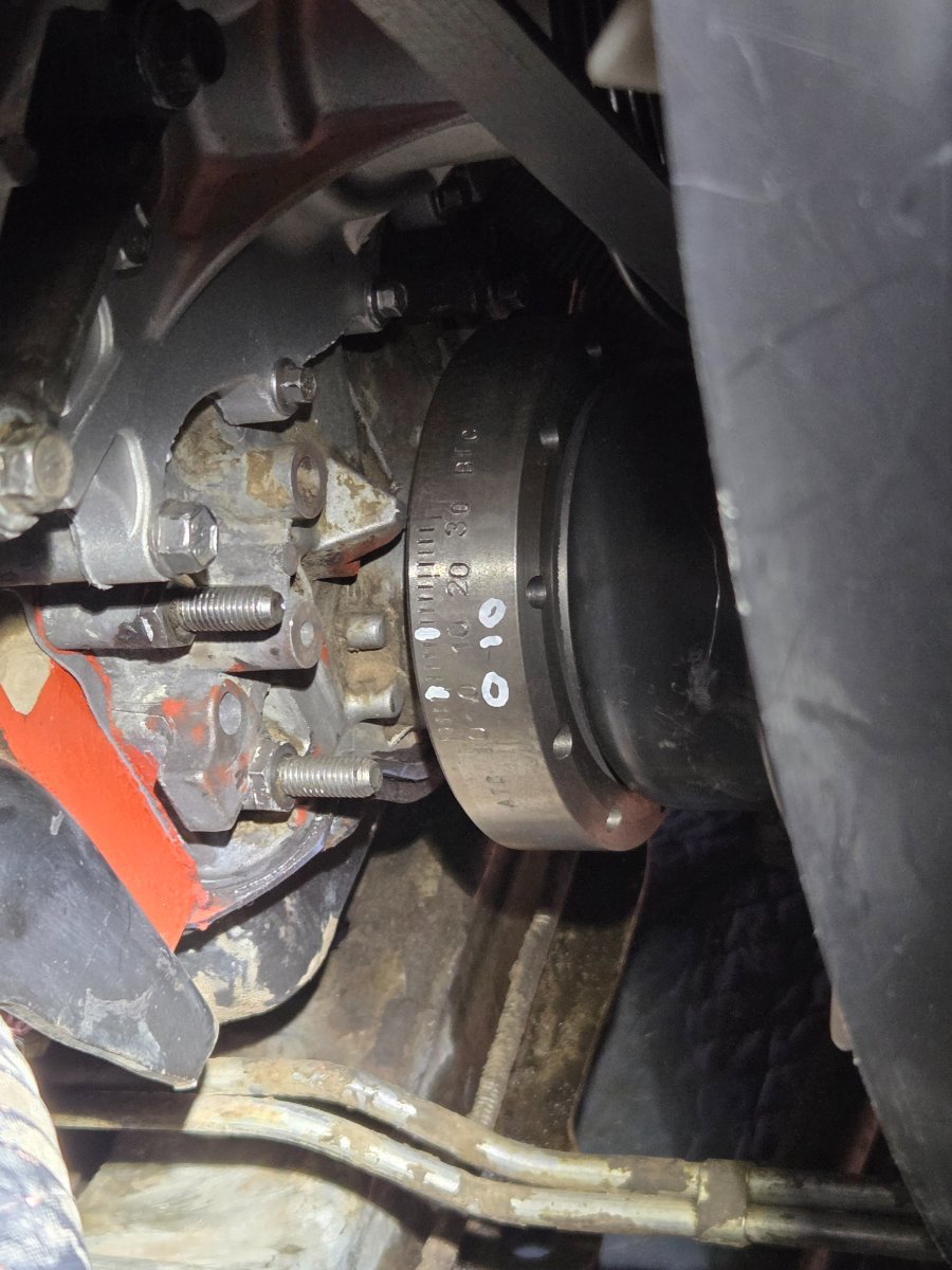

Just to verify, this would be the correct 10° mark? Also I did a compression test got about 125 on each cylinder

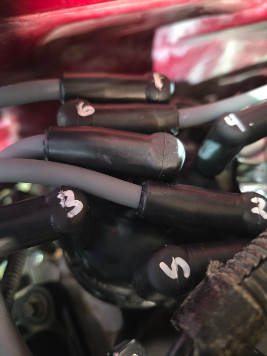

This is my distributor and degree on harmonic balancer at 10 btdc

Just to make sure...
#1 cylinder on ford 3.0L is the one farthest to the front passenger side. Cylinders are number 1 to 3 going front to back on passenger side. Drivers side are number 4 thru 6 front to back.
Normally I like to have the #1 sparkplug wire on the cap oriented pointing to the # 1 cylinder on the engines I've worked on. Not sure about the 3.0L.
Your cap wiring looks correct order. And it doesn't really matter where the #1 cap wire is as long as there is enough movement to put the timing at 10°.
