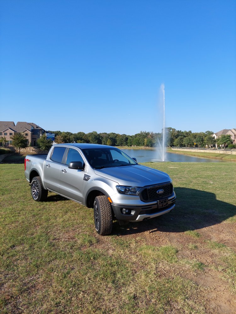

Around 1992 I built up a 1983 Ford Ranger 4x4 as my first Ranger. This Ranger was nicknamed TRS-1. In 2004 I built up a 1996 Ford Ranger 4x4 as my second Ranger that became known as TRS-2. For several years people have asked if there would be a TRS-3.
In 2019 Ford loaned me a 2019 Ford Ranger FX-4 for 6-months to celebrate the return of the Ford Ranger to North America and The Ranger Station's 20th anniversary. I also used it to complete the Trans America Trail (TAT). That Ranger was nicknamed the 'Loan Ranger' but never received a TRS numbed since I didn't own it.
In September 2022 I traded my 2016 Ford F-150 for a silver 2021 Ford Ranger FX4. I got silver to celebrate The Ranger Station's 25th anniversary in 2024. The Ranger will be nicknamed 'TRS-3 The Vagabond'.
This vehicle will be built for the following purposes:
Daily driver
Adventure / survival / overland vehicle
The Ranger Station promotion vehicle
25th anniversary vehicle
Product test & demo vehicle
PROPOSED MODIFICATIONS:
3.5 suspension lift
33-inch or equivalent all-terrain tires
Rock sliders
Custom heavy duty wich bumper
9,500lb winch
Custom heavy duty rear bumper
Bed rack with roof top tent
12-volt fridge / cooler
LED off-road lights
GMRS radio
CB radio
Bed storage
Tremor upfitter switches
Leather seat covers
TRS livery graphics
UPDATES:
10/20/2022 -
Skyjacker Suspension will be sponsoring this build with one of their 3.5-inch suspension kits keeping the TRS Rangers on a Skyjacker Suspension.
Current:
2021 Ford Ranger FX4 TRS-3 Project Build
  • Skyjacker 3.5-inch lift (sponsor)
  • Thunderer Trac Grip MT Tires 2T295/70/17 (sponsor)
  • ProComp Series 41 wheels
  • Nilight LED hradlights
  • Nilight LED offroad lights
  • Custom grill guard & winch mount
  • Smittybilt 9.5k winch
  • DeeZee tailgate assist
  • Redarc trailer brake controller
  • Midland GMRS
  • Bed rack with adventure basket
