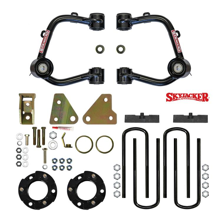

I looked at Skyjacker's stuff and it seems to be all strut spacers, UCA's, and lift blocks.
Camburg has some nice looking kits but they're hella expensive.
BDS ain't cheap either but you seem to get more for your money.
The Ford Performance system, which I think is made by Fox, lot of people like it, does come with whole struts with springs, price isn't terrible, 2.5" front lift, but does not come with new UCA's. My experience with the 2.5" front strut lift on my old Sport Trac with stock UCA's was that the upper ball joints would last about a year and a half. The 1.25" rear strut lift never gave me any problems.
My opinion, you don't need to get crazy with lifts unless you want 35" or larger tires because the rear is already pretty high.

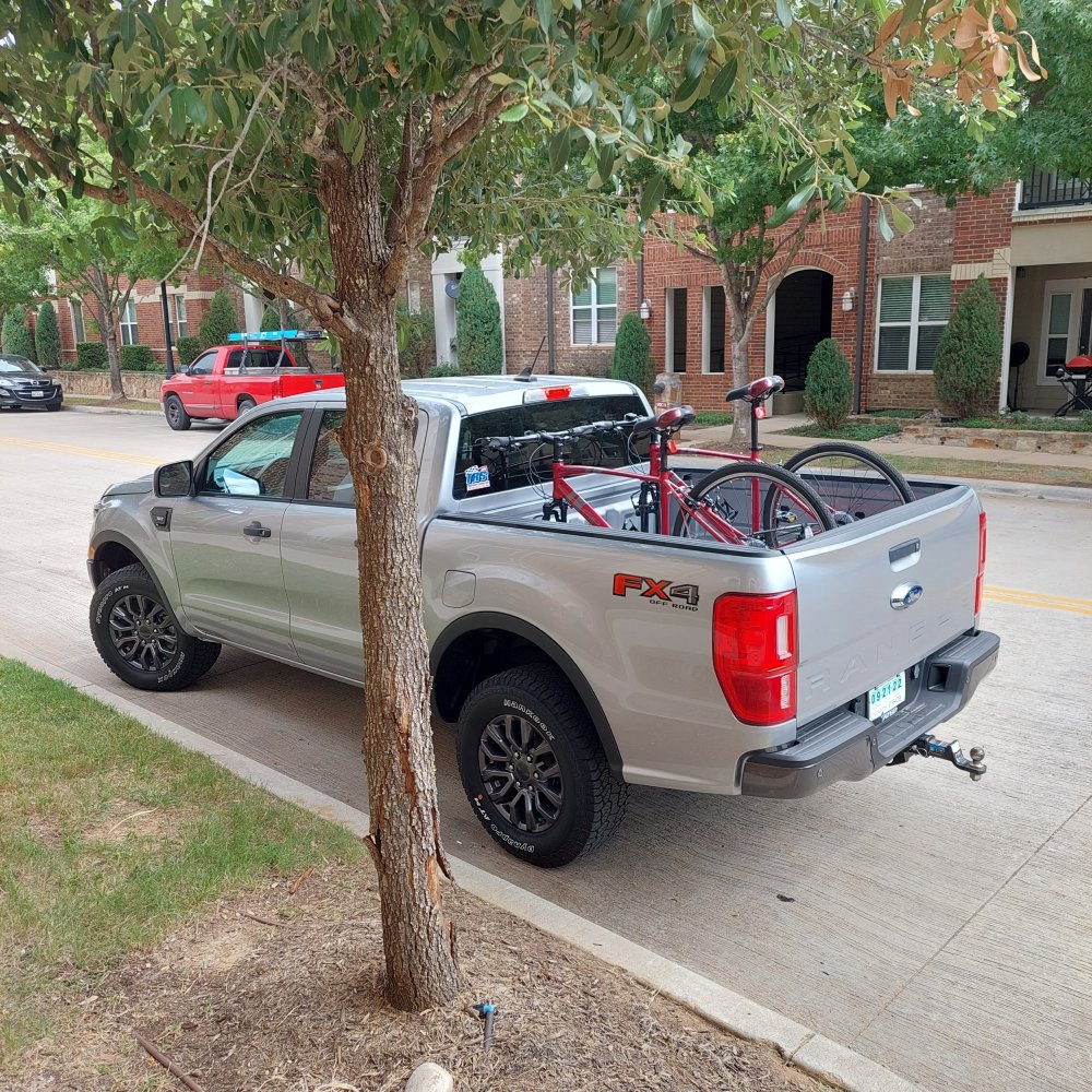

I haven't done any mods to the Ranger yet, but I did mount our bikes in there so we could go ride them.

I have been running the same Skyjacker Class II 6-Inch suspension kit under the TRS-2 Ford Ranger for 18-years. I contacted Skyjacker to see if we could work together to keep Skyjacker Suspension under my (new) Ranger.
I'm excited to announce that I was informed tonight that they will be sponsoring this build with one of their 3.5-inch suspension kits along with a banner to hang in the TRS Garage! :yahoo:

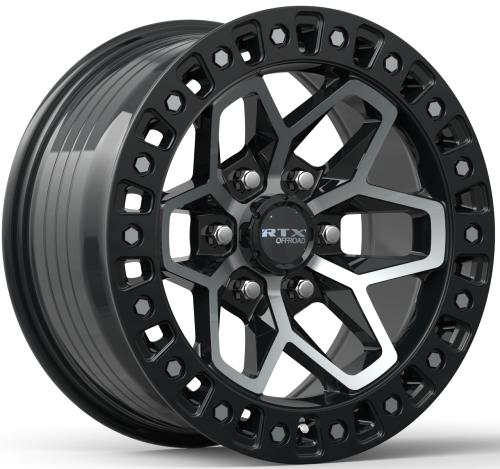

I really like the looks of this RTX Offroad Zion 17x9 wheel. It has 0mm offset and a 106.1mm center bore.

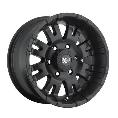

I've been watching sales/rebates on wheels and tires. 4WP is clearancing a bunch of ProComp wheels recently. These are $83 right now...
