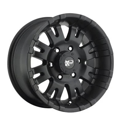

I've been watching sales/rebates on wheels and tires. 4WP is clearancing a bunch of ProComp wheels recently. These are $83 right now...
Right bolt pattern but in 16 inch. Not sure what the wheel to brake clearances are like on these newer Rangers. A 17 inch wheel might be a must.
Maybe offer a bit of real estate on TRS-3 for a couple big yellow 4WP stickers as some ad space. Maybe even their own forum in the vendor section if they help shorten your shopping list.
The base XL comes with 16s, so they might fit.
