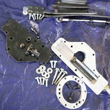

It is not the transmission that needs to be changed, it is the extension housing that has the mounting holes for the shifter linkage. If you find a transmission with the correct extension housing that is good. That is probably easier to do than finding the correct extension housing by itself.
There is a way to modify the electronic shift extension housing to be able to mount the linkage. There is an article in the TRS Tech Library that gives a not so detailed way to do it. Then you have to find the shifter linkage and manual transfer case. The best bet for a newer setup is the 2002 FX4 or the 2003 FX4 Levell II with the manual transmission. There were not a lot of them made but as they get older it may be easier to find one in a salvage yard. Probably not a good source on Mexico.
is this the article?
Behemoth Drivetrain sill has the Borg Warner Electric to Manual Shift Conversion Kit in stock for $995.
the videos and photos are very helpful.
