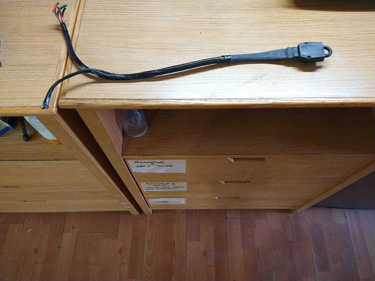

I appreciate the information! I finally got it fixed this morning. I put a bounty on the internet and someone who worked at Harley came over and fixed it in 30 seconds....lol. I had this thing under the dash wired into the ignition for something and it was going faulty....this guy bypassed it and re wired it factory with the diagram and said that this thing was not factory and installed before I bought the truck. Whatever he did it works like a champion now starts like new......Thanks for the help! Just puzzles....in which I dont always see the pieces.

No mod is the best mod. I bought my Ranger with a second horn you can trigger with you left foot -- yank it out right after I got home.
