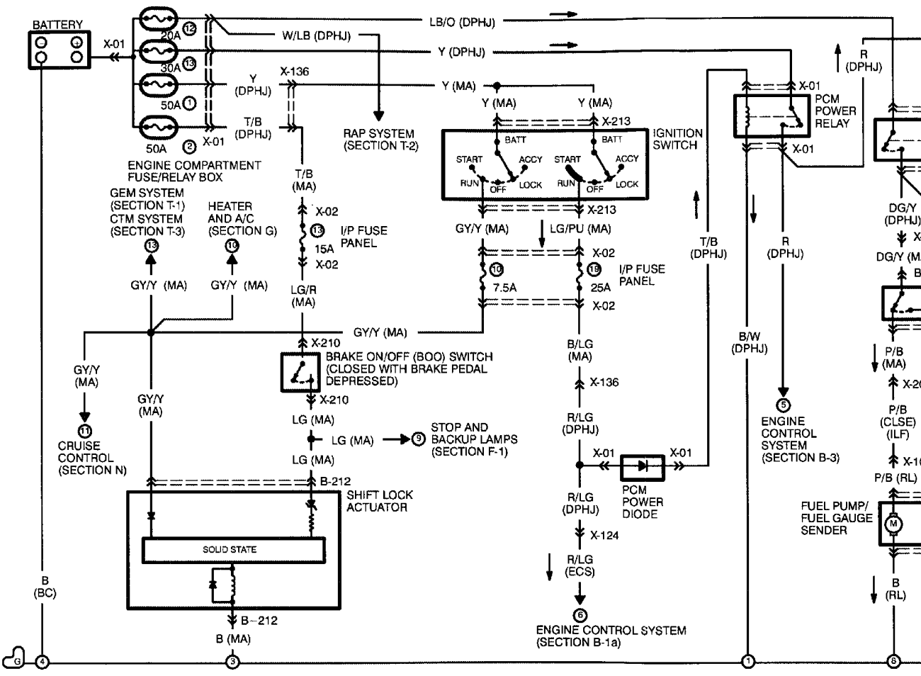

Is your PCM power relay clicking and passing power?

Look in the socket where the relay plugs in and make sure it's in good shape. The PCM power relay is where it all starts, and it sends power to all the 12v stuff for the computer and also power for the computer.
I haven't looked at the diagrams too closely for this model, but I know some models will not communicate with the computer if the cigarette lighter fuse is blown.

After overlooking everything for the umpteenth time, I found that a PCM MAXI fuse was blown and for some reason I am missing another MAXI 50 amp fuse that goes to my ignition when it was clearly there before since I haven't had any issues with the ignition system yet.
