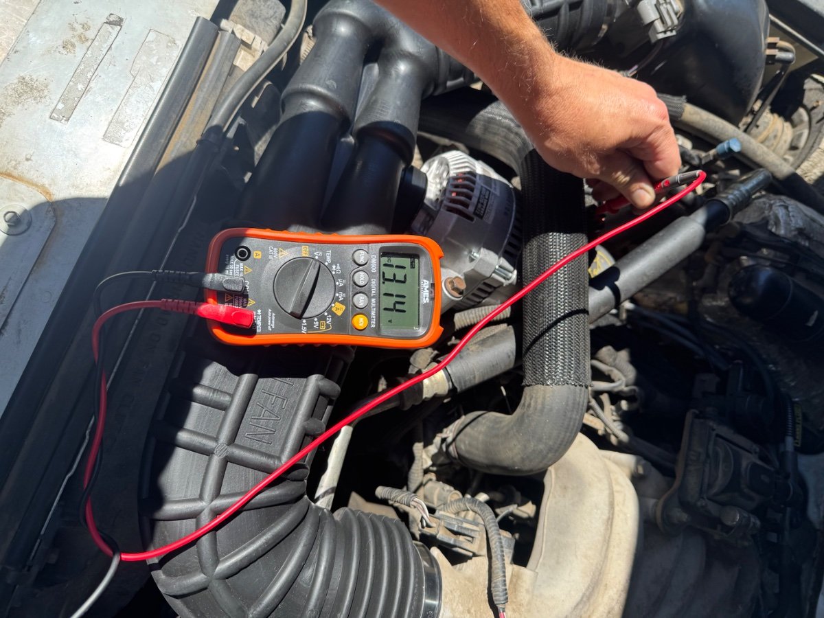

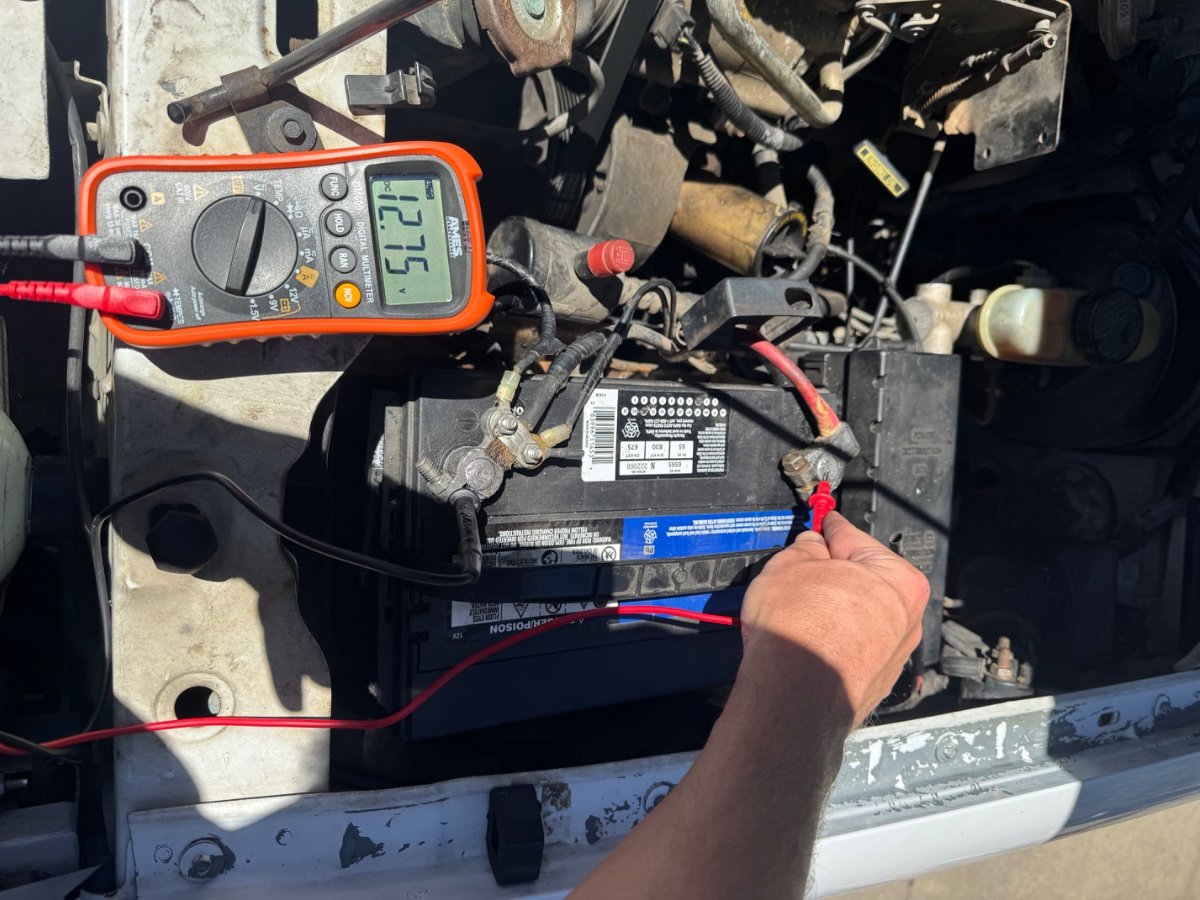

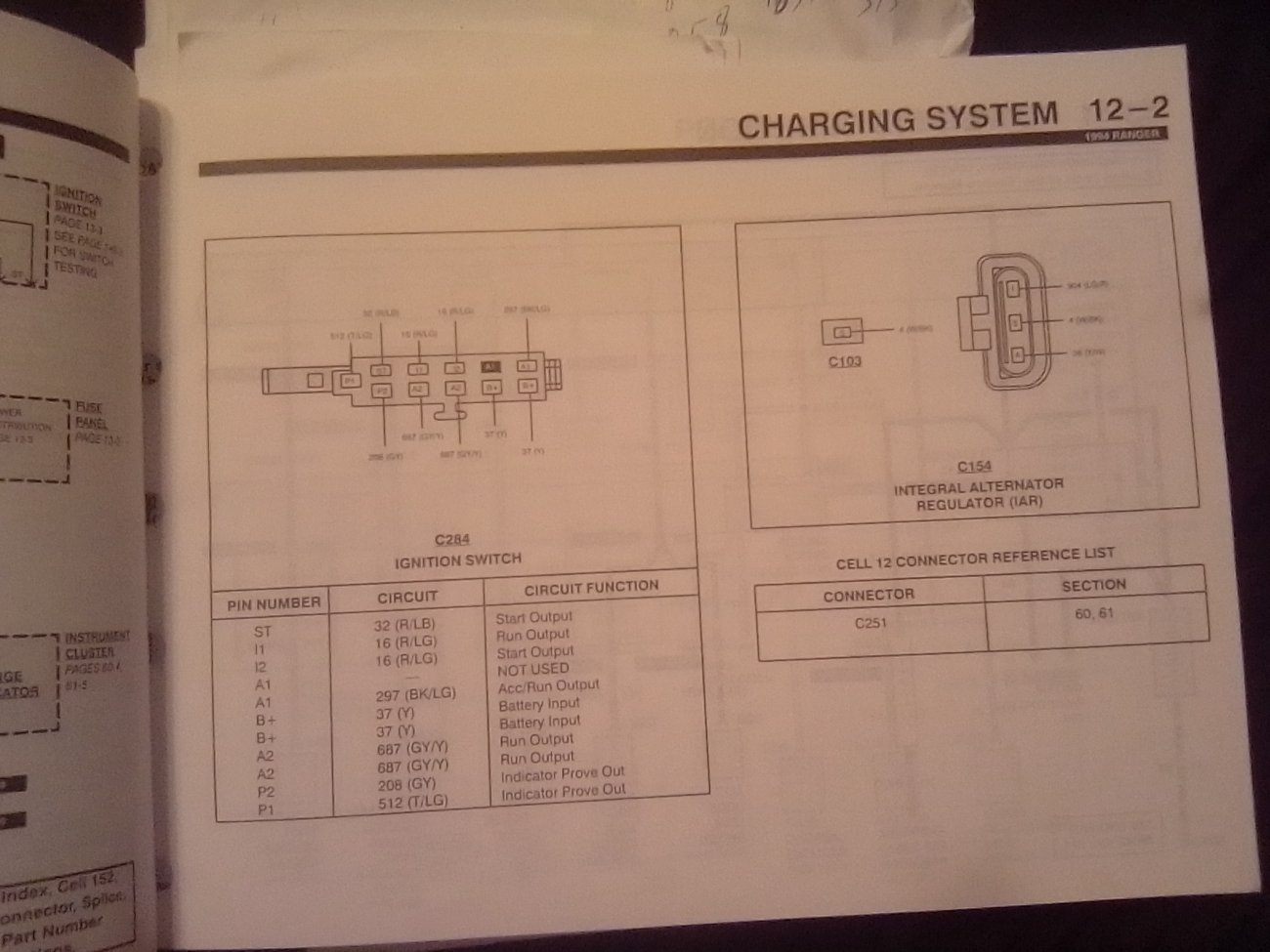

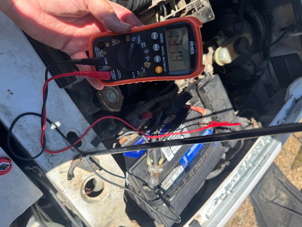

Got a 1994 Ranger on a trade. Battery will not charge from the alternator. Figured the quick fix would replace the alternator, still not charging. figured maybe the new alternator was bad. So put another one in. Still nothing.
I just tested the yellow/white striped wire with car off. 13v. So this is telling me that the circuit is complete because the battery is reading 13v and so is it at the alternator yellow/white striped is also reading 13v. Wouldn’t this tell me that the wiring has no short or corrosion? When starting the car it goes into the 12v range same at the yellow/white striped. When I plug it in, no jump in volts at the battery. What I’m I missing here?

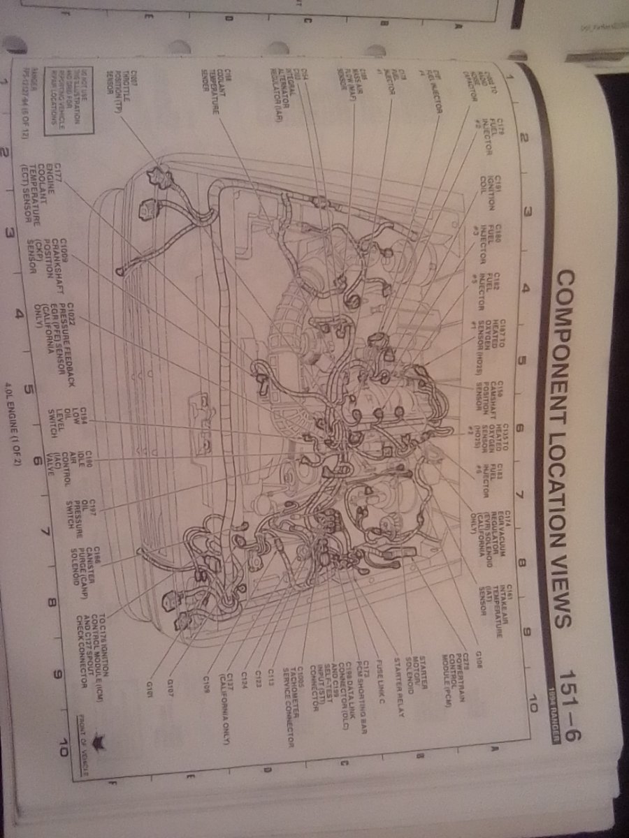

However my EVTM says it should be bolted to the driver side frame rail.
If I'm reading it right.
1994 Ranger 3.0 alternator stumped
Look at G107.
I believe that's the ground wire or negative wire from your battery however you want to say it.
If I'm reading it right.View attachment 132638
Look at G107.

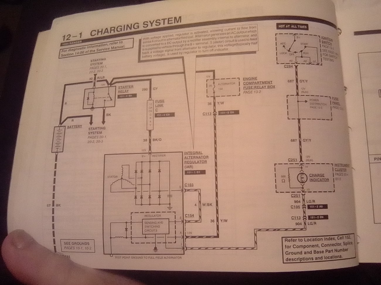

This post helped. I was able to track down the fault wire

The B+ wire was not reading the same Volts as the battery. That indicated something was wrong with the B+ wiring. Following the line to the Fusable Link, it was toast. Ordered a new 12g fusable link and it fixed the problem—learning pains. Probably didn't need the new alternator.
