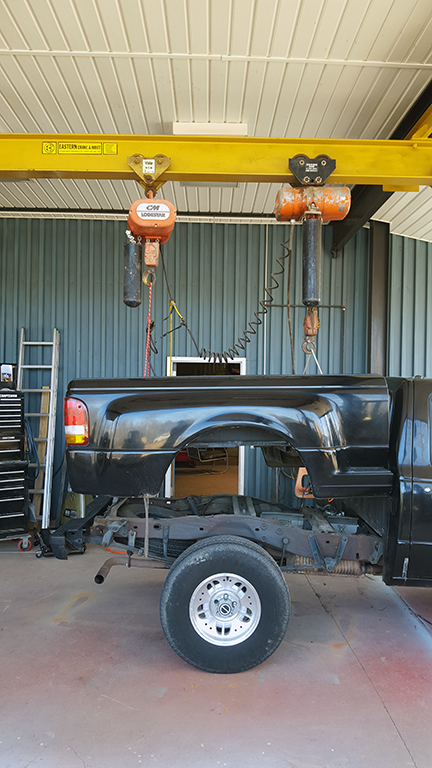

It looks like I will take the bed off this weekend to replace the fuel filler pipe. While I'm doing that, I will also install a new fuel pump and strainer and gasket around the mouth of that opening. A new fuel filter is also on the list. All parts are on hand.
I also plan on cleaning the top of the frame rails and spraying a coat of paint on them and removing the spare tire bracket. That space will eventually be used to hold an air tank for my compressor.
I replaced the fuel filler pipe, fuel pump, fuel pump strainer and fuel filter yesterday. Not a bad project.

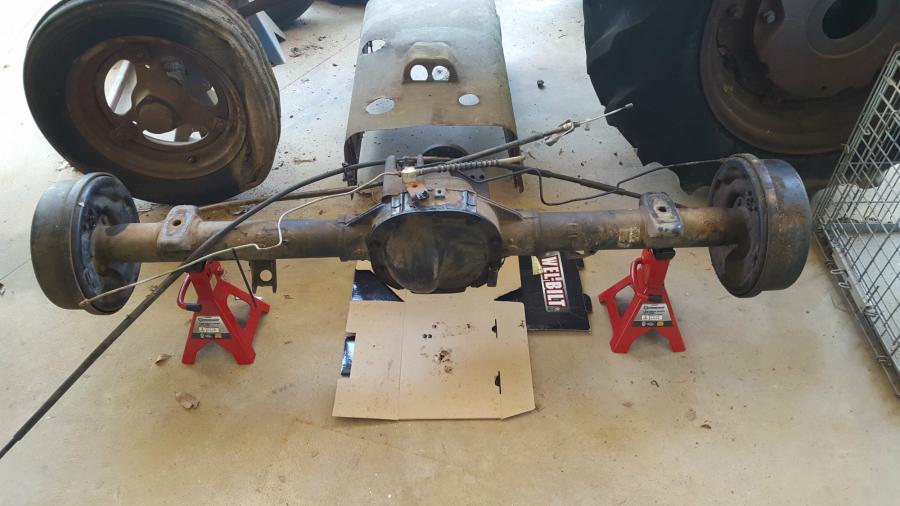

I got a used 8.8" rear end yesterday. It came from an '02 ranger FX4, So my understanding is that this should be the stronger 31 spline version. The original LS carrier (V305A?) had failed and the owner got a non-LS carrier installed but while that was being done, he got another used rear end for his truck. So this one sat waiting for a home. He drained it and had the cover bolts loose so I could see the inside before purchase. Looked good to me. For $150, I'm pretty happy.
What are the best 4.56 gears I should buy?
What is the best value in a lunchbox locker?
What else should I do before installation, besides new wheel cylinders?
Should I weld the tubes to the center? If so, do I need to be careful about heating it unevenly and warping it?
