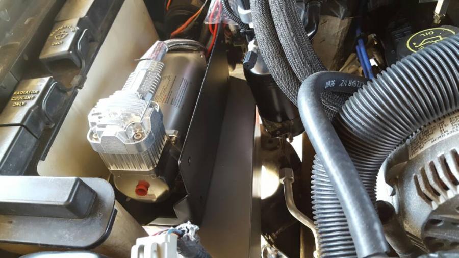

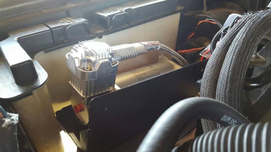

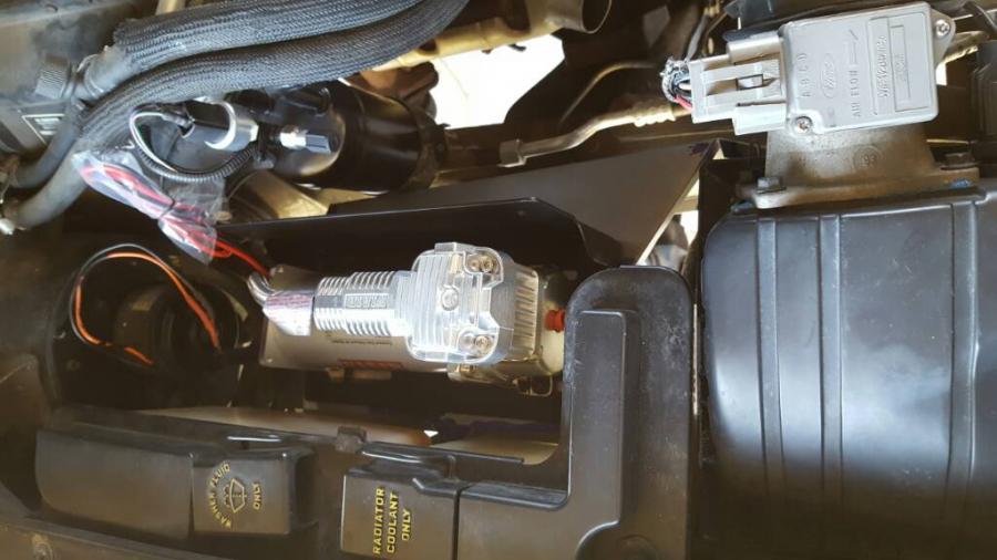

Yesterday was a good day. I made a shelf in the engine bay and got my air compressor mounted. I still have to remove it one more time to paint it. The plumbing and wiring should be easy.
I think my air tank might get hung from the rear cross-member using the space where the spare tire used to be.1993 Splash in SC1993 Splash in SC1993 Splash in SC

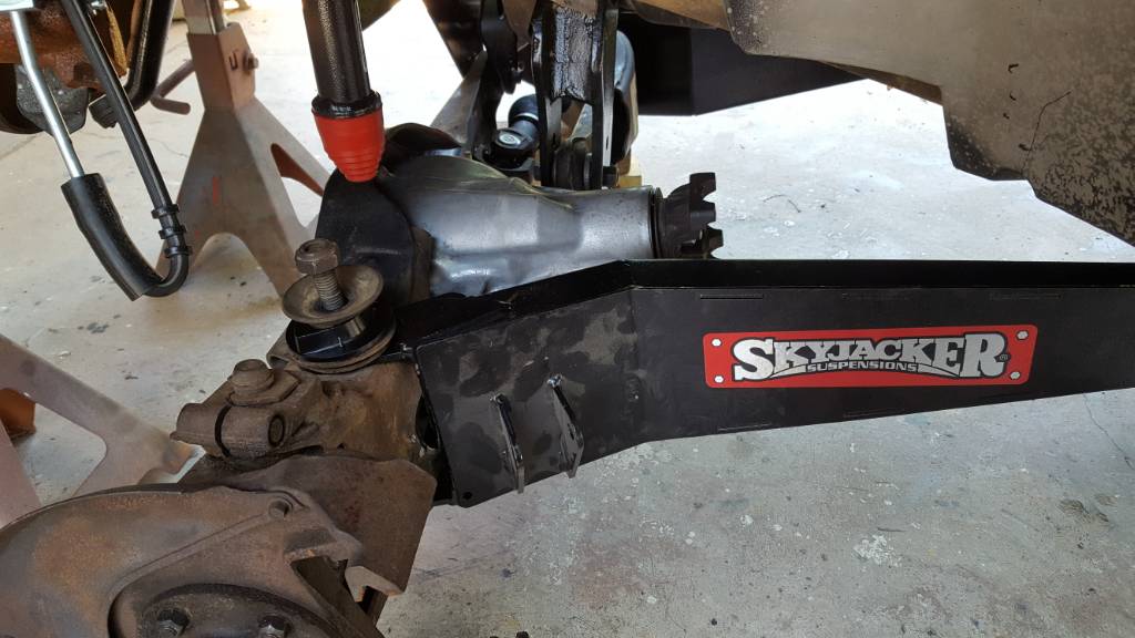

It feels good to make progress. I got the front axle assembled and mounted under the truck today. I had to do a bunch of grinding on the back side of the driver side beam. There is a lip that sticks out and interferes with the new radius arm. Once you grind enough of that lip off, everything fits nicely. Here's a picture from the drivers side. Also, below, is a picture of the weed eater spring c-clip eliminater in case anyone needs to see how that installs. After the photo, I slopped it up with grease and put the boot back on.
