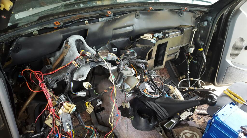

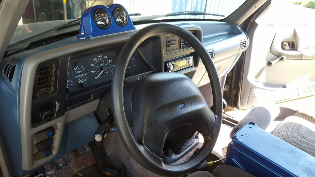

Thus weekend, I put in my "new/used" dash. That gave me the opportunity to replace the heater/A/C controls that had a broken cable connection pin. I also cleaned up all the wiring I have added and routed it with the factory looms. It was a good time for general cleaning.
Just a few details left. I'll post photos in a day or two.
Sent from my SM-G920V using Tapatalk
In case anyone wants to see what it looks like behind the dash, here it is, followed by the finished job. It's much better than before.

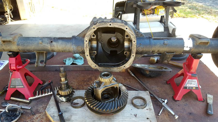

The fun has begun! I started rebuilding my new rear axle the other day. It seems like projects like this go much faster in my head. It took quite a while to get everything cleaned up. The PO had a bad brake cylinder and bad axle seal on one side. So everything was really gooped up. Lots of sludge in the axle tubes, too. I'm wrestling with adjusting carrier shims. the new gears weren't happy at all with the original shims.

This looks like it is going to be a well thought out build. Keep up the good work.

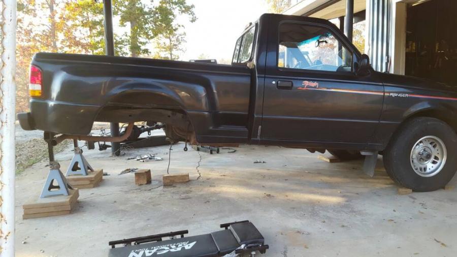

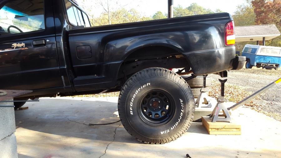

Finally got the rear axle ready. Today I started the rear part of the lift kit install.
1993 Splash in SC

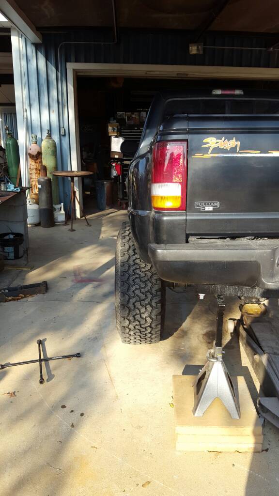

I slid the axle under it today and found out that the F150 U-bolts I got at the junk yard are too short. I also found out that the brake lines that I got with the 8.8" axle would not work. Between damaged places and wrong size nuts, neither those or the brake lines from my 7.5" could be used reliably. So I went to Advance and got brake lines to install. I then went to a spring shop and had new U-bolts made. Got home, bolted the axle up to the new springs and shocks. Then I got impatient and wanted to see how the new tires are going to look. So I stuck them on. Photo below with truck sitting on new 35" tires and 6" lift. Front is still stock.
I also have found that the driver side shackle and shackle bolt are really worn. The hangar is fine. So, new shackles and bolts will get ordered.
That's all I felt like doing today. I live near Greenville, SC and we are getting a good bit of smoke from the wildfires in western north and south carolinas. Headache and sinus problems all day. I hope everyone out there is safe.

I think the width is going to look good.

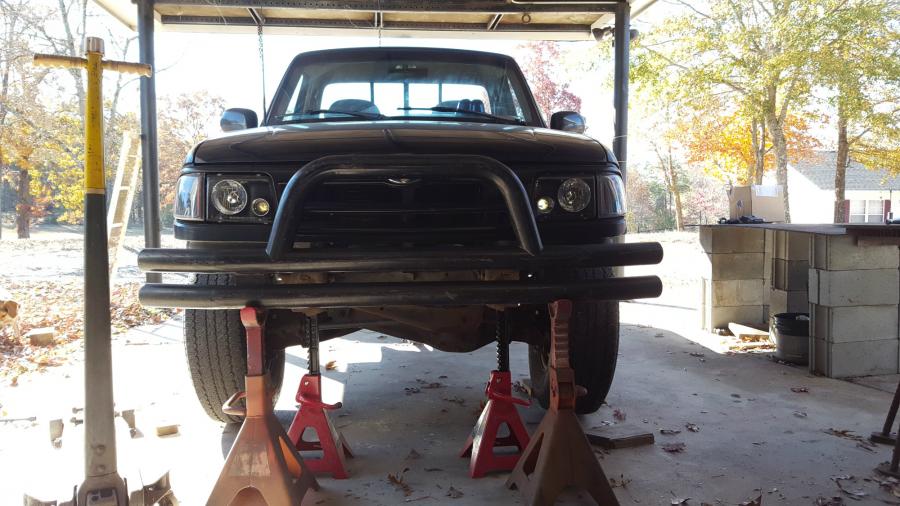

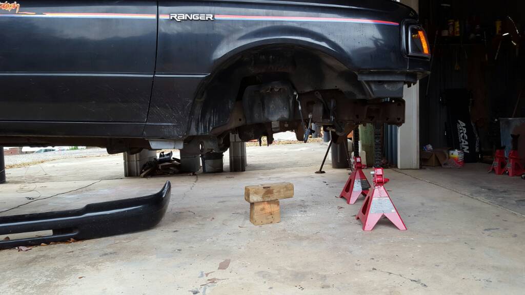

I have the front end almost completely torn out now for lift kit installation and differential rebuild/modify.
I also knew that the OEM wrap-around front bumper would not work well with 35" tires. So building a bumper has been on my list. Well, I found a good starting point on Craigslist the other day. I got this bumper for $50. The guy bought it to put on a Jeep, but decided not to use it. All I have to do is cut it to width, make a couple brackets and maybe reinforce it a bit in the middle since I want to put a receiver hitch under it. I would have spent more than $50 just buying steel to scratch-build a bumper.

Looks pretty lonely under there.
