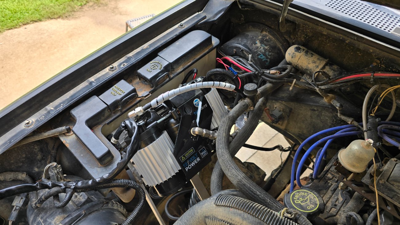

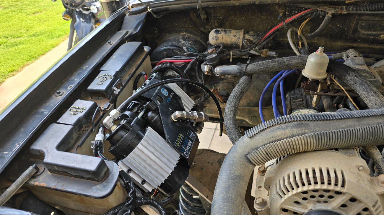

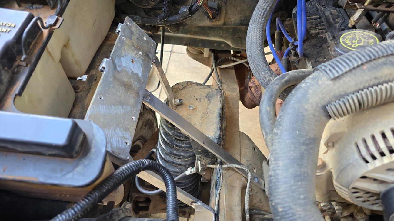

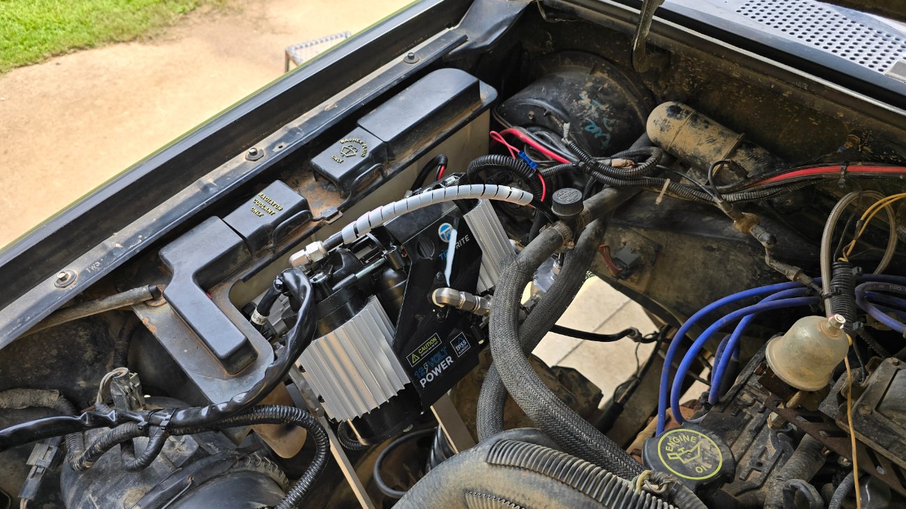

Started replacing my air compressor today. I got the new bracket built, installed the compressor and did 90% of the plumbing. I need to make a tee fitting for the inlet hoses ((1) 1/2" port x (2) 3/8" ports). Connect the wiring and make a new splash gaurd to go between the compressor and the wheel area to keep mud and water away. Routed the inlet hose into the cab with a nice little filter on the end where the old one had been.
New bracket mounts to frame. The old compressor/bracket mounted to the inner fender and was flimsy.
1993 Splash in SC
new compressor in place

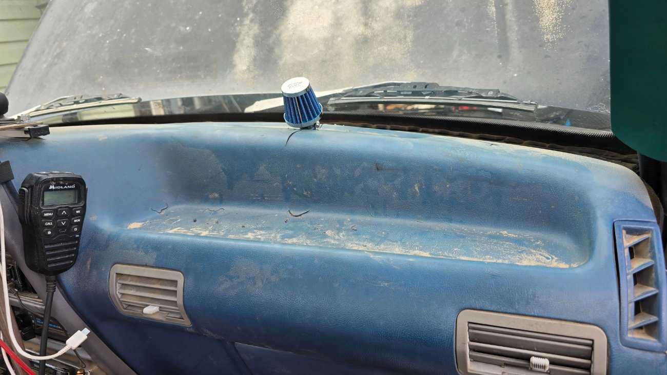

Inlet filter high and dry in the cab.

All it needs is the splash gaurd.
Final installation.

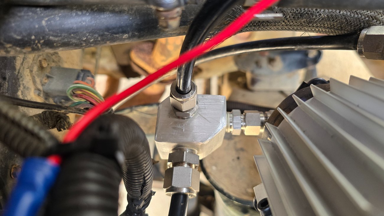

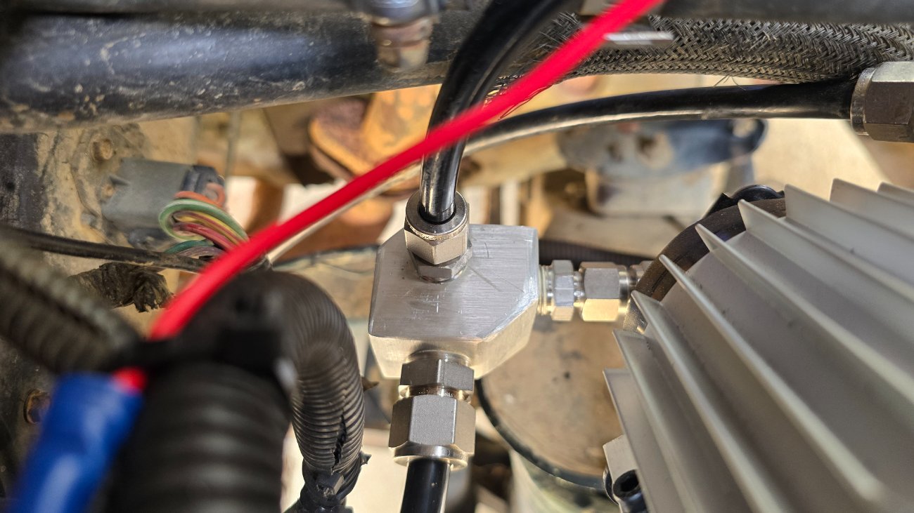

that's the tee fitting I made. Two 3/8" NPT in and one 1/2" NPT out. Those are the intakes to the compressor heads which are diagonally opposite each other. The 1/2" comes from my little K&N intake filter on the dash.
But it's taking air from the cabin! How are you going to have enough air to breathe?!

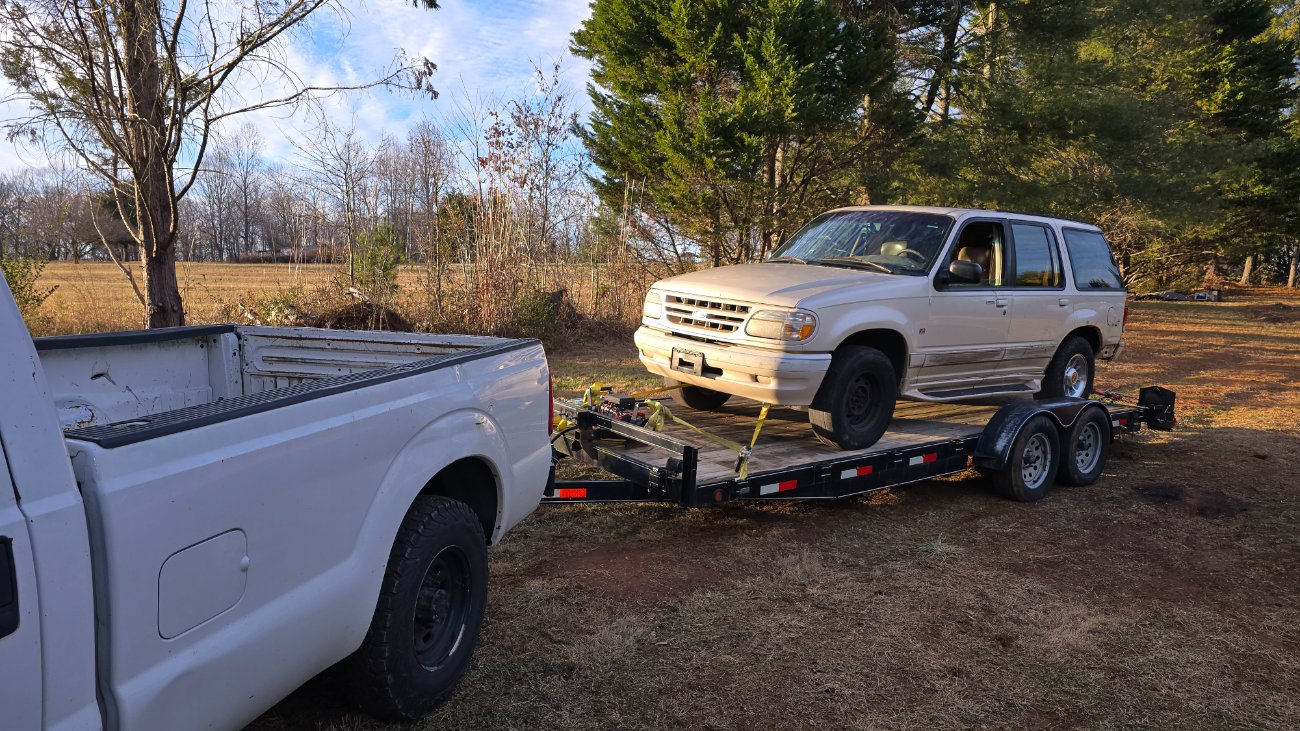

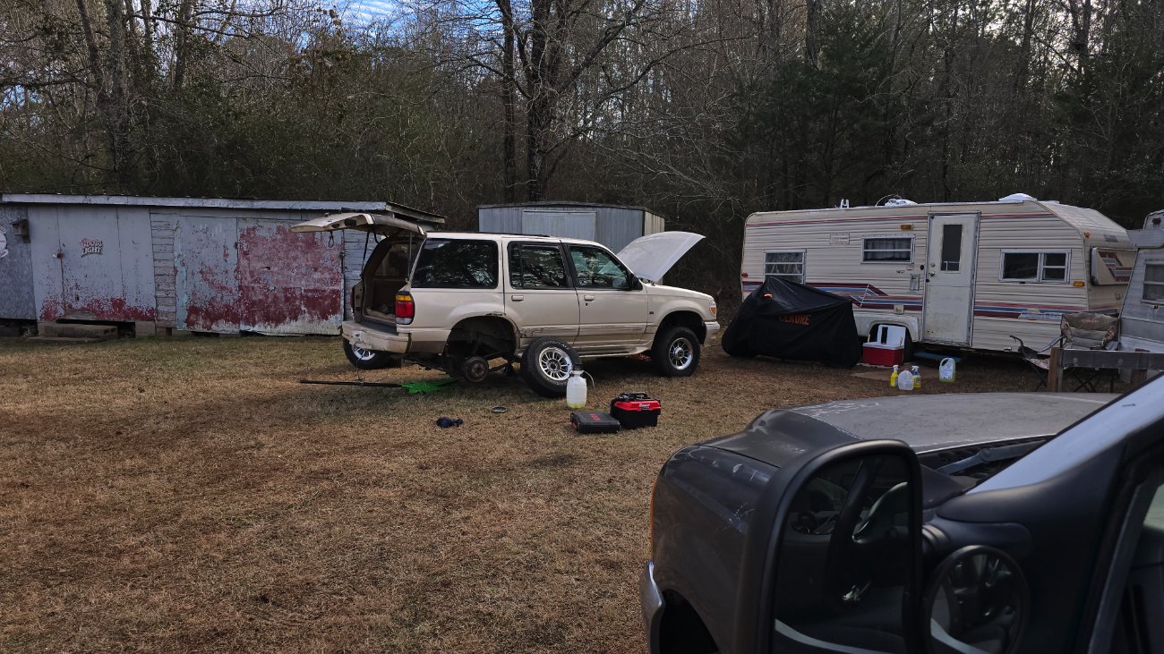

Big things coming in 2026! I'm going to earn my V8 swap merit badge. We offically have a donor. A running, driving 1996 Explorer Limited V8AWD followed me home this adternoon. Details later.
At the place where I picked it up.
On my trailer, ready to come home.
Jealous! If you weren't so dang far away I would try to get the drivers fender and hood from you... But they probably changed the shade of that white between '96 and '00 so wouldn't matter...
That should be a good donor, from what you've been talking about I imagine it's lowish miles but that drivetrain is pretty durable if taken care of... mine was more clapped out than I'd hoped but I figured most of it out...
