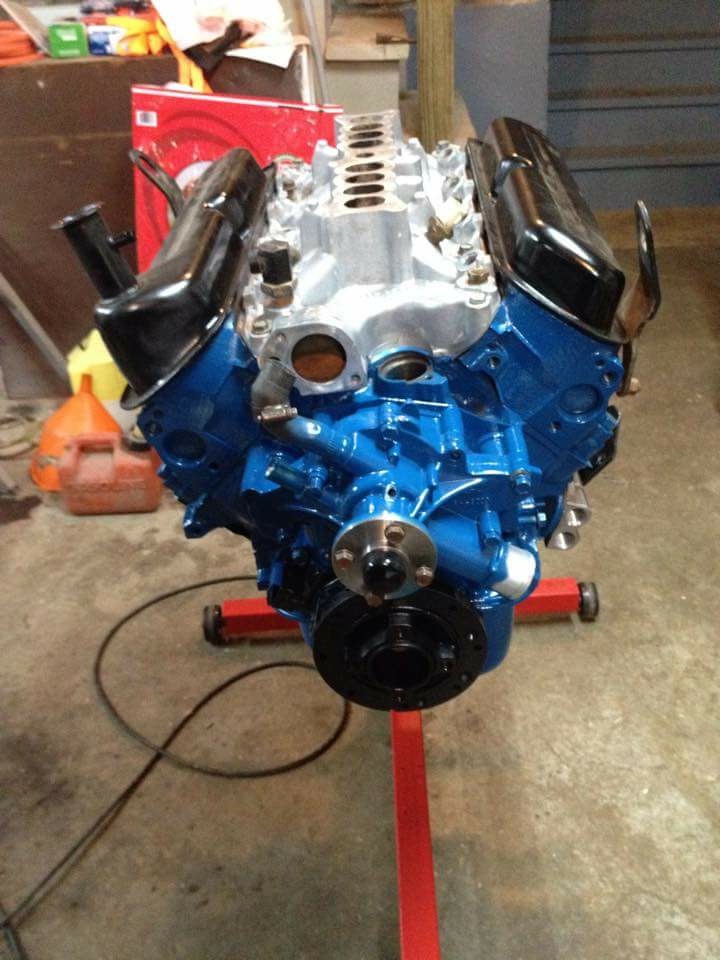

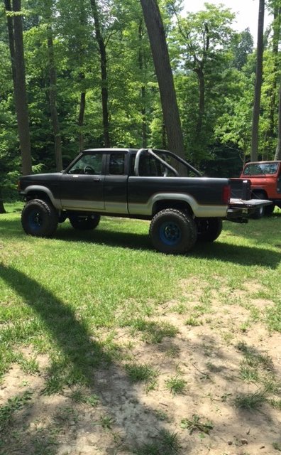

I have a 1989 Ford ranger xlt that has a 1993 Ford thunderbird 5.0L ho v8 engine in it which has 19lb injectors a cobra jet cam and gt40p heads and max flow headers with true dual exhaust and a 1996 Ford f150 5 speed manual transmission. As for the computer I'm using a 1993 mustang gt a9l with the moates quarterhorse binary editor. So my question if anyone has ever done or could possibly help me. Does anyone know how to set the maf curve for the computer to for that engine? Sorry new at this and have been building the truck for 4 years and this is the last major part for the truck

That's what I have done so far

you might try just running it off the A9L with the MAF and not use the QH until you figure it out. That's what I did and it worked just fine. I stil haven't figured out the MAF with the MegaSquirt and I'm just living with it in Speed Density mode.
