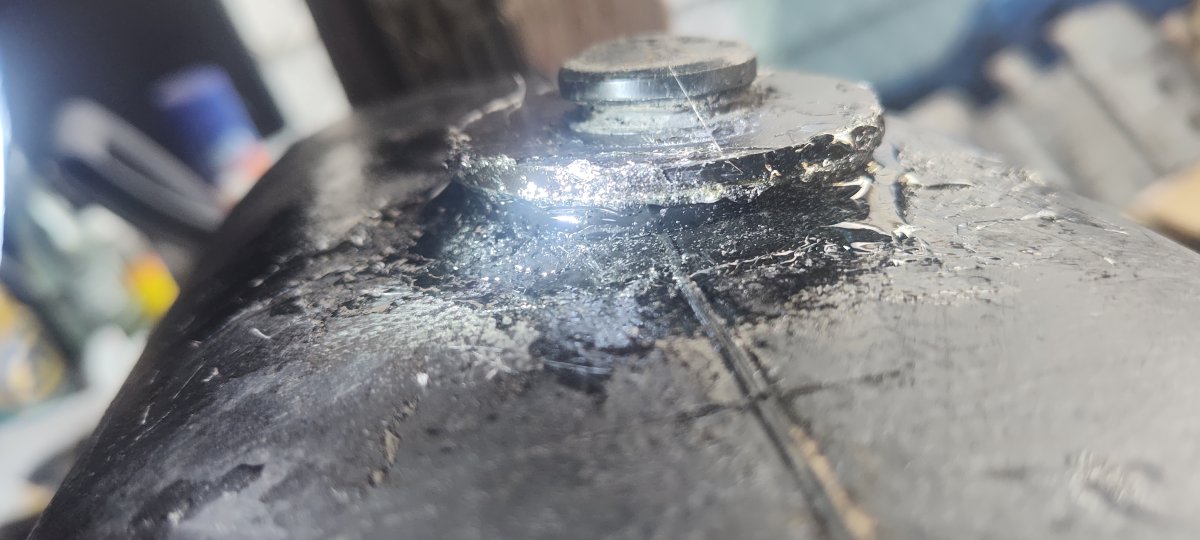

I don't remember if anything goes behind that flange, if not I'd be tempted to take a big O ring and cut it and wrap it in there a few times and seal with that stuff if you are going that route, wouldn't hurt to do a couple layers first though
  • Like
Reactions: MaD

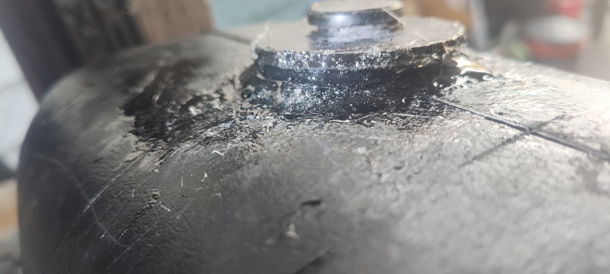

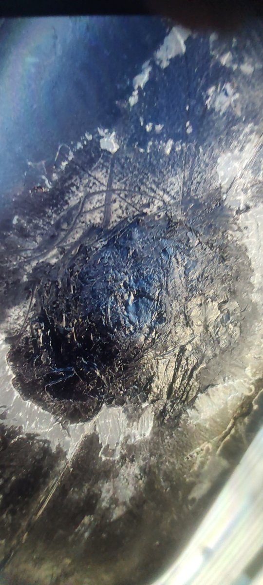

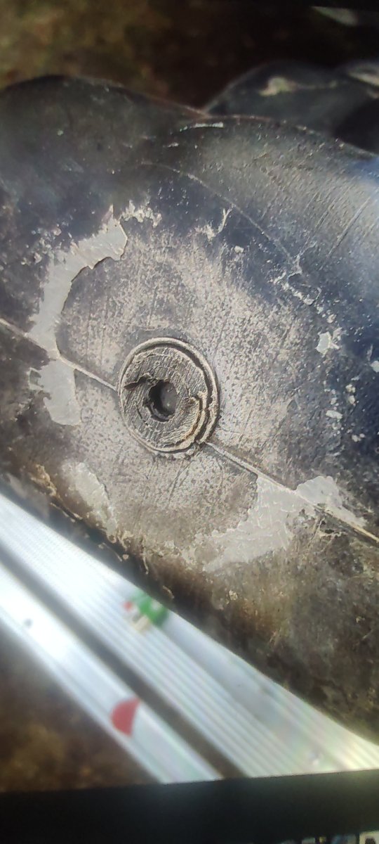

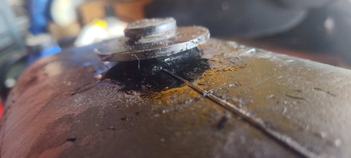

The heat shield does. I cut a piece from the fuel filler hose and I'm using that. I did multiple layers all around.

I've decided to go with this. The crack is in a bad spot to try and plastic weld. Here's the 1st layer.
Ive sealed everything from radiators to fillernecks with that stuff. It should do you well

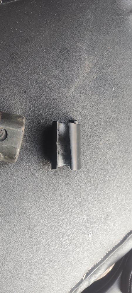

Ok, so it started leaking quickly after my quick fix attempt. I cleaned off the seal all and jb weld, luckily both came off very easy. I ended up cutting the top of the tab off. Then I used a solder to melt the ring around the tab and melt the nub left of the tab over the ring and so far it's been holding up well.
