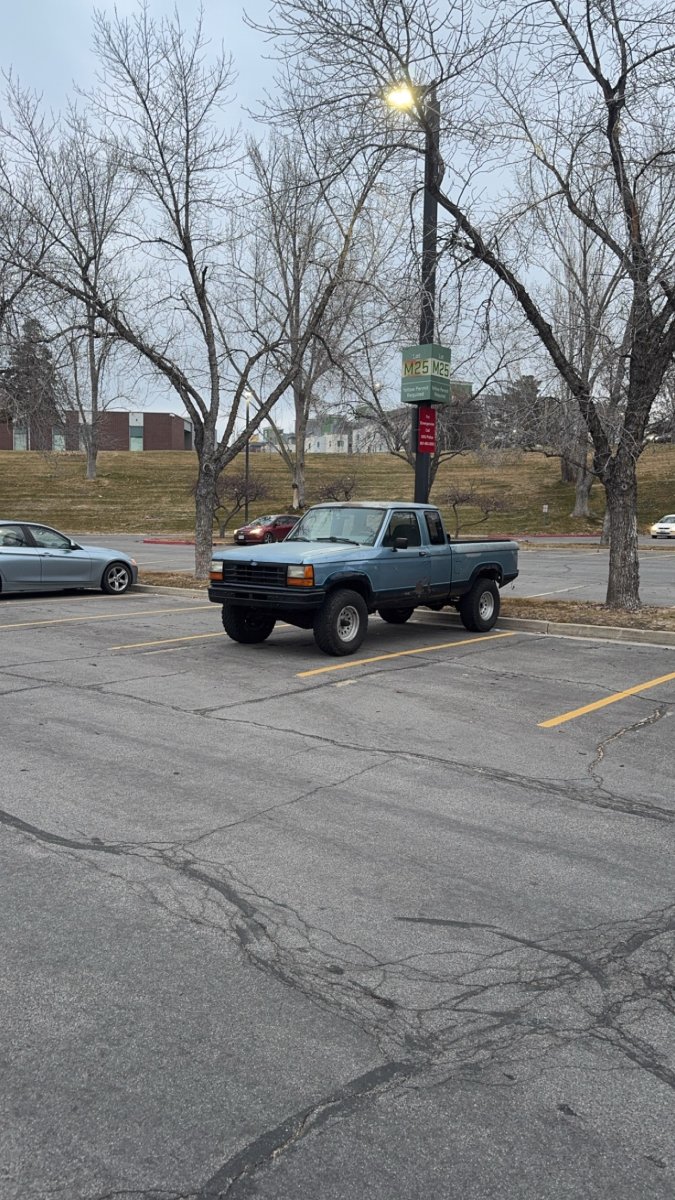

this is how it looks now
Couple updates since last, got it driving decent and been taking it to class in the morning. still got some issues here and there, lots of wiring stuff to still figure out like interior accessories and what not but getting a lot done.
