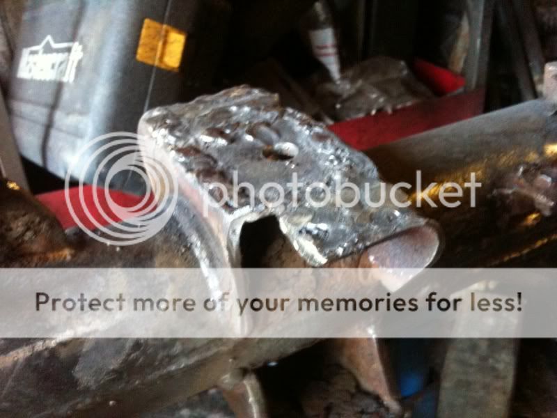

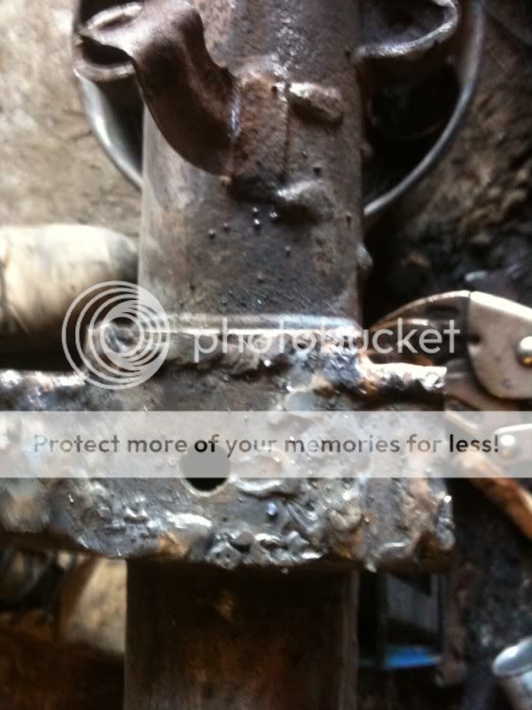

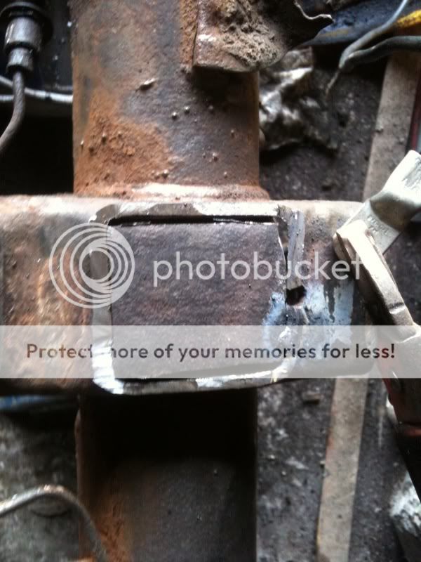

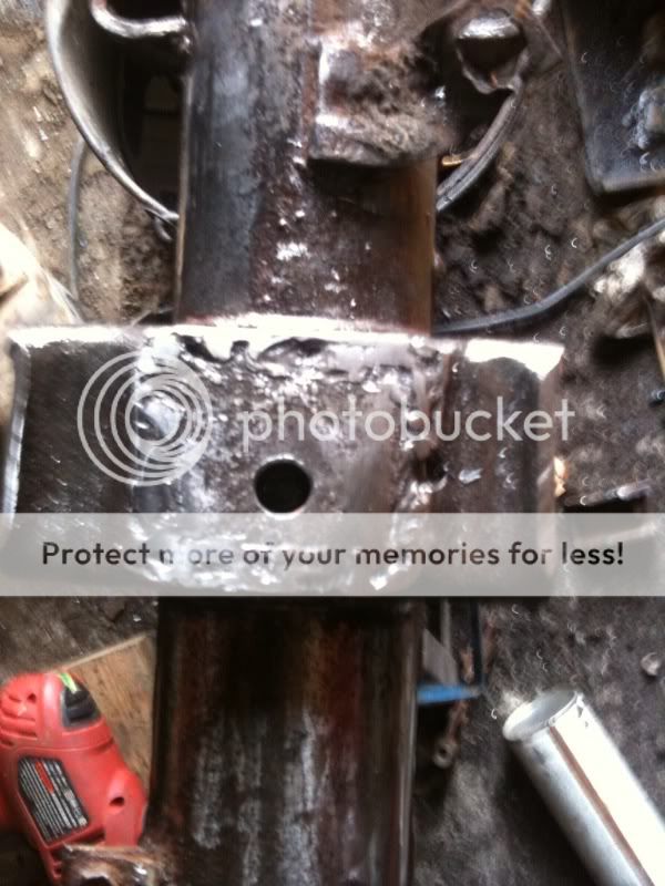

i was trying to decide if i wanted to cut the whole perch off and restart or if i wanted to make the ones that were here work. like i aid they are just about the right width problem is they arnt flat they were grooved to hold the u bolts in place.
i decided to try and make what was there work instead.
WARNING YOUR ABOUT TO SEE HAGGARD WELDS :icon_rofl:
( i will come back in and cut a groove into these and redo it all i just dont have the proper sized rods right now)
my welder is super picky and a pain to use but its all i have for now. dad got it like 20 years ago when someone threw it in the dumpster behind the shop he was working in at the time

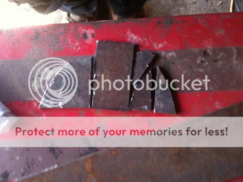

ok so on to the perches because they were originally made to hold the b bolt in place they 2 dips in them so i just decided to cut the hump out between them and weld a flat plate in
i ended up just using the piece i cut off after i trimmed it down. went a little crazy on the trmming for the sides though.... which i think was half my problem with the welds

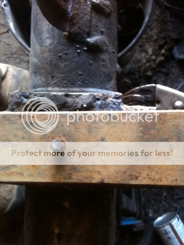

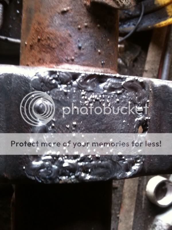

heres the bad bad welds in all the stages...

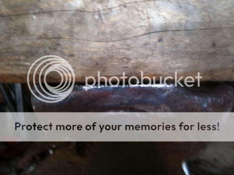

i ran a bead along the edges to try and close the gap up some. but with such a thin rod and they fact that my welder is half broke so all i have for heat setting is the hotter half it didnt work so well
after all the slag is cleaned off
and here it is all nice and flat. im also going to fill in the little dips at the edge when i come back and re do my welds

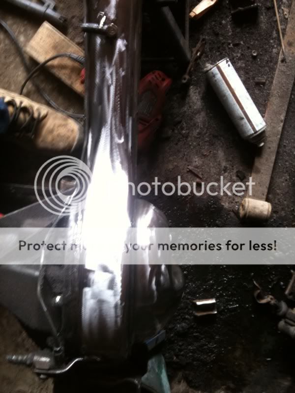

then i got out the flap wheel again and started making the front axle all shiny to match the rear, turns out i grabbed too high of a grit so its much smoother then the rear. i used 60 grit on the rear and 180 on the front lol

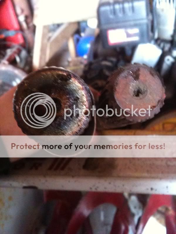

and last but not least i figured while i had the camera out id grab a pic of the difference between the diameter of the 22 spline samurai front axles and the toyota 30 spline front axles
obviously the toyota is on the left and the samurais on the right.

So how do you plan on dealing with the wider perches and narrower springs?
I wonder if there's enough meat to just drill holes for the ubolt to go through the perch on 1 side of the spring? Or maybe notch both sides for u-bolt clearance?
well because the springs are off center theres about an inch on the outside of the perch that i think i may just notch out and cut some extra tubing lengthwise and lay it in so it looks cleaner. of course i shoulda though about that b4 i did all my welding yesterday acause its gonna be a pain to notch them out now haha

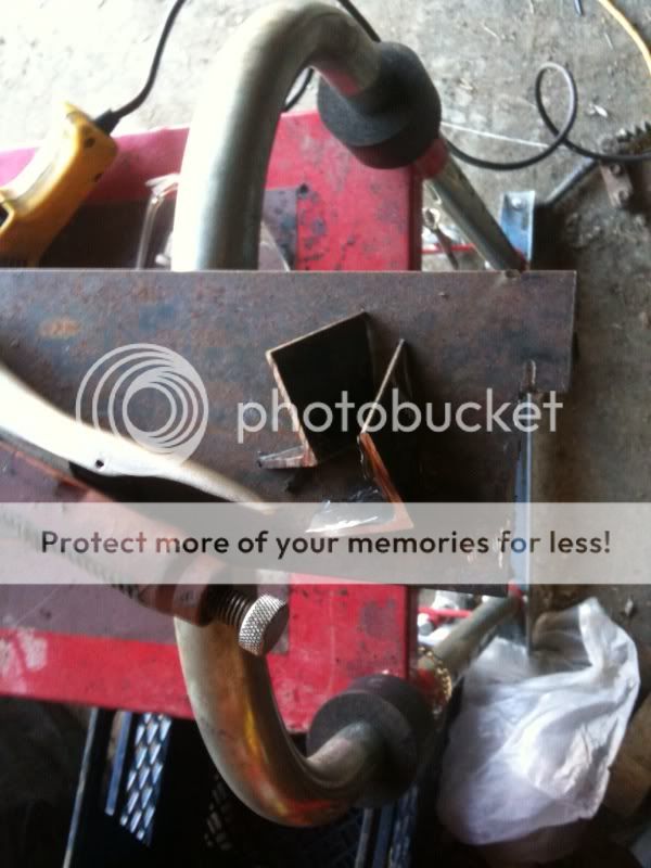

but b4 i slacked off sat on the deck and drank beer all afternoon i got the perches done.

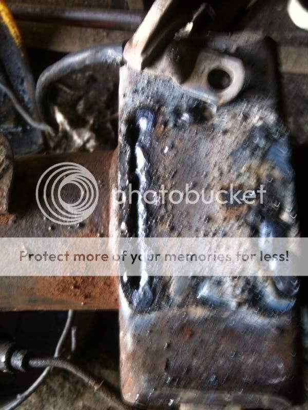

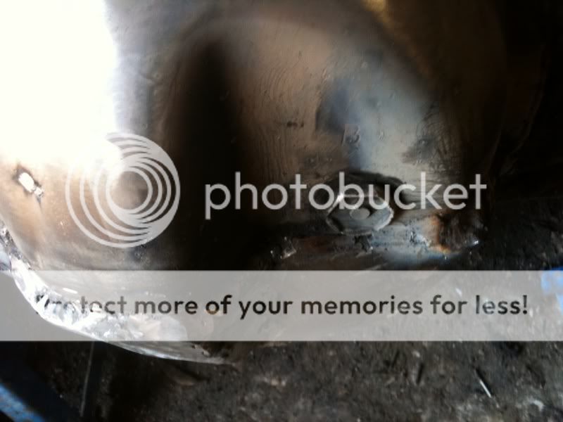

i just cut out the area where the u bolts will be comming up and took some angle iron and boxed it all back in.
i still need to grind down all the welds buti forgot to get a new disk for it when i picked up the cut off wheels yesterday

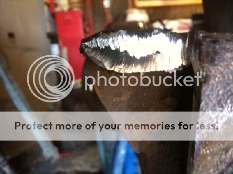

i already filled in the area i had to cut out so when i sliced it apart it was kinda cool to get a profile of how my welds were theyre ugly but seem to penetrated pretty good

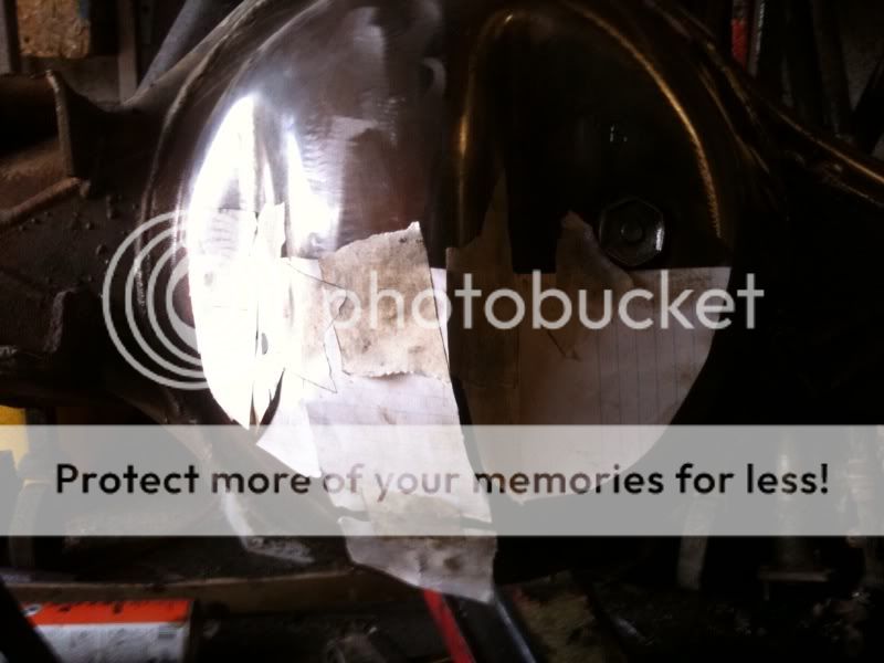

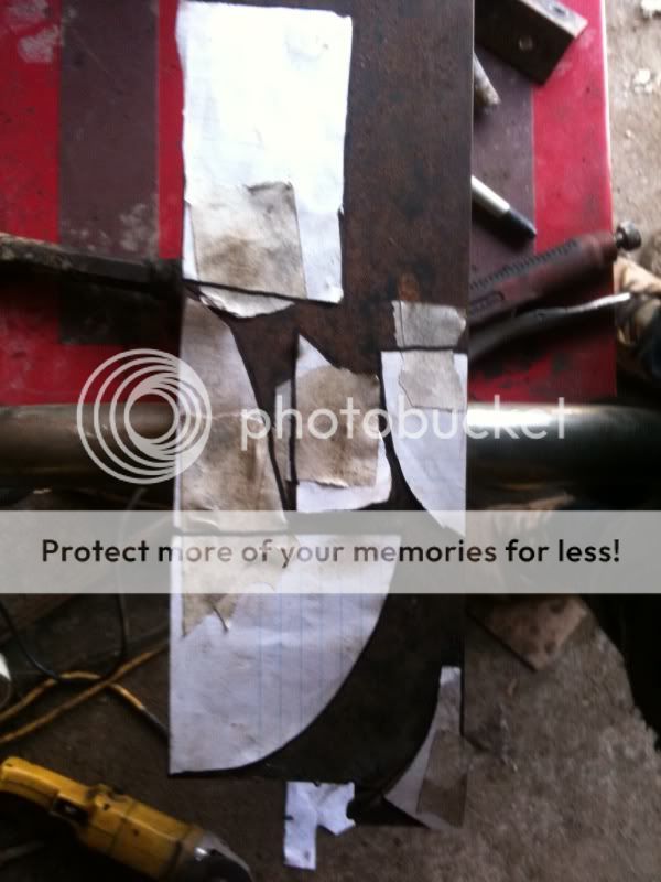

after getting that done i decided to start on my diff armor its all 1/4" plate if i bend it i think im gonna have bigger things to worry about haha
i started witha paper template (actually about 8 pieces all together to make the cover)
then i transfered itto my steel. i tried to get as little waste as possible when laying it out. you know making it so one cut works out for 2 pieces
then cut it all out. 3 zip disks and about an hour an a half later lol

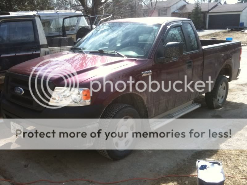

So there i am sitting on my front porch enjoying the sun and said screw it im cleaning my truck im tired of a dirty ass plane jane run of the mill f150 i think it turned out ok haha still have to buff it wax it and polish the exhaust rims and running boards.
before:
after:
i went and threw my summers back on... guess what they were forcasting for between +10 and +15 all week now... snow tommorow :annoyed:

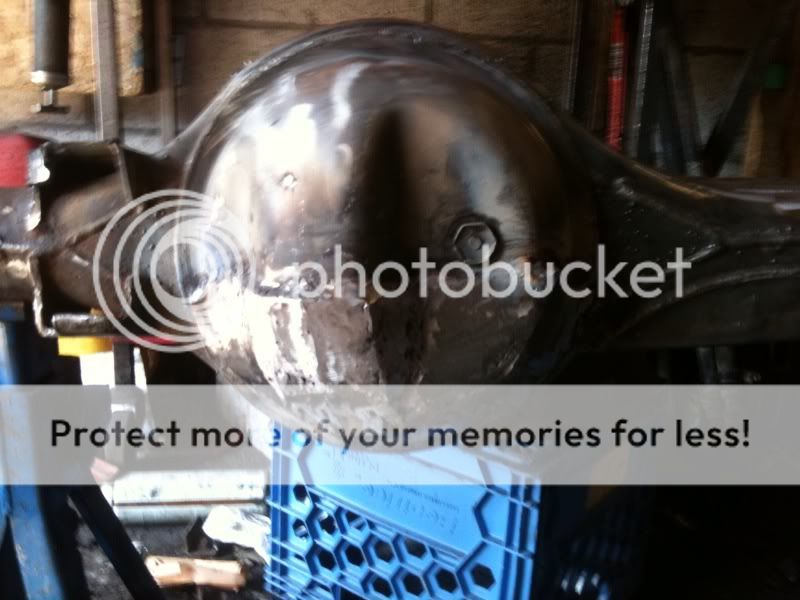

alright progress! kinda lol finally got my diff prtection all buttoned up. also found out the brand new fuel pump that i got for this thing isnt the right psi. i shoulda followed common scense but i didnt and now i lost the recipt and am 130 bucks in the hole with a fuel pump thats usless.
but anyways here the finished pics of the diff

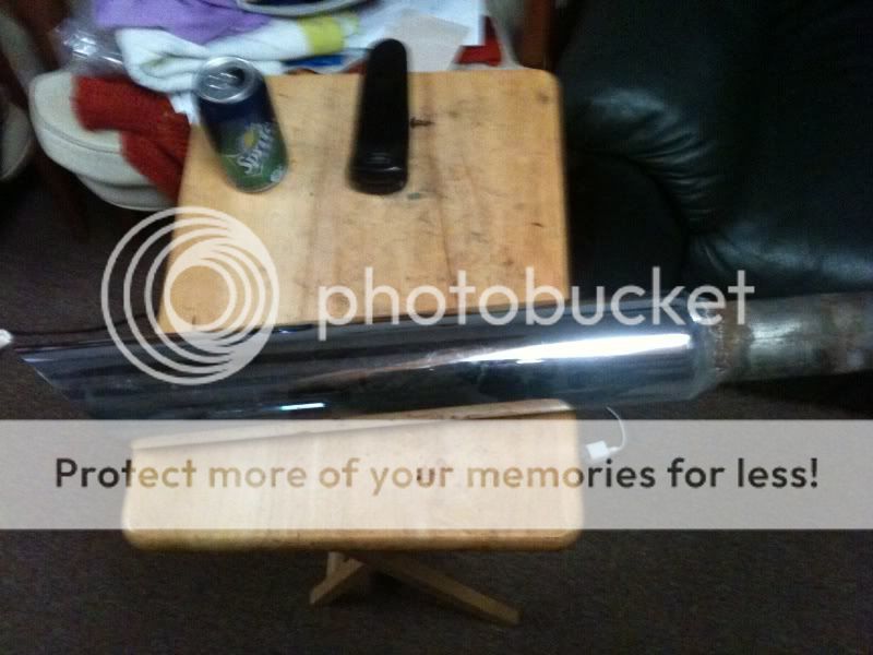

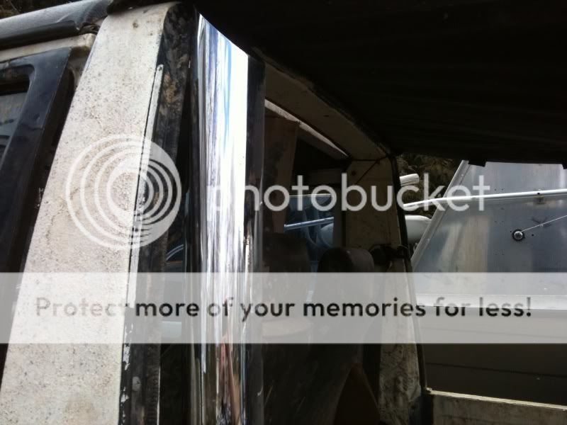

i HAVE to get a muffler on this thing this year a straight piped 4 cyl is damn loud epspecially with the hedder. i had some extra tips laying around. that i was trying to find a use for they are 2.5" in and 3" out and they are 22" long
turns out they are the perfect hieght for stacks :stirthepot:
but then i wouldnt be able to run either roof out back... plus ive always said gas trucks with stacks are gay. so i duno if ill do that, on the other hand though if i shut it off in deep water i dont have to worry about it going up the exhaust

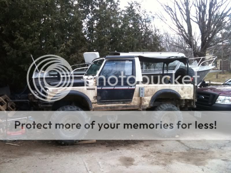

and then i realized that i dont have a profile pic of the truck scince ive done the lift (matco truck was in the way)
so heres one

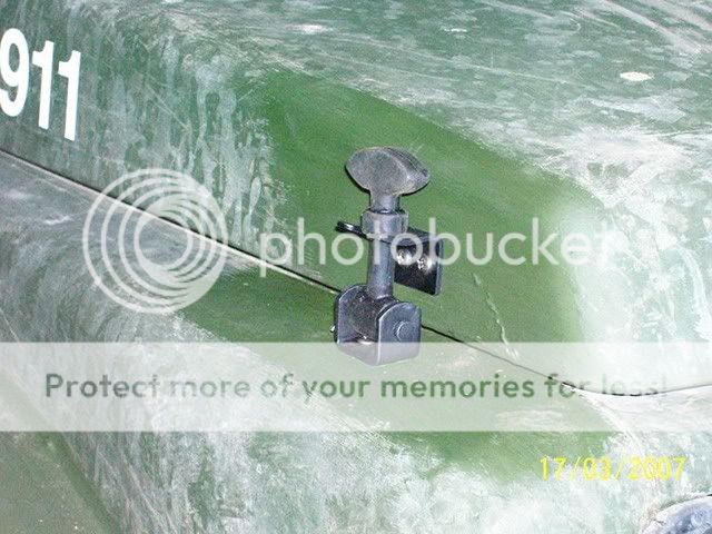

while i was surfin the site i got myself some external hood latches, i had to remove mine to get the rad where i wanted it.
