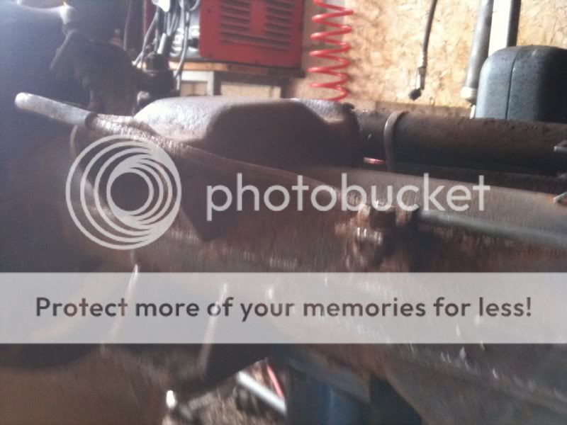

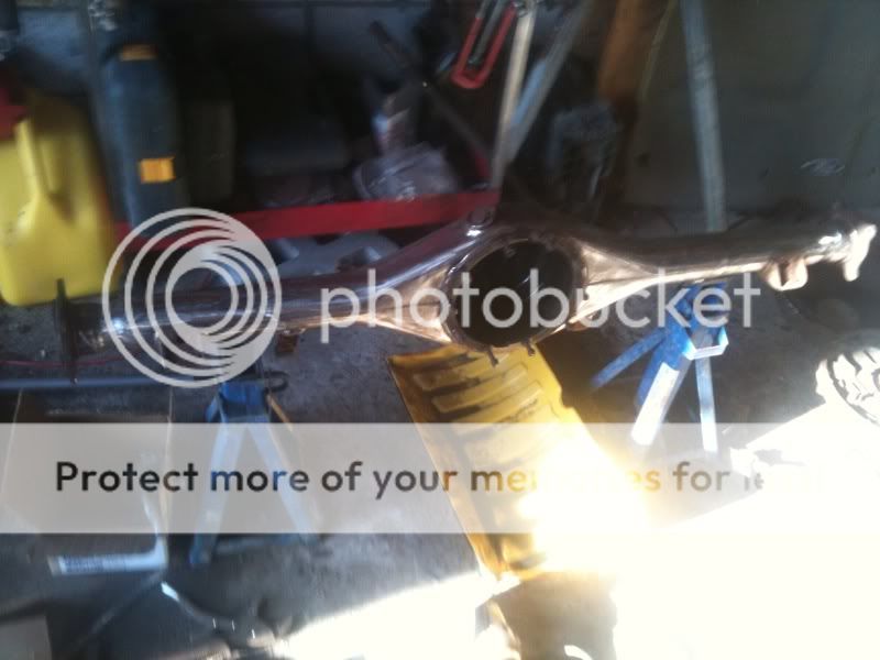

then i decided to clean up the toyota rear axle to paint it. i used a flap wheel on my grinder came out real clean but now im likeing the bare metal look how do you think it would hold up if i just clear coated the axles?

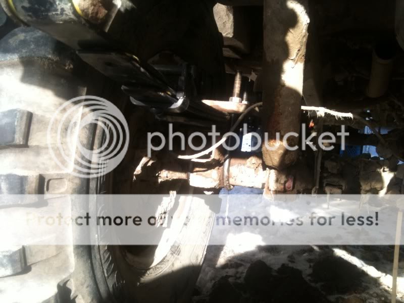

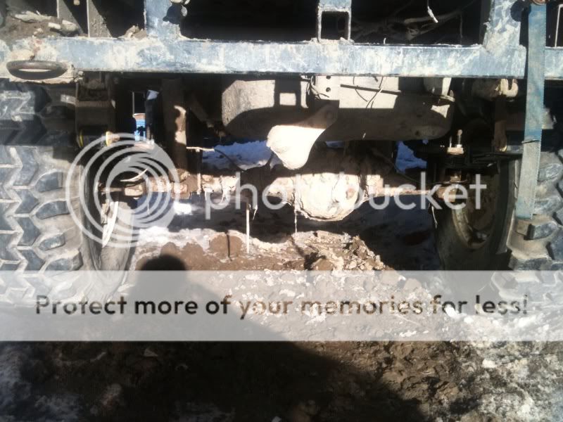

then just a few of the rear suspension, i cant get a profile picture of the truck untill i can move it theres a boat on one side and a matco truck on the other.

alright well i went ahead and cleared the bare metal we'll see ho wit turns out. wrst comes to worst if it rusts ill grind it off and paint it properly. or just let it rust haha no different then what under there right now.

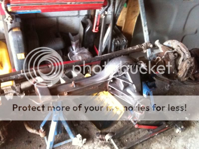

its outta a 88 landcruiser which isnt the axle i was looking for originally but the more i look at it the better it seems it'll work its wider then the regular toyota pickup front axle so that means i dont have to run wheelspacers:icon_bounceblue:

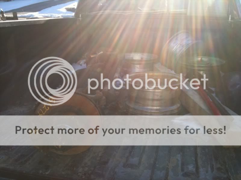

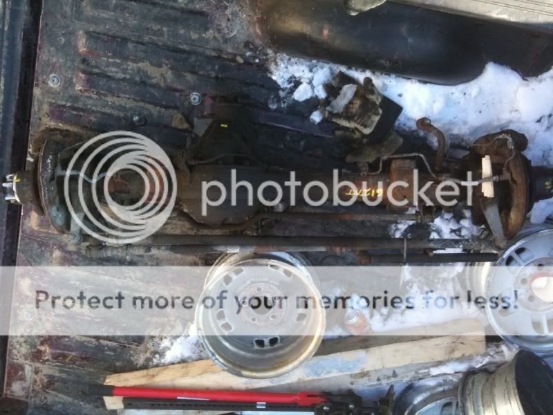

here it is still in the bed of my truck, that was fun taking out alone....

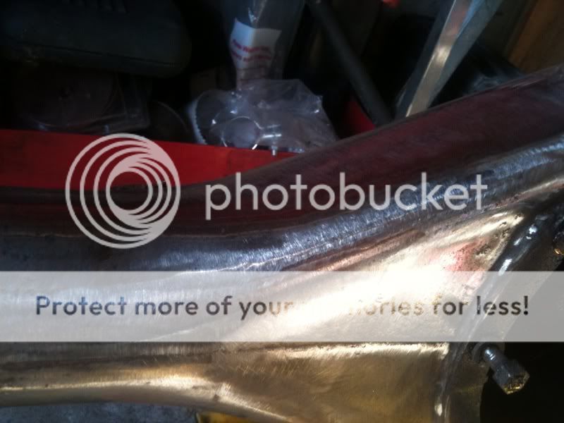

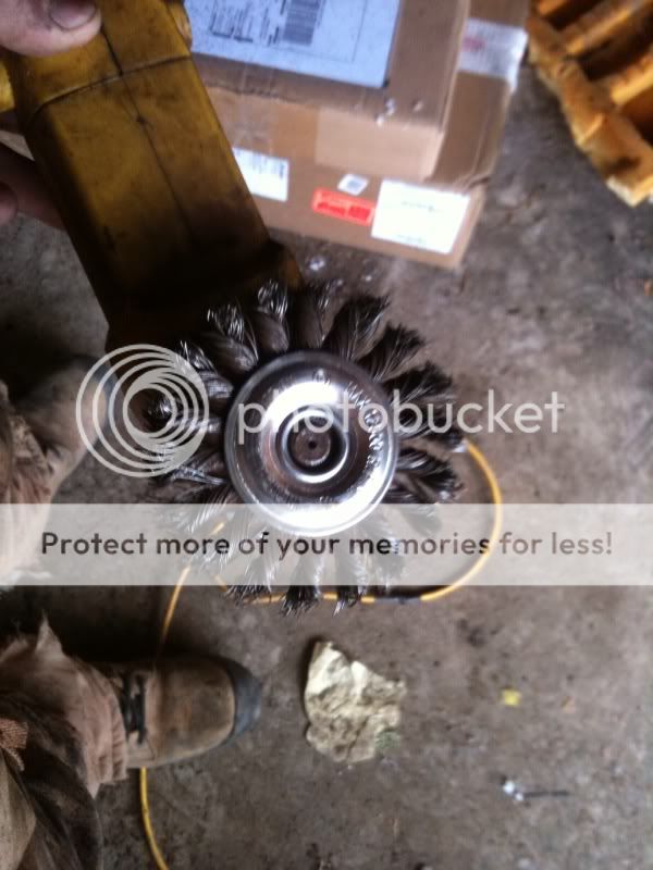

i used this to clean if off and now that its clean ill go over it and cut off any brackets i dont need and hit it with the flap wheel and clear coat so it matches the rear

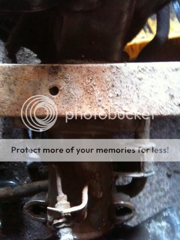

as for the spring perches they were built for a 3" wide spring and the samurai springs are only 2" wide so ill have to tri, one said doen and add to the other to get it the right width for the samurai

im thinking i may just cut the top of the mount for the u bolts and weld a flat plate on because my trucks spring over then i have me perches.

my rear axle is 58" wide and this one is 58.5" and the spring perches on a samurai are 26" apart and this one is 26.5" big deal i gotta move each perch a 1/4" as far as i can tell the landcruiser axle would be a hell if alot stronger. it was under a bigger truck with a diesel in it. and the diff is huge. as in thick it still wont hang down very far.
now on the subject of the diff the vin says it has a diff lock. but i see now wires going into it does this mean that its a mechanical locker? or is it just talking about the locking hubs on it? this would be a good question for bones but i dunno if he's seen this thread...

A half inch in spring perch distance is minimal, like you said it's only a 1/4" per side, it was the very same on my Rover, the spring spacing was 26" on it and the diff was 26.5. I just lowered the rig, with springs in place, down on the diff and with a slight push with my hands the springs centered in the diff perch holes. 1/4" per side is easily taken up by the spring bushings.
Actually looking at the diff, you have to weld on either a plate on top of the old u-bolt guides or better yet, cut off and weld on new perches. Places like Princess Auto sell leaf spring perches for building trailers, these perches are made from 1/4" wall plate and made for 2" wide springs. IIRC the Cruiser has 2.5" wide springs and your sami will have 2". Remember to weld the perches on at the correct castor angle. Sami's have somewhere around 0 degrees of castor and so do the late 80's Cruisers. It wouldn't hurt to give it a degree or 2 of positive castor. (rotating the pinion down will be positive castor) This will help it drive straight and not be twitchy on the road.
Definitely no factory locker in that diff, sorry to say. The factory Toy locker has a solenoid sticking out the side of the drop out.

That's the one partwhere I'm lucky right now I'm running the Toyota 2.4 fuel injected motor with a 2wd trans so I can have the divorced sj-410 transfercase with the rear output. Offcentered to match the Sammi rear diff, but because I'm going to a centered rear diff I'm just gonna swap to a Toyota 4wd transmission and run the Toyota transfercase with it. And as for the perches I'm runnin outta $ this week and don't wanna wait 4 more so I'm just gonna leave the Toyota ones there and make them skinnier to match my springs and while I'm at that I'm going to just throw some flat plate on the upper perch. Power steering is definetly in the plans it's was a pain in the ass b4 with the 33s I can't wen imagine 38s and I'm a pretty big guy lol my 110 lb gf wouldn't stand a chance haha I figured it didn't have the electric locker because like you said there was no solinoid but it said diff lock on the vin but I didn't k ow Toyota had a transfercase like what you explained thanks

The truck you stole the front axle from may have had a rear diff lock too. The drops out will directly swap front to rear as they are identical. If I were you and I had a couple extra bucks in my pocket, I would go check out that rear diff to see if it has the solenoid sticking out the side of it.
