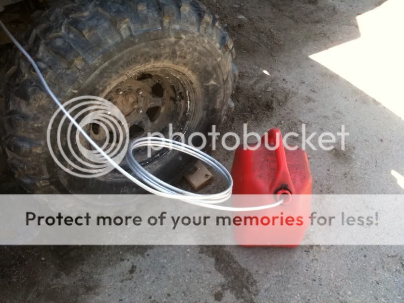

i hooked my fuel lines into a jerry can and ran the truck it ran perfect i even got to rev it up and all that. good thing no ones around lol my nieghbours dont like that truck too much i dont think. not scince it started running an open hedder anyways
found my leak im almost sure why the truck wasnt priming :shok:
i was right it was between the pump and the tank. in the metal line i just got the wrong part of the metal line lol

so heres how i made sure the problem was the tank b4 i took everything apart
well it started up and ran perfect. and i found my leak lol

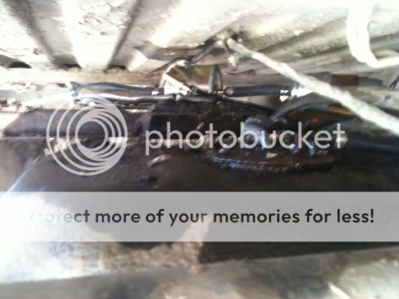

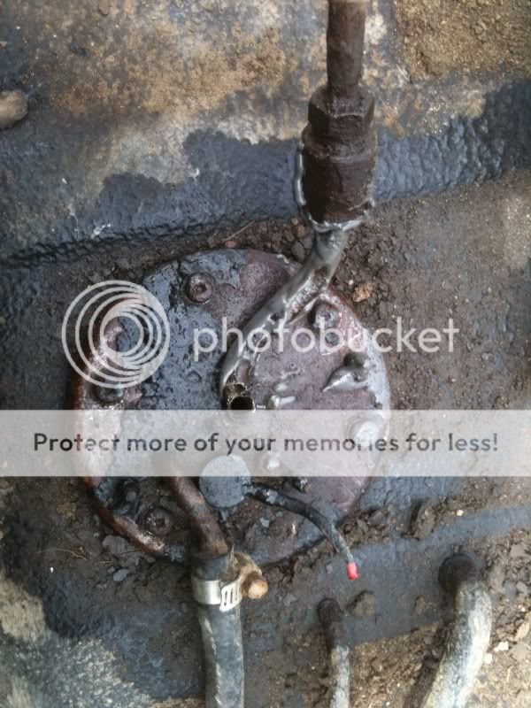

so i syphoned out the tank. that was so fun.... all i could think while doing it was that gas is at $1.33 a litre here and i beter not spill any haha
so once i got the tank down i could see the problem a little easier.

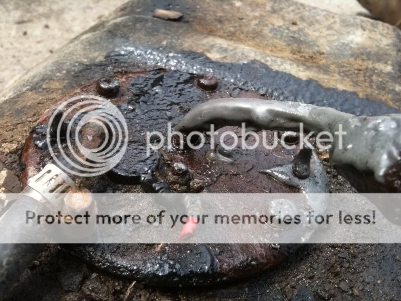

i duno how i missed that last time i had the tank down or maybe i just bent it and made the hole when i put the tank back up last time.

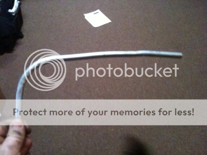

so i went and grabbed some line and bent this up, i dont think its so bad considering i did it with a 10mm box end wrench and vice grips
so i went to my buddys shop and drilled out where the old pickup tube out and welded that one in. then covered all my welds in jb weld incase of pinholes. that was drying all last night so i havnt gotten it back together yet.

Right on, progress!! Yeah I bet you sealed it up fine with the JBW and then bumped it on the last install. Looks like it was pretty rotten anyways, I would certainly make sure the other rusty looking line is A OK before you slap it back together.

Yea the other lines is still solid. And I'm chasing down a tiny tiny leak In the one I redid right now. But I gonna wait for the jb weld to dry b4 I break out the soapy water again

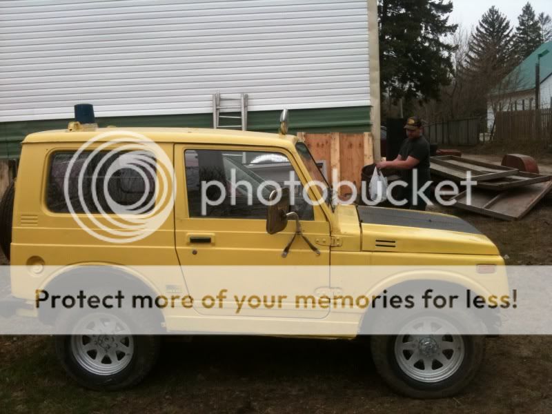

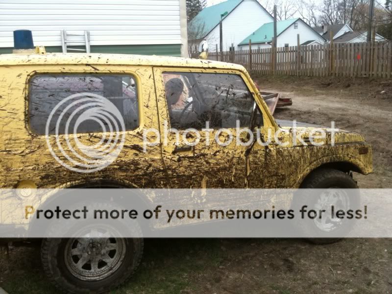

Well it turns out the Suzuki/mud/toyota gods we're happy with me today. Started my day by pIcking up my gfs prom dress got a text from my buddy and he just got his truck done and wanted to go out. But sconce the samurai was apart I ended up taking my sj410 ( that little yellow one from earlier) all went good except I think the sj has bad gas it kept stalling I went everywhere my buddy did though. Which is pretty good considering the difference in the siZe of the two trucks.

heres just some b4 and after pics of the sj it got dark so i ddint get any of the samurai. it was a fun day though
Cool, always liked them little buggers!! LOL
They are a quad, only better, because you have heat, a stereo and a dry place to wheel in with a couple friends, try doing that on a quad. haha.
yea it was pretty fun i went everywher emy buddys sas'd mazda went and his rockers are at my waist lol. that yellow one is going to be my commuter once i get around to working on it.
