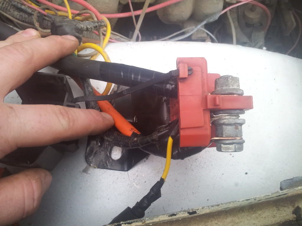

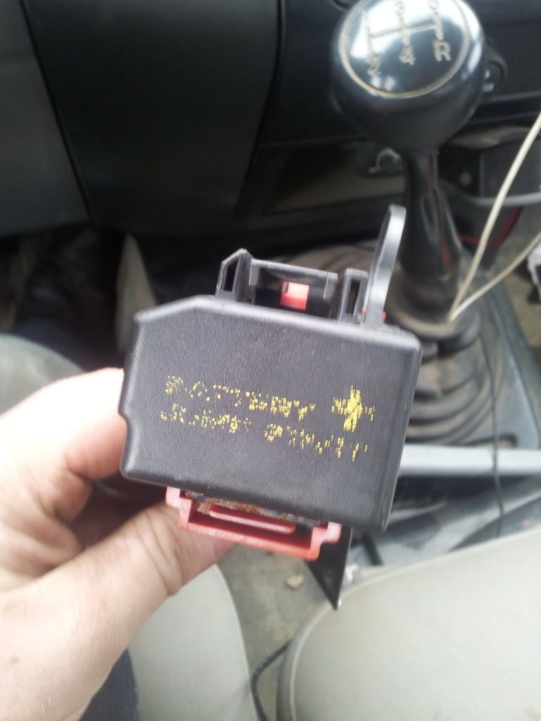

i got the front end all back together today and managed to break off a felt ring protector bolt.... shitty... so il guess ill try and deal with that tommorow. also heres the pics of that remote jumpstart thing i was talking about

plan is to run the negitives to the frame in the back of the truck then run the 2 positives up to the inner fenders up front then thats where ill tap in for the power for my fan, winch, starter etc that way all i really have to change is the one terminal from a battry post type connector to a eyelet then i think thats it

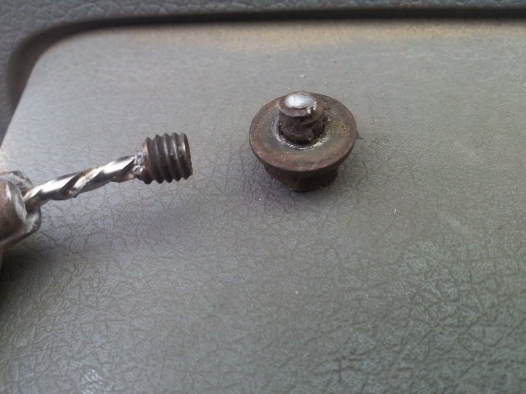

another small update. when i was putting the front and back togther yeterday i managed to break a felt ring protector bolt. and managaed to get the rest of the bolt out today. i got lucky and when i was drilling for the easy out the bit caught and spun the bolt out for me. :D

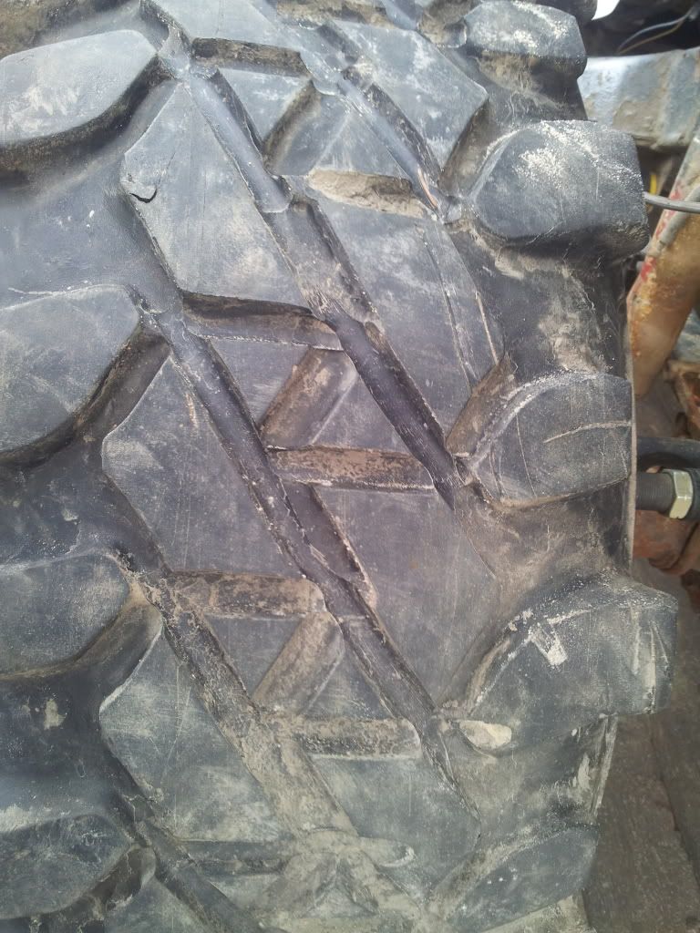

i also started looking into tires and am thinking of just buying new because i know i want to stay on 38.5"s now and the difference in price between boggers and swampers is $3.... which makes things diffeicult i dont knwo which i want i know my tsls work great so its hard to change, but at the same time ive always ALWAYS wanted boggers.
but after thinking about it for a while i think that im gonna get the $ saved up (considering its the same cost for each) then im going to surf kijiji for boggers. if theres a screaming deal on a set used ill go with boggers and use the leftover cash for somthing else. and if theres nothing on kijiji ill be getting new 38.5x15R15 bias ply swampers

these are the connectors from the intrepid one for each battry these are also where im connecting the power for my winch
1988 samurai LWB build
all uncovered the orange is to the starter and the big black cable runs to the back for my positive for the battry everything else is electric fans lights etc.

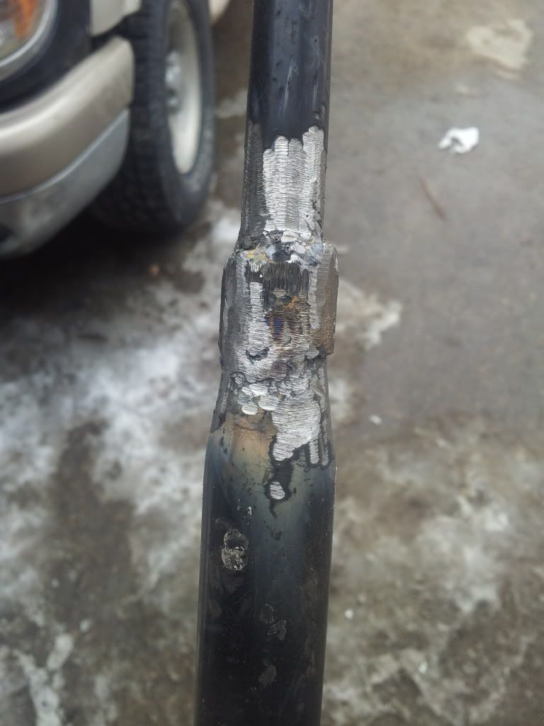

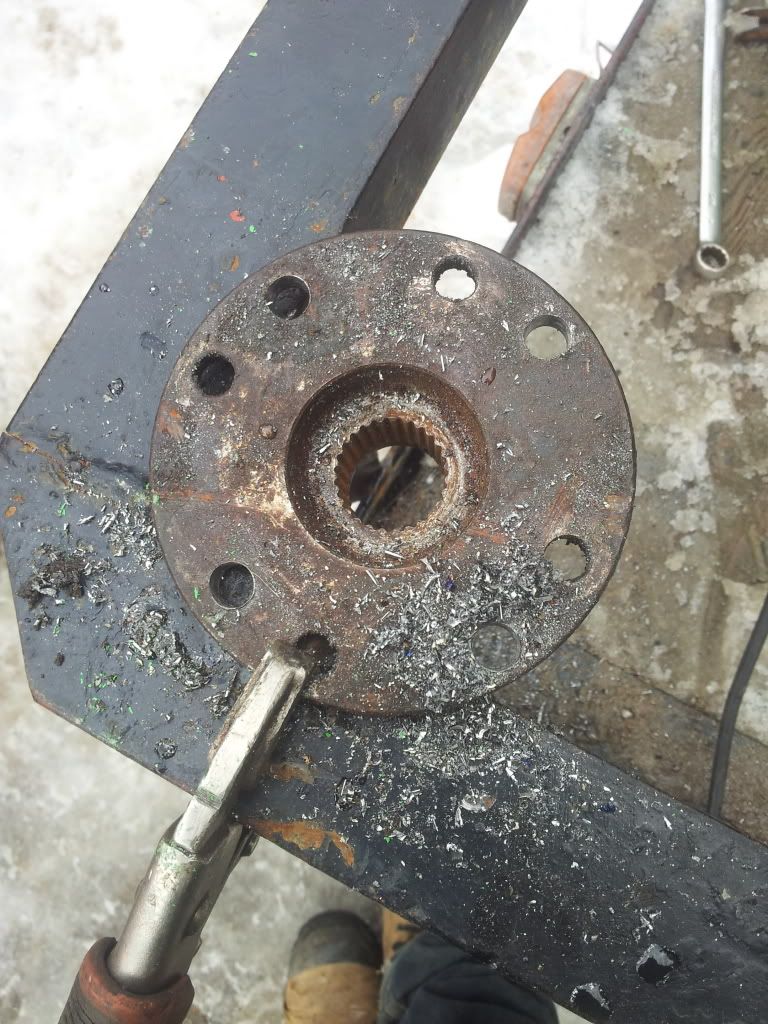

alright a few things got done i finally got my front driveshaft back from being lengthened and started putting them back in and of course theres 3 bolt patterns for toyota driveshafts and not one of mine match up lol both driveshafts are different from each other and the transfercase flanges match my rear pinion flange but the front one is different too. long story short it sucks re drilling new patterns into 4 flanges while under the truck because of course i didnt do it while the transfercase and diffs were out of the truck. :roll:

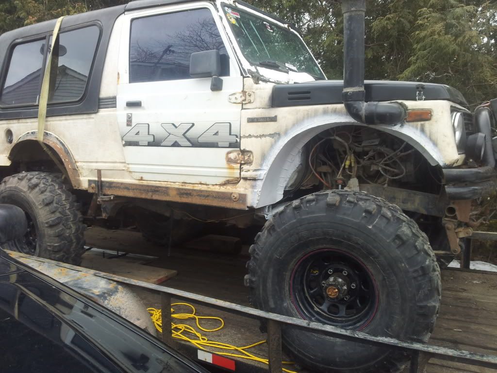

also picked up new meats 36x12.50r15 tsls on black D window rims

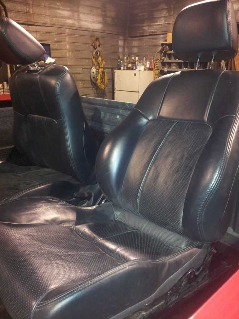

also picked up some new seats to replace my tattered and torn stock seats.
theyre out of a prelude. its kinda funny the only time ive had leather buckets is gonna be in my off road truck lol

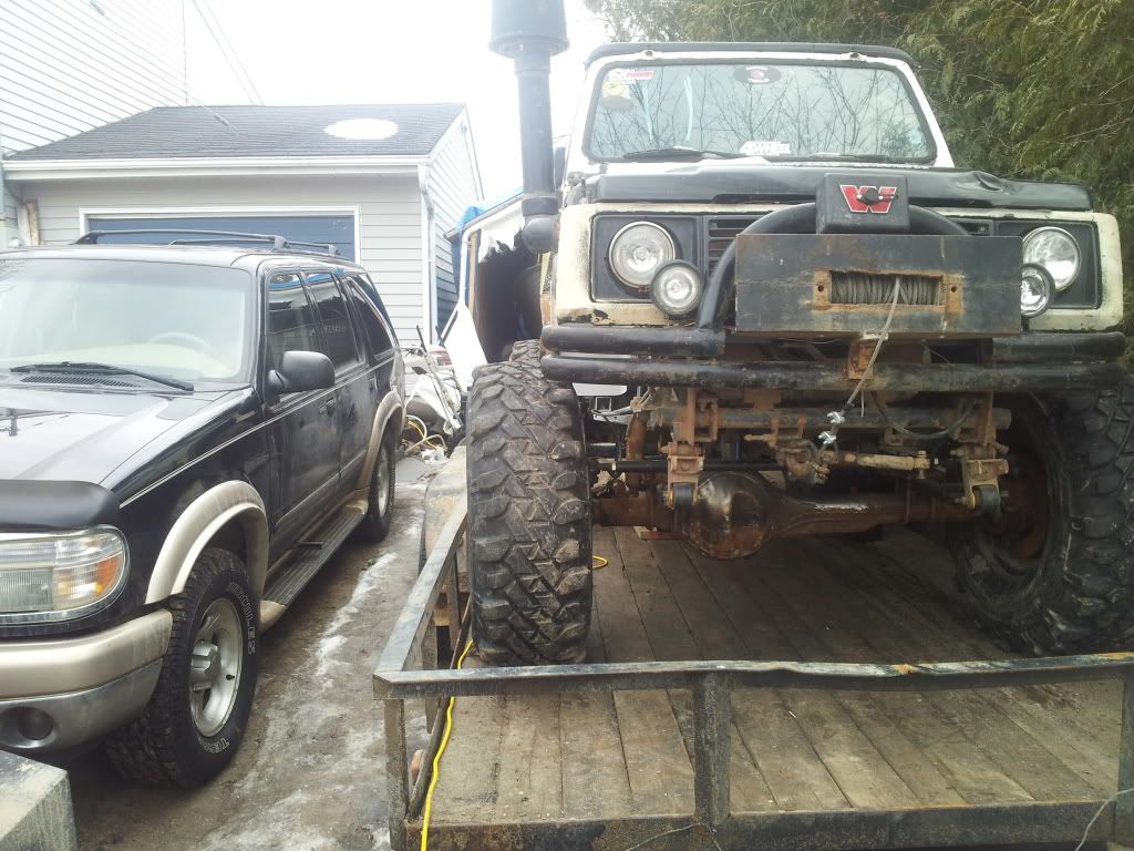

with working too much i got no time for it then now being laid off and working on it outside in canada in the winter i have to brush like a ft of snow off if it to do anything its hard to get motivation. plus i just bought this
but its just about there. gotta wait for one day thats its above -5 cecius so i dont spend 4 hrs trying to get gear oil into the transmission then its just wiring for the battries and i think i can rip it around the block at least.

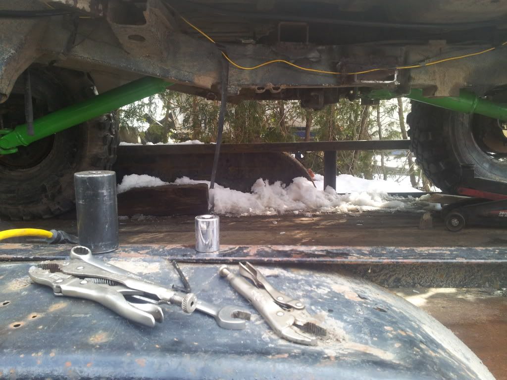

a few more things done. i went to put my driveshafts in the other day and surprisr sursprise they have a different bolt pattern then the pinion flanges... all four flanges were wrong. :bawling:
so after drilling the pinion flanges on the truck it was time to do the transfercase... and lying on your back trying to put any sort of pressure on into the drill just wasnt happening so i ended up pulling the flanges off and drilling them on my trailer

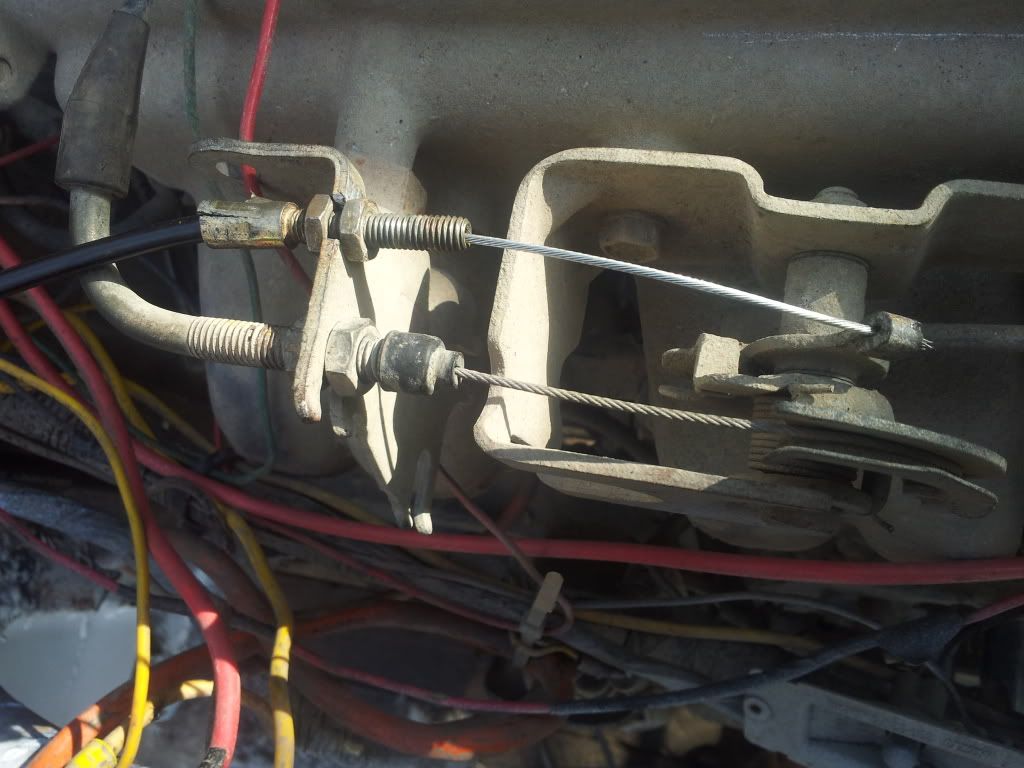

got bored today so i robbed an old bicycle and made up a hand throttle.
getting an idea on mounting it
i had to strip the sheath back some to get more wire out
so i stole a cable ajuster out of the bottom of my old seats and cut a groove in the bracket to hold it
the end of the cable is clamped into the lever for my cruise controll
so i had to make a handle for my hand throttle because the shifter handle was too narrow. its just a chunk of handle bar welded to the shifter
