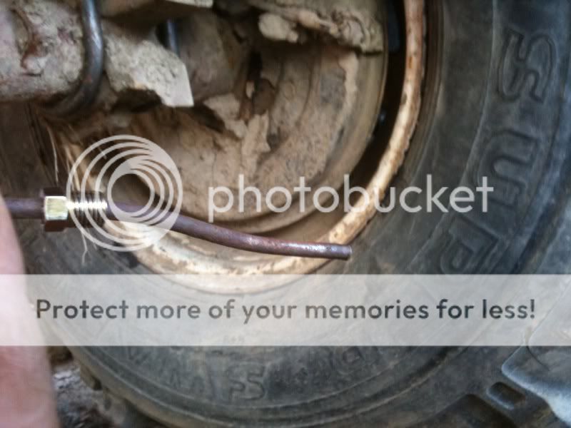

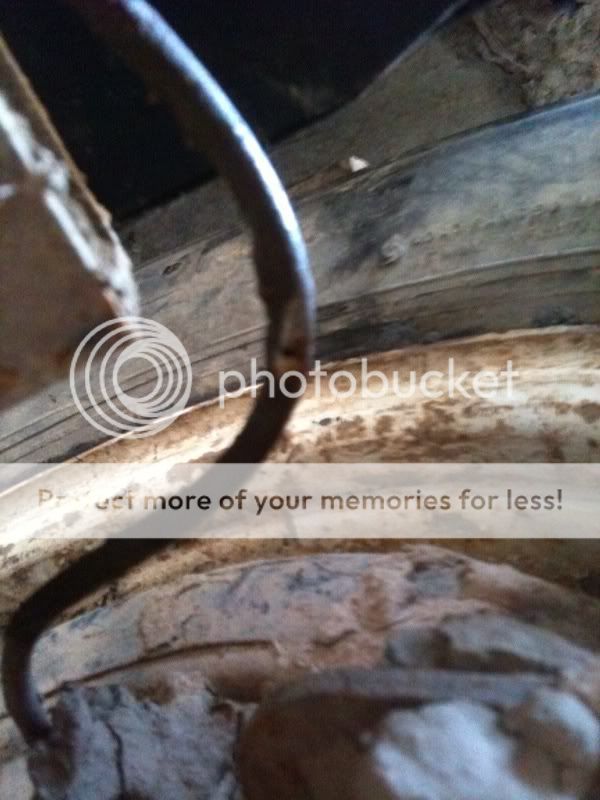

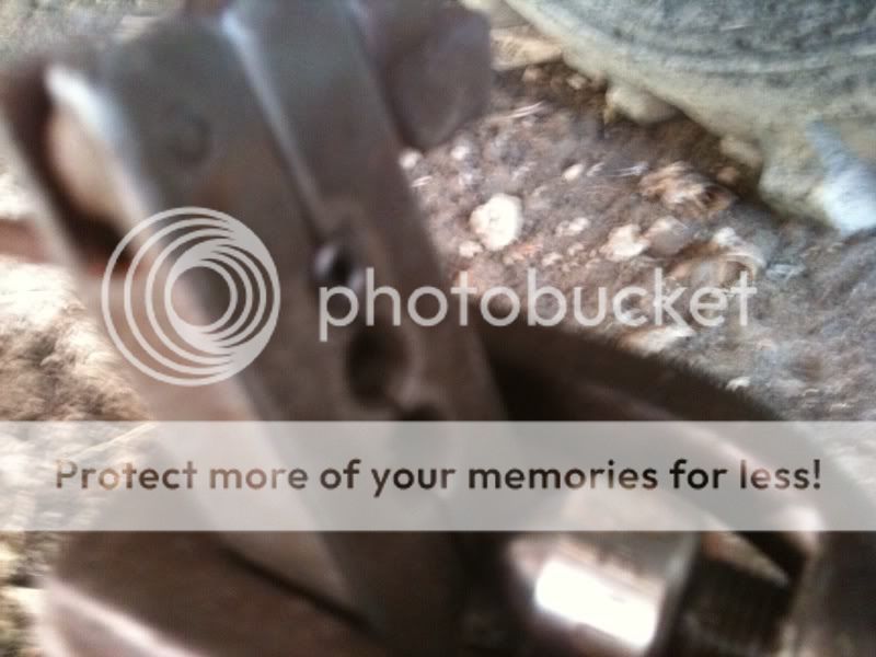

ok so its been real nice so ive been doing the more boring pain stuff that i wouldnt motivate myself to do in the rain. such as fixing the brake line that i knicked when i did the springs
first i went and found where the hole was again.
1988 samurai LWB build

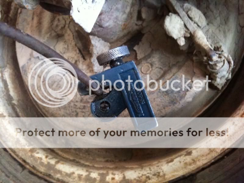

then i cut the bad spot out
B4 you do ANYTHING ELSE slide the new fitting over the line. if not you will get the flare on and it will be perfect and you get to cut it off and so it again lol.

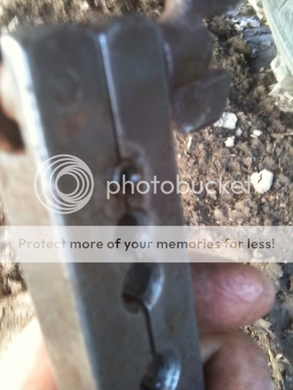

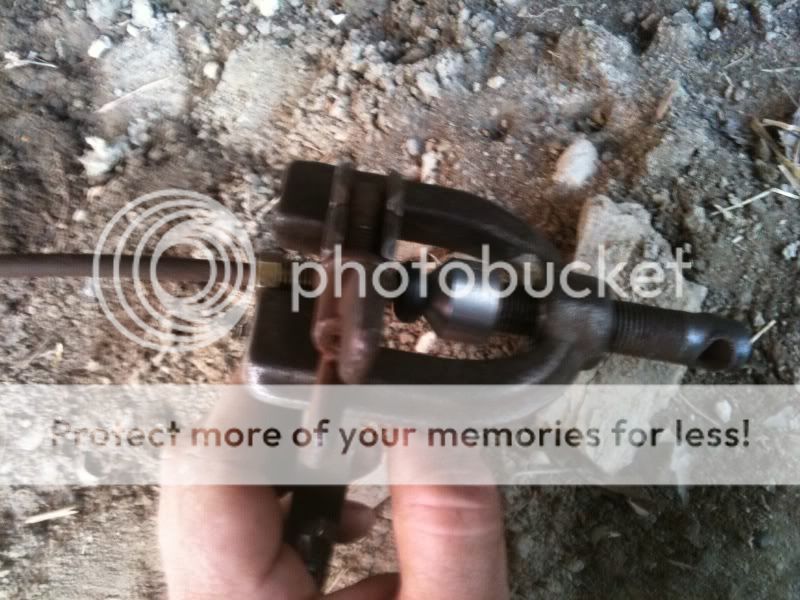

next i cleaned the inside out making sure that the 3/16 flare die (whatever i dont know the technical name) fits inside the line, then clamp the line making sure that it sticks out the same as the width on the wide flat part of the die.
take the press and with the die in the line. (MAKE SURE ITS STRAIGHT) sqiush it down until the die hits the clamp.

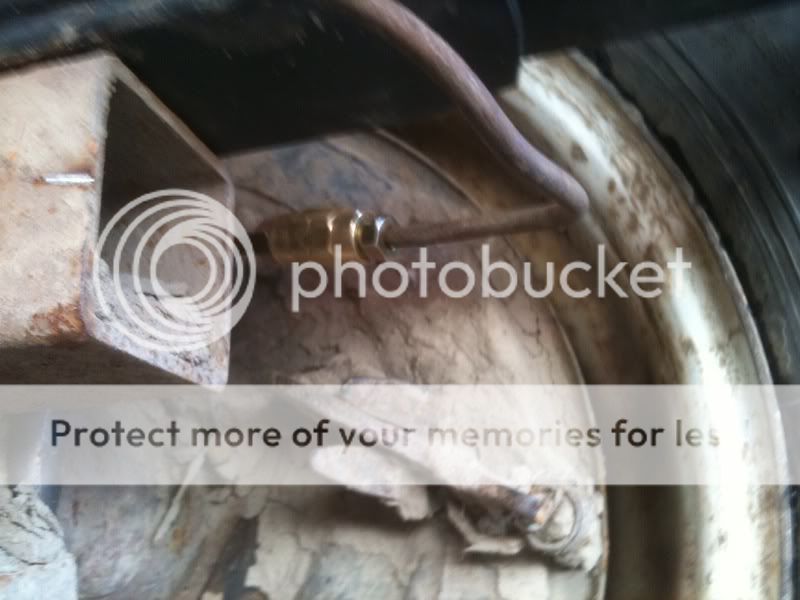

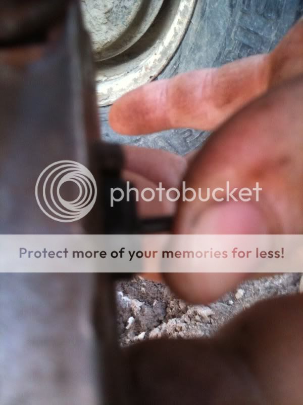

then remove the die and the line should look like this
then press the clamp down on its own into the line to get the double flare you need. dont go too far with it though.
then repeat this prcess all over again on the other line if needed ( mine was in the middle of a line. so i had 3 connectors 2 males and a double sided female connector)
tighten it all back up and bleed the system. mine leaked a bit so i just snugged my fittings up and done! no leaks
i probally coulda got away with a compression fitting. but considering the bouncing around this thing does and the mud and all that i figured id do it properly. plus it'll help when i go to the yota axles i can just change the last bit of the lines to work with the toyota wheel cylinders.

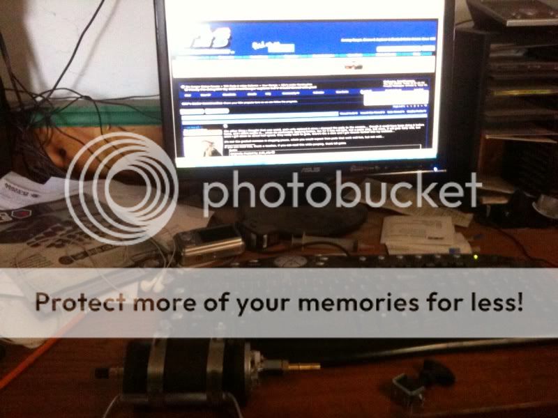

my fuel pump should be here tommorow or tuesday now i just have to clean this up....

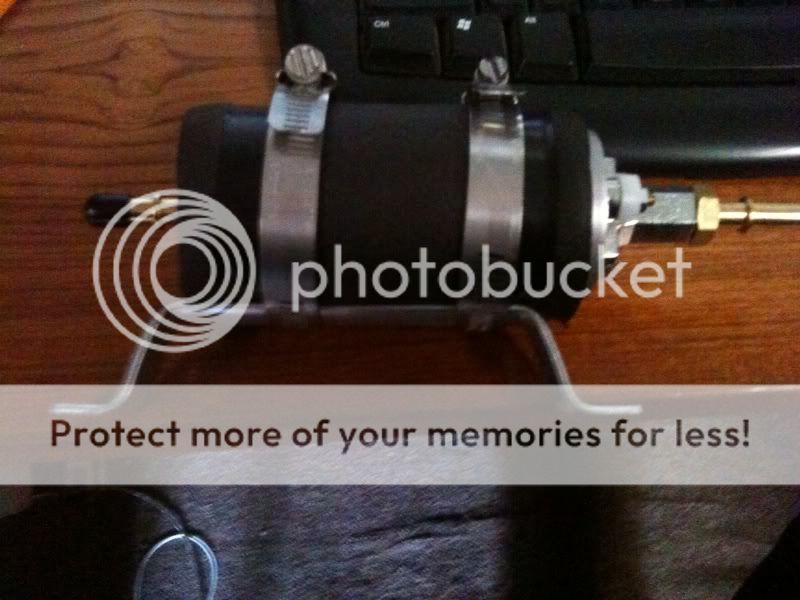

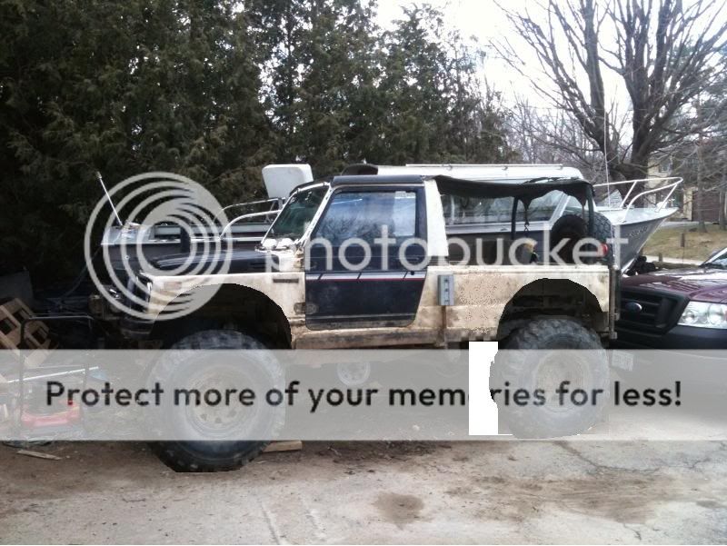

and heres the pics from yesterday and a startup video cause i can
it was weird i think they shipped the pump with gas in it. i dunno why i just figured that wouldnt be allowed and it was

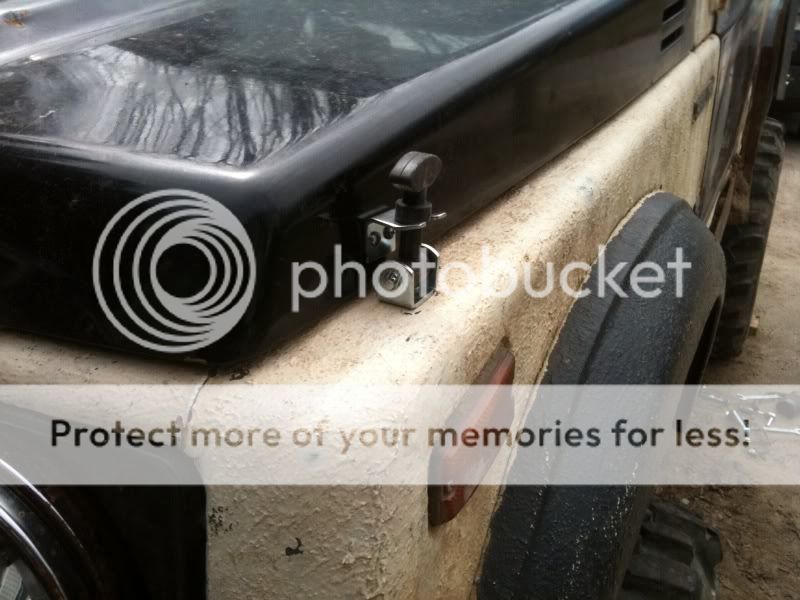

hood latch installed

alright. so this morning i go out to start up the truck after the jb weld has set. you know maybe take a rip around the block head up to the reforestration a few minutes from here just to screw around and guess what
the thing doesnt friggin run.... :pissedoff::annoyed::pissedoff:
like at all. not even start up and run for 5 seconds like b4. im getting so damn tired of this. i dont get it the damn thing ran when i parked it. then over the winter the fuel pump randomly died now it has a new one. and it ran kinda.... but was getting air in the lines, and would shut off after a bit. now i sealed the lines theres no leak and it doesnt start at all. wtf
so... i have 2 choices use my extra tank i have for a carbureted samurai that i can swap in but that means i have to drain the tank AGAIN and drop it then swap everything over.
or! i can drop this tank which means i still have to drain it and all that and make a new top plate for my pickup.
im thinking of going the second route because i was told that my sj has a fuel leak so i wanted to use my spare tank for that.
but to figure this out what im gonna do is take some fuel line and go from the pump to a jerry can instead of the gas tank that way i can see if the tank is the problem. problem with that is i need $ to get gas.... so im gonna have to wait till tuesday....:annoyed:
