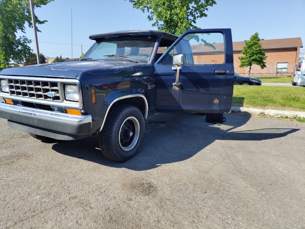

A few weeks ago I started searching for a car or truck and I came across a few that caught my attention but not as much as this 1988 Ford Ranger XLT
Being in Canada it's impossible to find a truck or any used car in such a good shape rust wise, usually there would be holes in the Frame or body ...
It turns on even though it grinds when you start it, the clutch that is dead and the headers clearly leak nothing that can't be fixed. I just love it, ordered the parts and all got them already but can't work on it yet because of the dumb paperwork (stupid bureaucracy and taxes) I'll be taxed on the price of the evaluation of what it's worth and not the price I bought it from.. :/
It's my first ever vehicle and I hope to keep it till I die 🤞

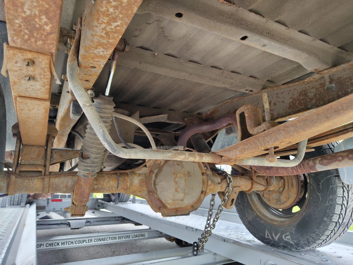

Probably the best example of a well taken care truck in years, some abuse here and there but still taken care of. I'll try to take care of it even more starting with the mechanical parts that need to be fixed and then remove the bed and body to undercoat it and also coat the frame/ everything thats bare metal
Feels like never ending bureaucracy and taxes lol, can't take away the fun though!
Use something like fluid film.. no rubber in a can stuff.
well I was thinking doing a raptor liner or some other thicker coating that wont chip from rocks and stuff
The only problem with that is unless the prep is perfect, any cut through will lead to major rust behind the liner.
Fluid film is lanolin, made from sheep's skin. It will flow back into the cut. Downside is it needs yearly reapplied. But after the first time only reapplied to the exposed areas.
I work in a industrial paintshop and we have a sandblasting room so getting rid of 99% of the rust should be fairly easy but would have to take the whole car appart for that. Maybe Fluid film would be a better tamporary option?

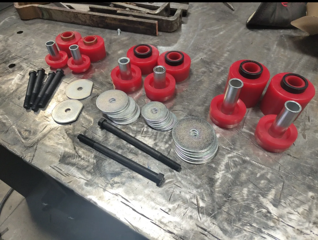

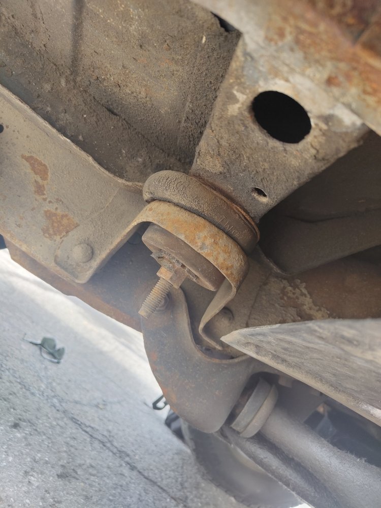

Front driver side body mount is totally shot gonna install the new body mount kit this weekend and do some fab work for that mount.
Rubber feels like Marshmallow lmfao. The new ones are polyurethane so they should hold up wayyyyy better and I'm also getting an inch or 2 of lift so that's a win win situation
