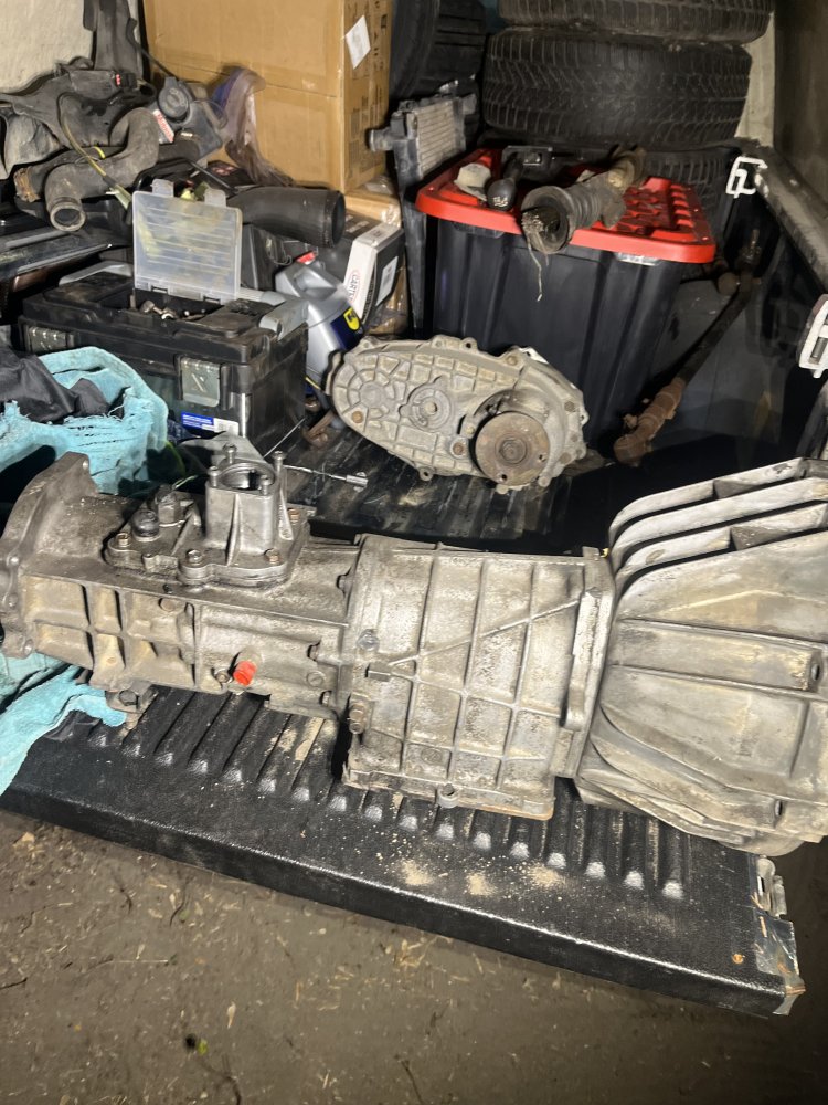

weird they all seem to be identical too, I guess I'll have to find the bell housing or another tranny that'll fit it 🤷‍♂️
It would have to be the whole transmission. The bell housing is all one piece with the transmission body on the Mazda manual transmissions.

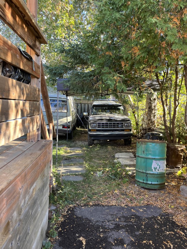

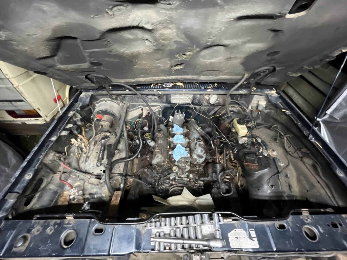

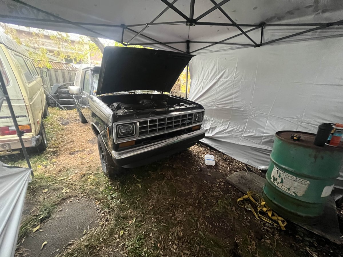

Finally moving forward on my ranger, had to rearrange the way it was but now it's sat in the backyard and improvised a garage with a small 10x10 canopy instead of the big 10x20 carport I bought a couple months back but due to the van being wayyy too close decided not to. Been wrenching at it for the past few days removed the intake manifold, fuel rail and injectors, air filter box/hose, radiator, power steering pump, alternator and front grille/headlights.
The wiring harness is a mess most plugs are done broken clips or just missing altogether( soldered ) but other than that no broken bolts, just missing a couple bolts on the valve covers or miss matched bolts.
trying to stay as organized as possible with the smaller stuff and putting bolts back where they go for now, also already want to start cleaning up all that grease, oil and dirt but want to try the hot tank method to clean it ( what the green barrel is for)

Gotta do what you gotta do when you don’t have a garage, I’ll most likely also get a space heater before it starts to get freezing but first removing the engine and tranny then back it up and possibly remove the axle. To be determined if winter comes early or not haha
got the good ol’2.9 out on monday and filled the bed with parts and tires, no more room in there after stuffing the transfer case and tranny.

the cold I don't mind it too much it's more the elements that's bothering me especially the winds making the sides of the canopy slap my ass while working on the engine 😂
I am on page 5 of your build. On page 2 you asked what that box was for. If I am understanding the question correctly, it is the Charcoal Canister. You have a vacuum line coming from the fuel tank to the canister. From the canister you have another line running up to your Plenum. It is just emission stuff. All it does is keep fumes from getting to the atmosphere and eventually draws them into the engine.
