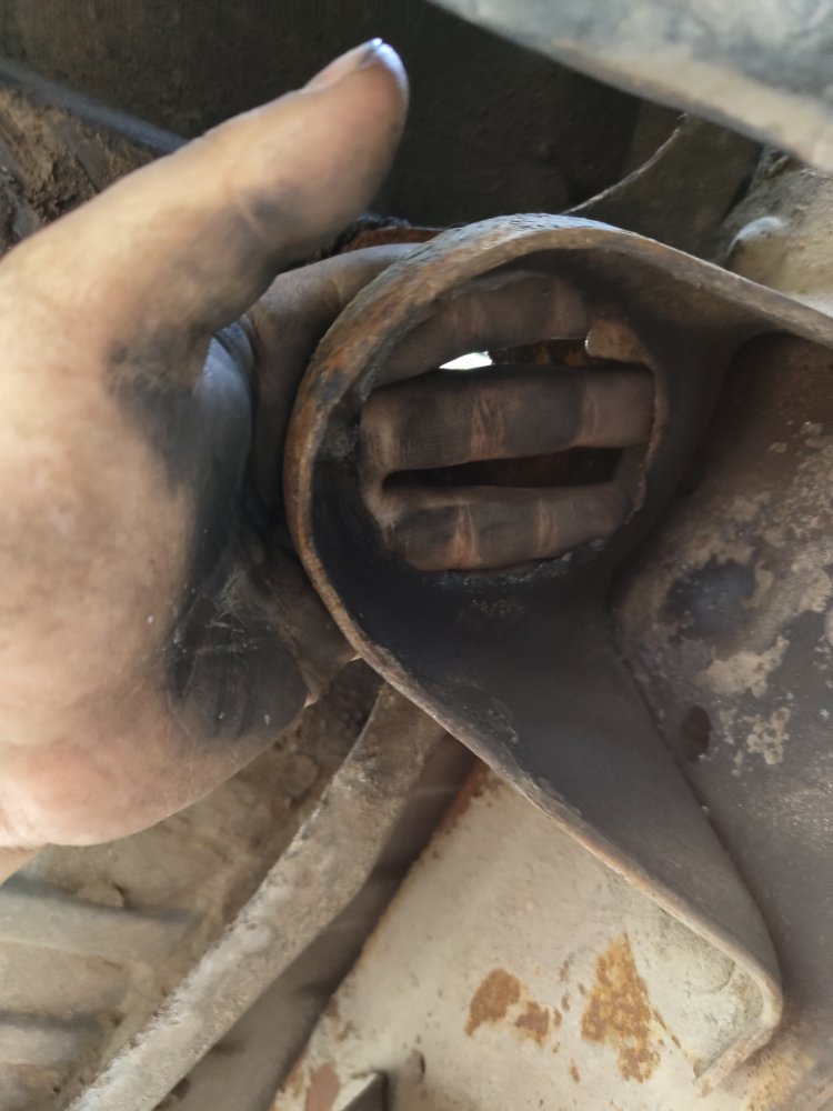

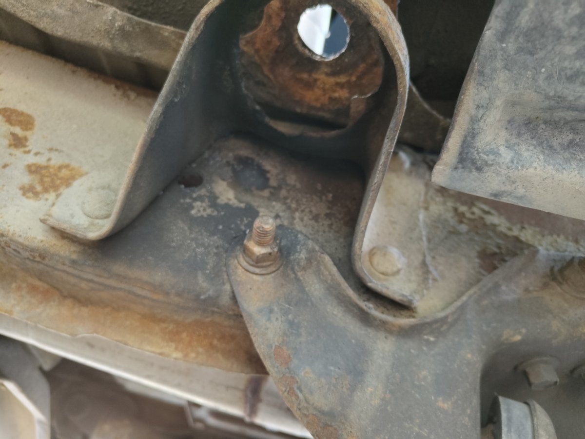

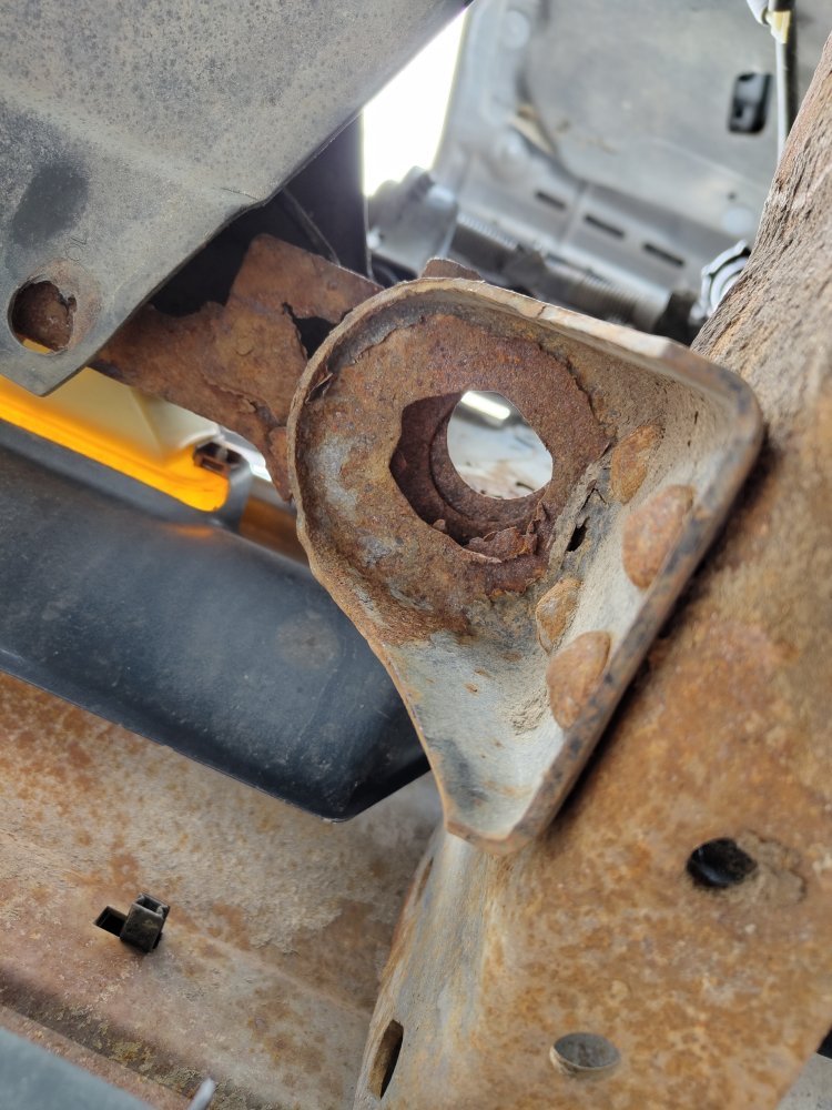

**** me the hole is bigger than I thought I would be, not sure if I should make a plate weld it or have a new mount rad side is top shape but the frame side oof not sure.

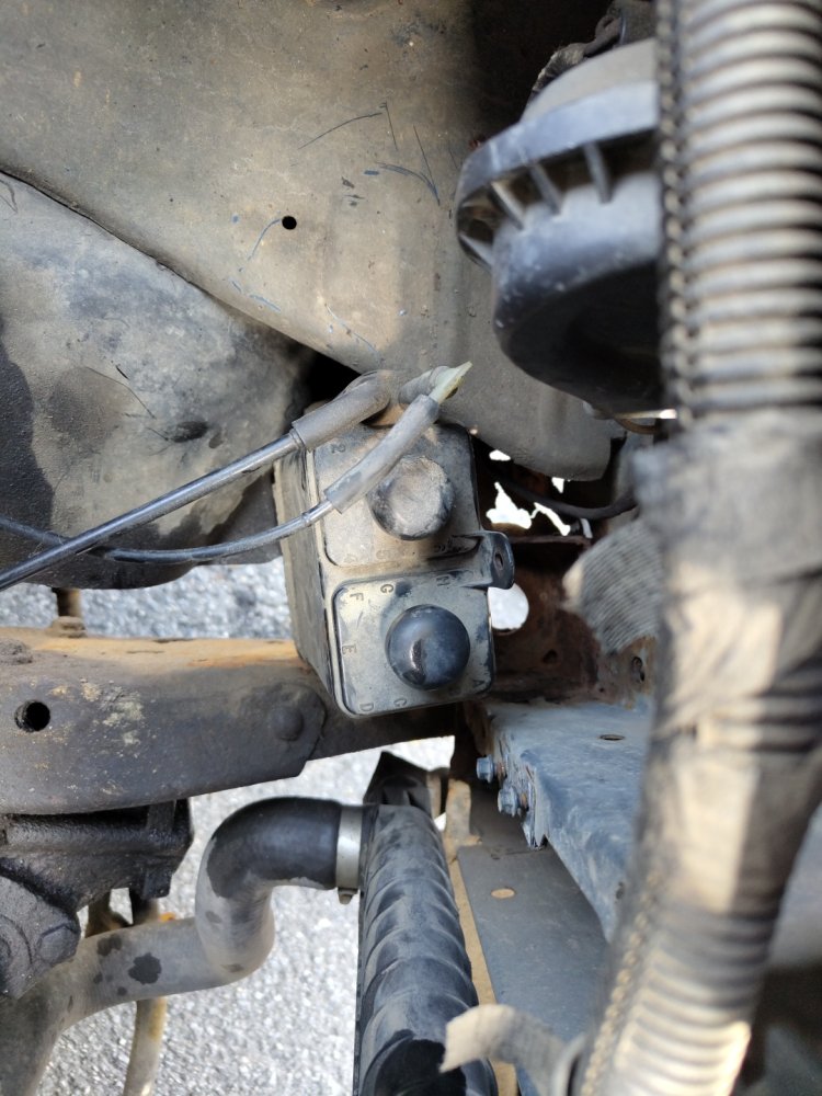

Also what is the box with 2 lines for? Looks like it goes to the throttle body. Is it a fuel prep of somesort or reservoir ?
That box is something I never figured out or knew how to hook it up
Yeah it's the weirdest, only 2 tiny hoes going to it and 2 caps on top. Kinda want to take it out and open it..

God have Mercy that is a veryyyyy wore out cab mount only had time to take 3 out of 6 mounts but I'm gonna assume the rest also looks like this. So now I'm considering making 6 hole new brakets from slightly thicker steel...

Well the Frame is top shape just places where there are moving parts it's pretty much dead, bushings/ rubber also almost all shot, to be replaced. If I had the place to take it apart I would do it for sure.
A large washer welded in works.
The box is a charcoal canister for emissions.
pretty hard to find that big of a washer lol or at least that aren't like 50$ a piece , I have some scrap plates big enough at work that should work with the help of a lathe or hole saw. thanks for the answer for the charcoal canister btw.
