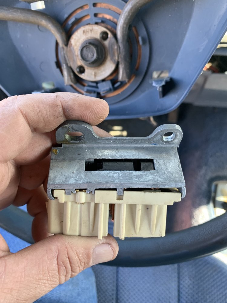

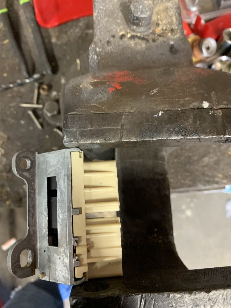

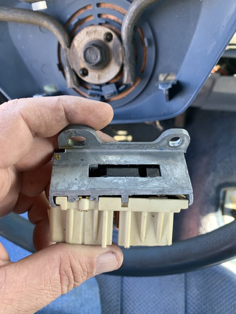

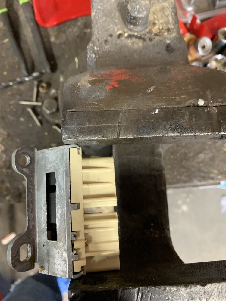

Ignition switch is a common problem on our trucks, there is a metal piece clipped onto a plastic piece and there are several little metal fingers that hold the plastic piece in place. Over time these bend and cause the switch to come apart. You can clamp it back together in a vise and bend the fingers back to fix it. I've had this happen several times.

My Ignition Switch was bad. So I just replaced it. Once I got it out I could see the end piece just needed to be put in the vice and tightened up. I still installed a new switch and now have a spare.View attachment 106649
From my thread and one issue same as you dealing with.
