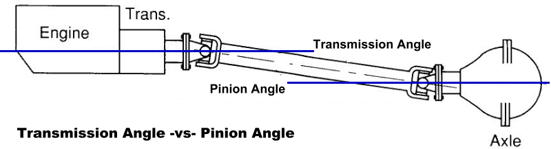

Ok I got the d44 out of the wagoneer with axle over springs.. I'm having a brain fart on mounting it to set my caster and pinion angles.
Do I need to have the entire tire sitting level and just hang it under there and build mounts or am I just over thinking it and it's that simple.. i did it before but that was a few years ago. Just an opinion would be nice from some else just to give me the kick I need.. also shackle out front or cab side when doing that?

You'll need the truck sitting level yes. I believe that is what you were asking.
The caster should be a positive 4-5 degrees and your pinion angle needs to match whatever angle is on the output of the transfercase if you are running a regular driveshaft.

I'm planning on using the double cardian u joint off the ranger originally.. and positive is leaned back correct?

I don't remember positive from negative but you want the opposite caster from a shopping cart.

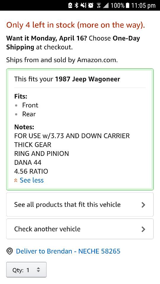

Wise axle gurus my axles I bought are 87 jeep wagoneer d44s low pinion they are like 3.07 ratio I think when looking for different gears will any low pinion d44 gears work in it or do I need specific for that vehicle I know they are common and liked for a reason so I'm hoping simple and common makes them easy to find

Dana 44 is dana 44, the only thing that changes is that there's 2 carriers. one for 3.73 and under and a different one for 3.90 and above.
Yeah they are low pinion first generation.
