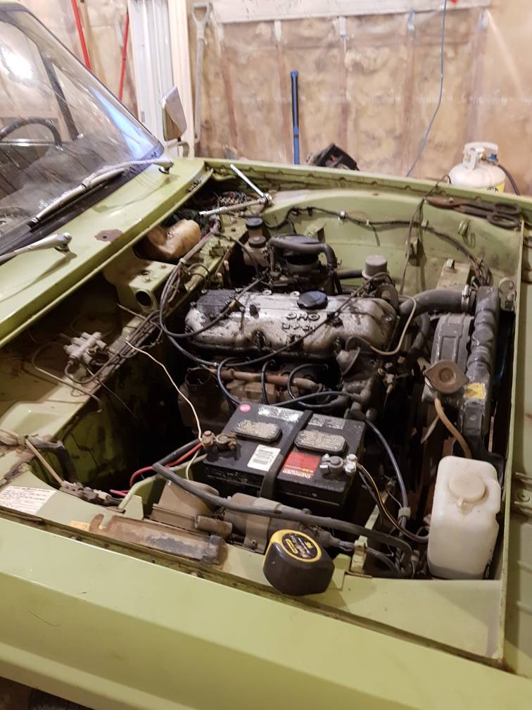

There it is in the garage hope to start tearing down this week.. needs to be in the garage to warm the steel up and I can start the stripping on it.. I hope I can get the motor brought in before Christmas but we will see.

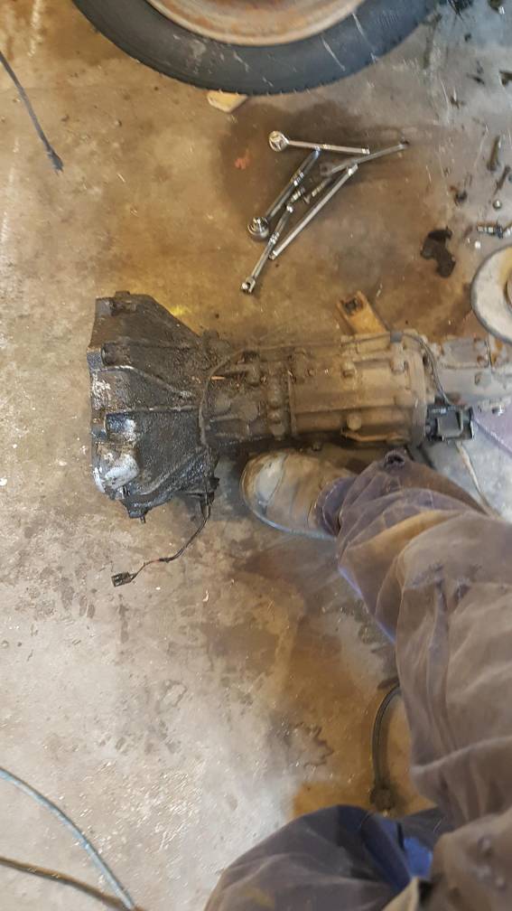

Tiny transmission on the old courier. I got the trans out and everything stripped to get the motor out don't have all my tools in the garage yet from moving need to grab a chain to hook on the motor and yank it. After that I just want to clean the 45 years of oil and grease off the truck before doing any building again.. told my wife I wouldn't do much right away but I'm hooked already lol I'll have the new motor hanging in there soon
