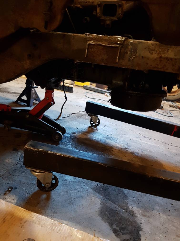

Found some time to run to the shop and fold up some steel going to [ ] the frame and weld the cross member to the channels and then just spot weld it in a few places to the frame to avoid stressing the frame to much in that area.
Now that I have a plan can get to some of it tomorrow hopefully can have some good progress here this week. That doesn't involve hours of grinding and sweeping!
I have basically everything made for motor mounts already just need to size up and fit.. transmission mount will be really straight forward.
Sent from my SM-G930W8 using Tapatalk
Finally got enough frame notched out and got it low enough to sit in its finally resting place..
I tacked he cross member in with my flux core welder (man do i dislike those machines) and got it set up for welding solid.. I need to rent a bottle or maybe snag one from work for a weekend and weld it all up so I can continue..

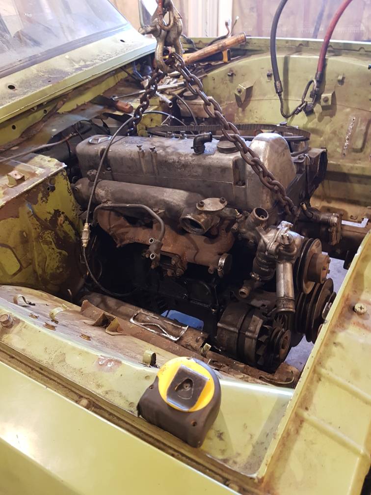

Well i have no pictures atm but motor and trans are mounted the trans mount is completed then motor mount is welded enough to hold motors weight but need to pull motor out and finish up welding the ears.
My alternator tightens up so that problem is solved.. I need to cope out just a bit for my primer pump to my injection pump but that's a small detail. I also need to cope the trans mount just a bit where the shaft goes to the front diff.. I have a bw1350 transfer case with the slip in the case.. would like to get a manual 1354 to have the slip in the shaft instead but have to see if I come across one.
