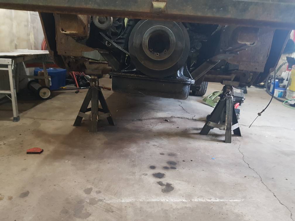

I have made a set of tall jack stands got material cut for second set just need to weld them together but they are 18" at the lowest setting so I can level my truck out. Hope in the next month I can have axles slung under truck and mount them. I'm adding a tool room and fixing the roof on the garage so will make work space bigger with less clutter in there.

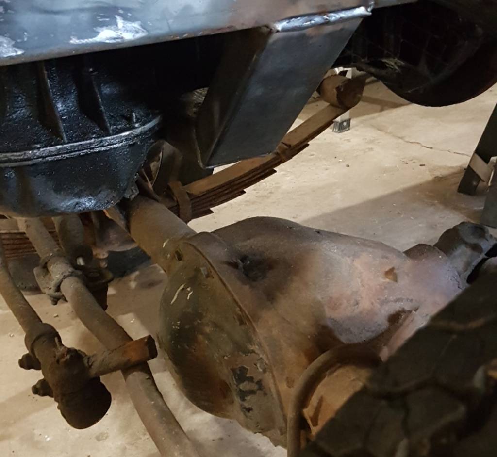

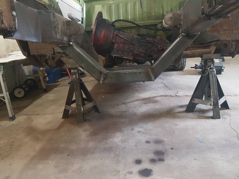

Went out busted out the plum Bob's, tape measure, and a square started measuring out for my front diff. And found that the crossmember I built will give me issues.. I welded it in but didn't gusset like crazy so crappy but not bad. I fabbed up a new one and in my opinion it will look better anyways. Little progress but still progress.. the weather is turning so garage season is upon us so woo! I hope to start having regular updates and progress.

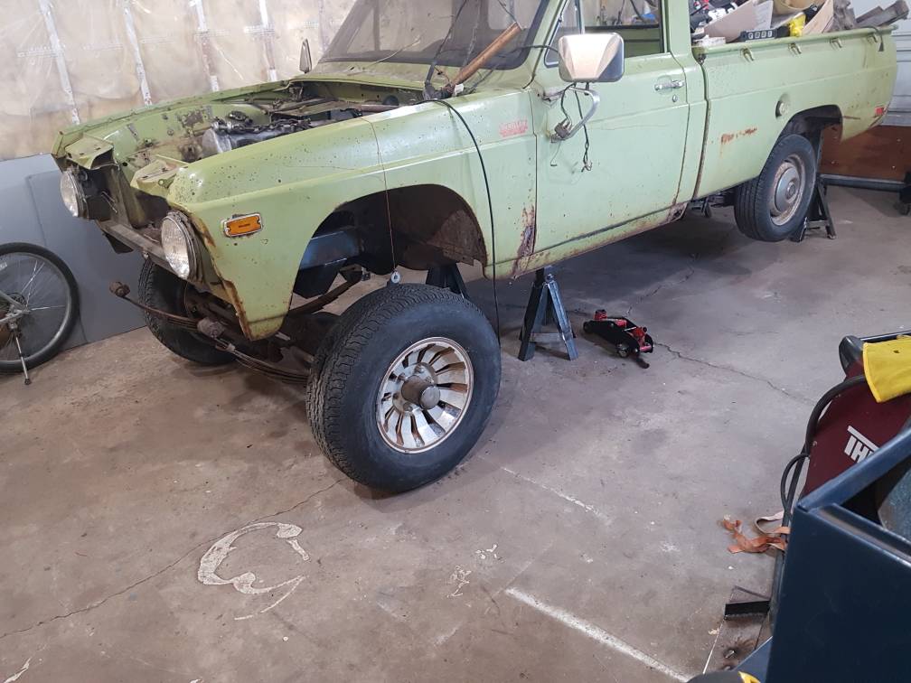

Well I finally did something worth showing and not just blabbering about my side projects.
So I pulled the motor out and cut the first crossmember out. Fit the new one up welded it in place.

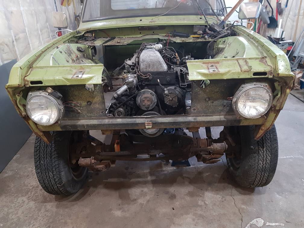

I cut the rest of the firewall out and it make good clearance and actually made the rebuild job less scary looking. Will come back to that job later.

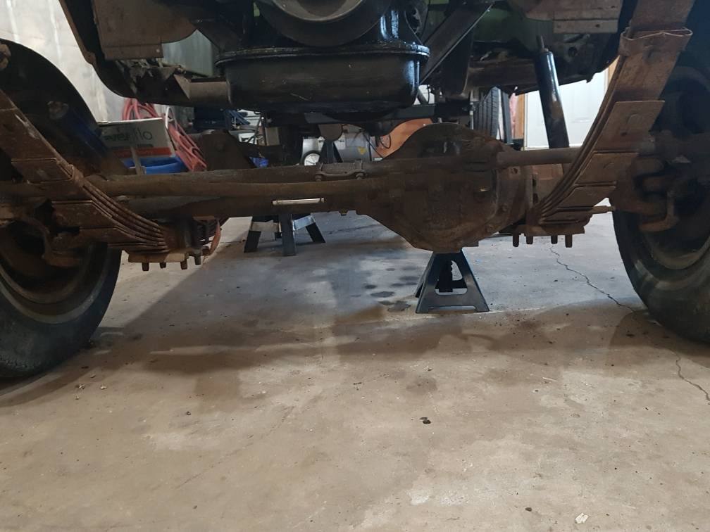

I drug the axle in and sort of placed it where it needs to go. Upon looking at it I guess I'm going lifted and big tires to fill up wheel wells.
Also the leaf springs I got that are off a 87 wagoneer one they are sagged out of shape. Two they have no lift to them and three the guy i got them off of hit the eyelet with the torch so no good. I'm thinking maybe getting a set of jeep yj leafs eith a good lift to them. Unless someone's got a good idea of another good common leaf.
