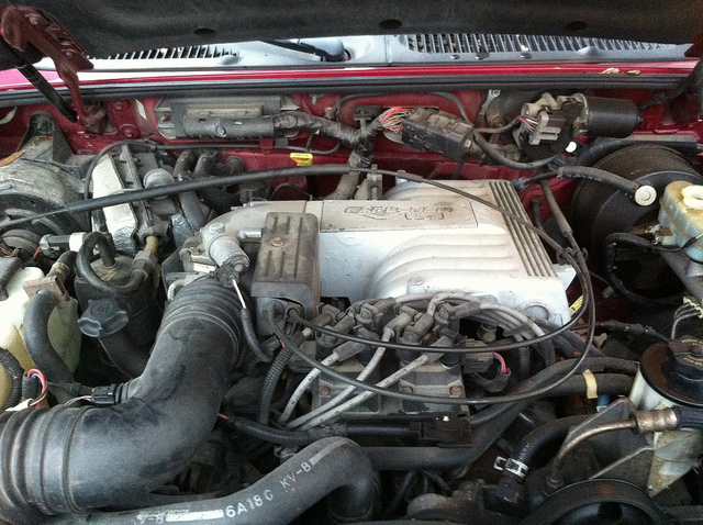

Here is a better pic of the donor power plant.
