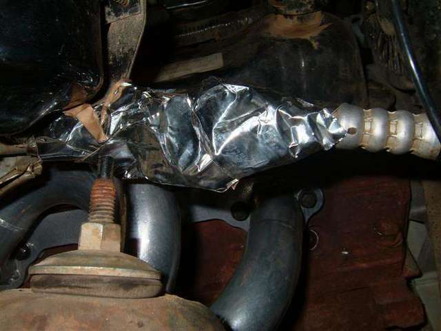

Here is how someone got a nice set of Mustang headers to work on his coil spring front end. He had to raise the motor 1 1/2-2" to clear the motor mount and then the tubes got in the way of the steering shaft. Said it took $350 worth of joints, support bearing and new shaft to clear.
05 Edge V8 Swap
05 Edge V8 Swap

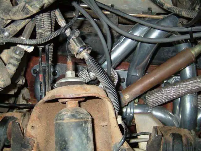

Picture showing someone trying to fit some custom headers for a 351 into a late model.
05 Edge V8 Swap

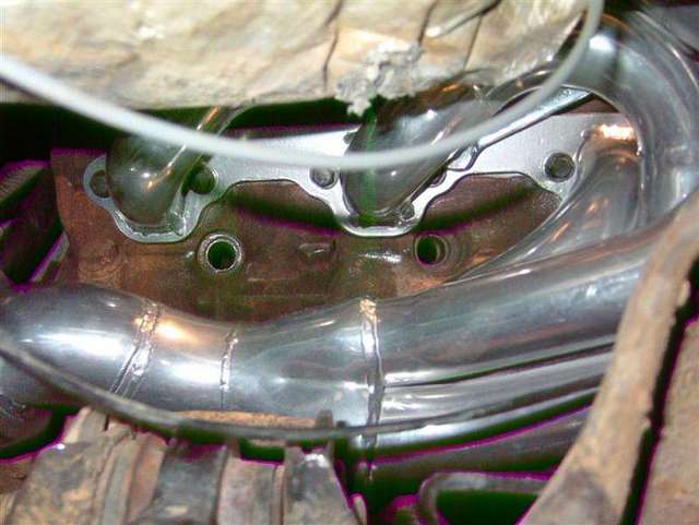

Stock passenger side
05 Edge V8 Swap
Drivers side
05 Edge V8 Swap
