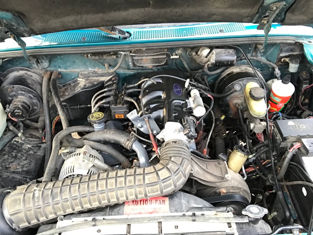

4.0 in my Ranger after new gaskets and converting it to '93 engine management.

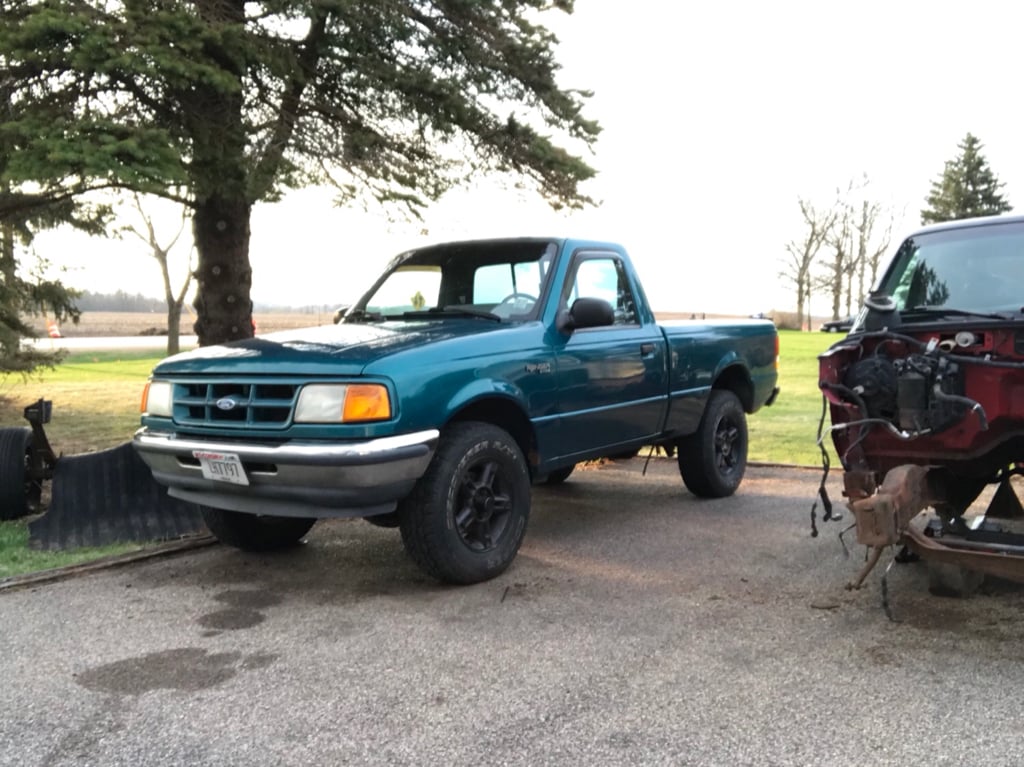

Not much new with the truck. Core support finally gave up the ghost. Not sure if I want to build one or buy a replacement.

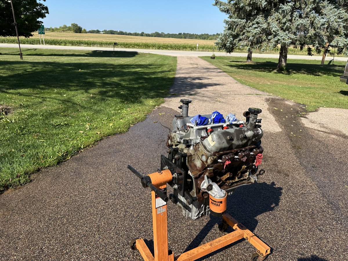

I did pick up another 4.0 for it. At 285,000, the engine in the truck now is showing its miles. Visibly burning oil and the valve train clatters pretty bad when it’s cold.
Just under 150,000 on this one.

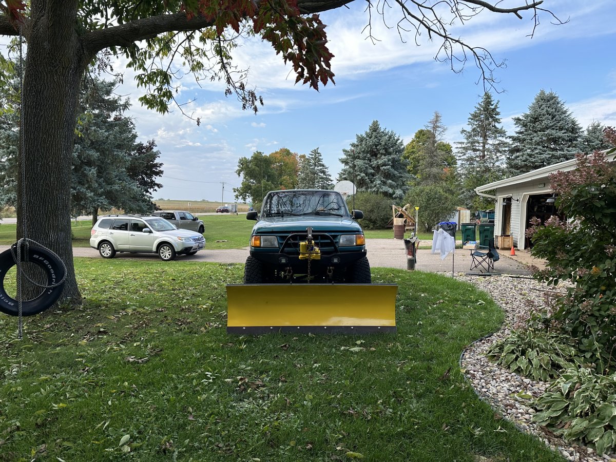

I picked up an old Meyer ST 7.5 snow plow for it as well.
The plow was rough but for $100, I can work with it.

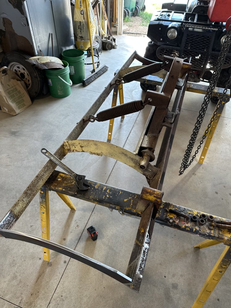

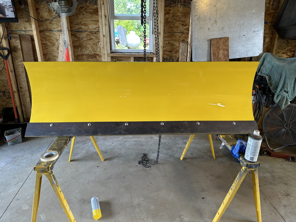

Proceeded to cut the mold board off and narrow the blade to 6.5 feet wide.
The outer most ribs were rotted through and pretty thin overall so I had some new pieces cut from 5/16” plate.

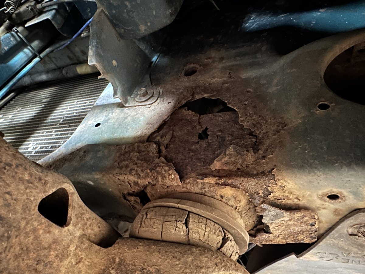

When I started measuring everything, I noticed the front of the truck looks like it’s leaning to one side even though the frame measurements indicate it leans the opposite direction exactly one inch (Ranger lean). That’s when I realized my core support is roached.
Rubber body mounts are finally shot also.

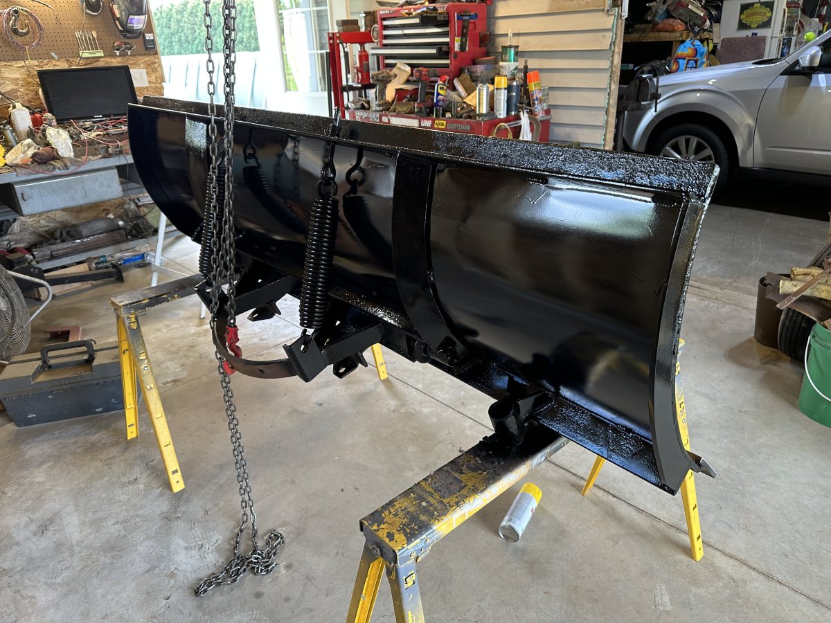

Rebuilt the pump in the meantime as well. Had to re-solder the wires back on a couple coils but everything functions. New decals even.

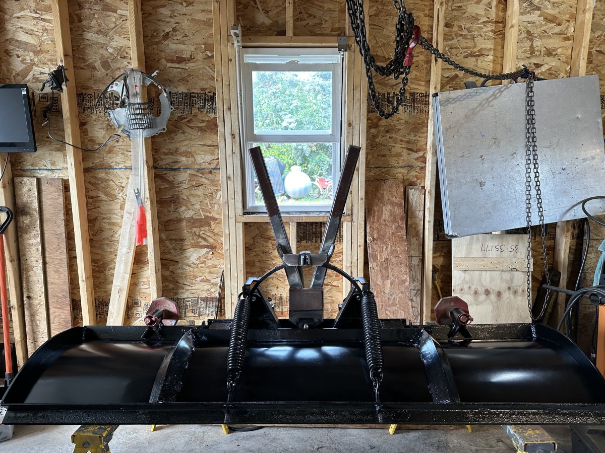

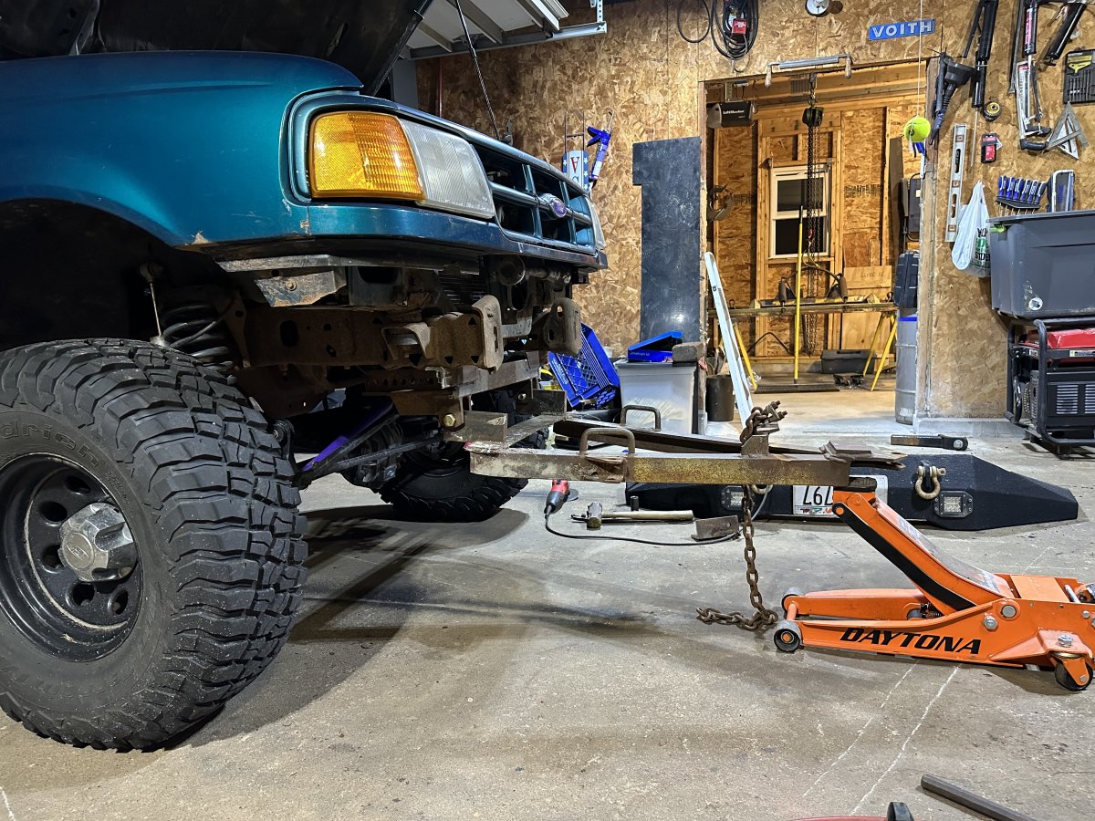

Made some progress on the plow setup. I think I’m roughly 30 hours in with lots of distractions. Probably burned up a 5lb box of 7014.

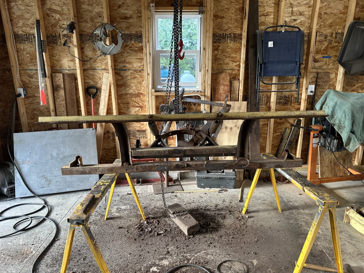

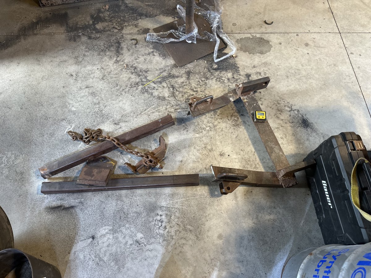

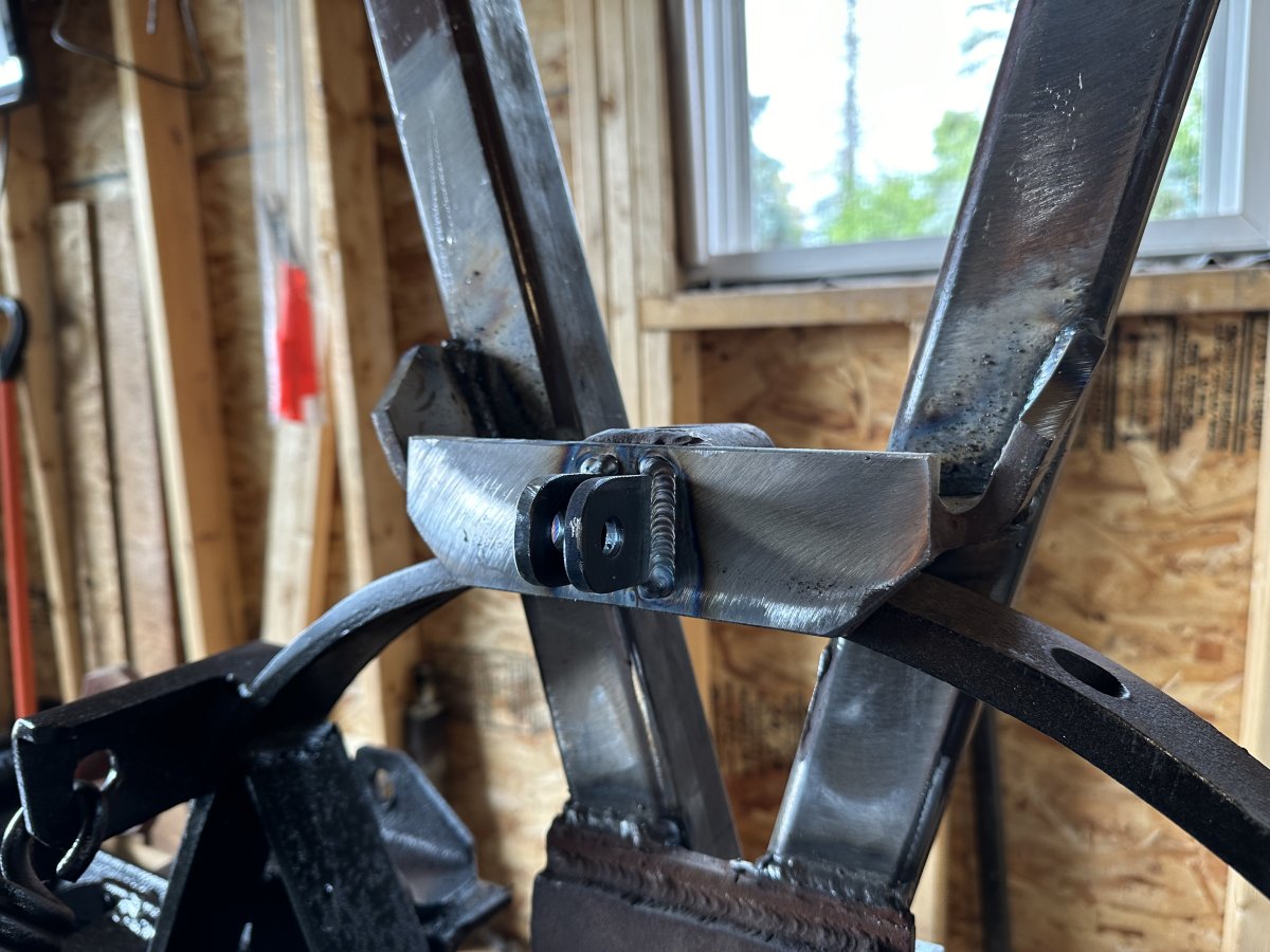

Decided to almost completely rebuild the push frame. It was bent the hard way and all attempts to straighten it out failed.
About half way done. I went to 2” .187 wall square tube in place of the 3”x3”x.375 angle that was there. It should be stronger and lighter.
Chain broke off at one point so I cut the welded hook (bar)? off and welded tabs on.
Don’t ding me too hard on some of my welds. This project was mostly to teach myself a little more about stick welding. Mistakes have been made and lessons have been learned.
Still have some gusseting to do on the push frame but there it is.

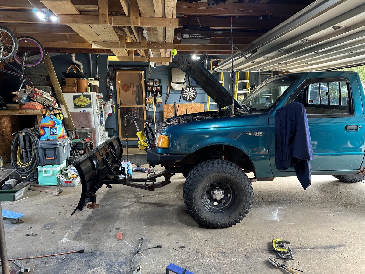

It will have power angle. I need to order new rams yet and move the brackets. The rams that came with the plow were pitted so bad, they would never hold oil.
The biggest struggle is no one makes a mount for these trucks anymore. I’m sure you could call and custom order one.
with the solid axle....it may not unload too bad. may want to double the frame stack on the blade... so the working angle wont just climb and unload.
bit it turned out great.
Thanks. I’m hoping it doesn’t want to drive over the plow too bad. I know the push frame is pretty hokey looking. I already have some plans rolling around in my head to drop the truck side bracket a few more inches. It shouldn’t change my approach angle at all. Front end squats exactly one inch with the full weight of the plow hanging on it.

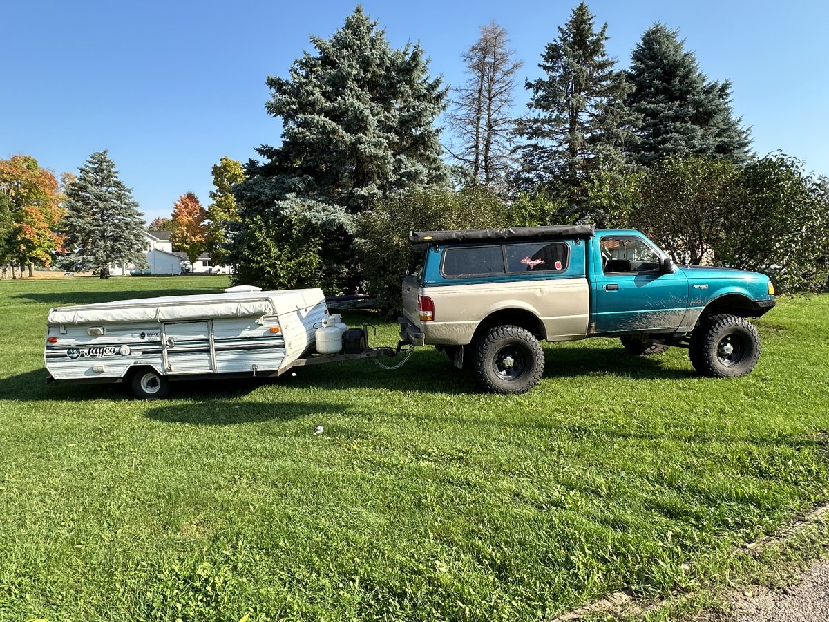

I have total faith in the old Ranger but she’s just not up to par to tow the pop up and haul a bed full of gear that far. The 3.73 gears and 33’s are solely to blame and I’m kicking myself for not doing things right when I build the D30. It’s only saving grace at this point is the hybrid M5OD.
