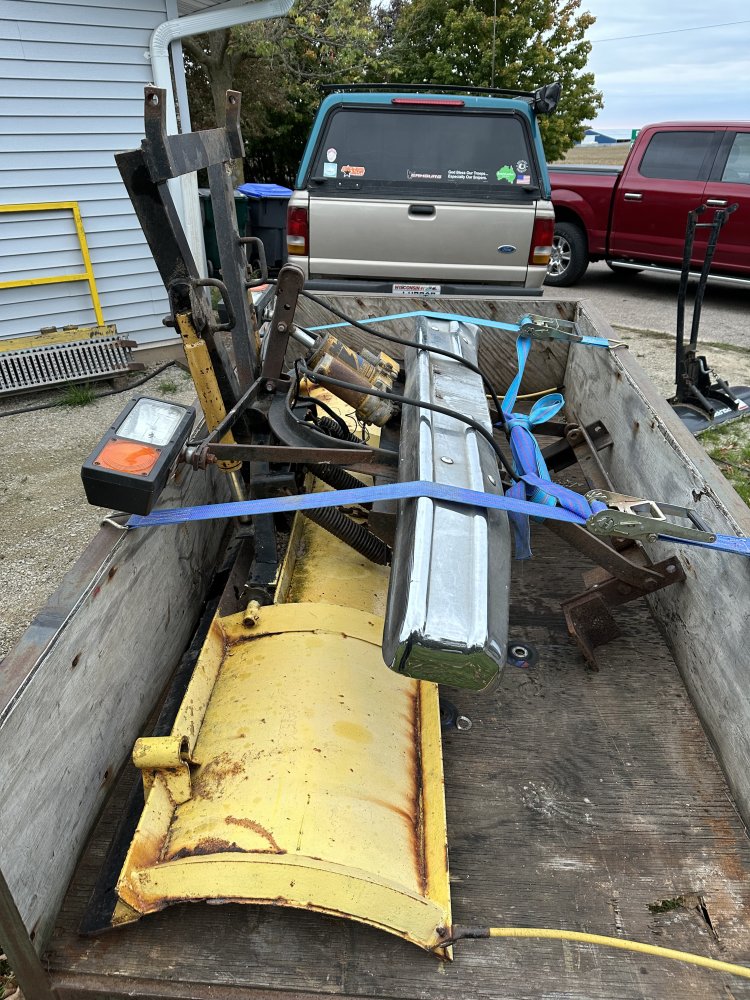

I bought yet another plow. This one is for parts.
‘94 4x4 Swap/Build
I have yet to pay more than $100 for a Meyer plow.

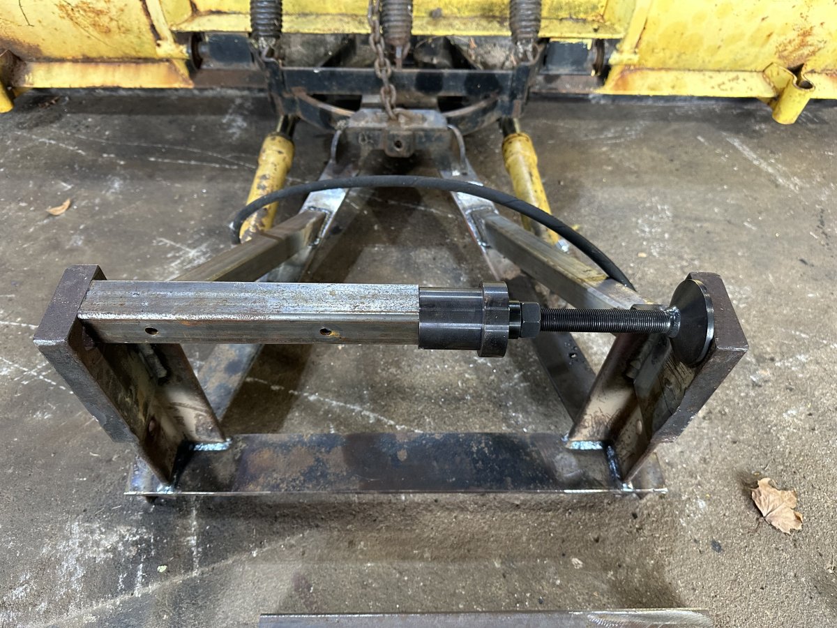

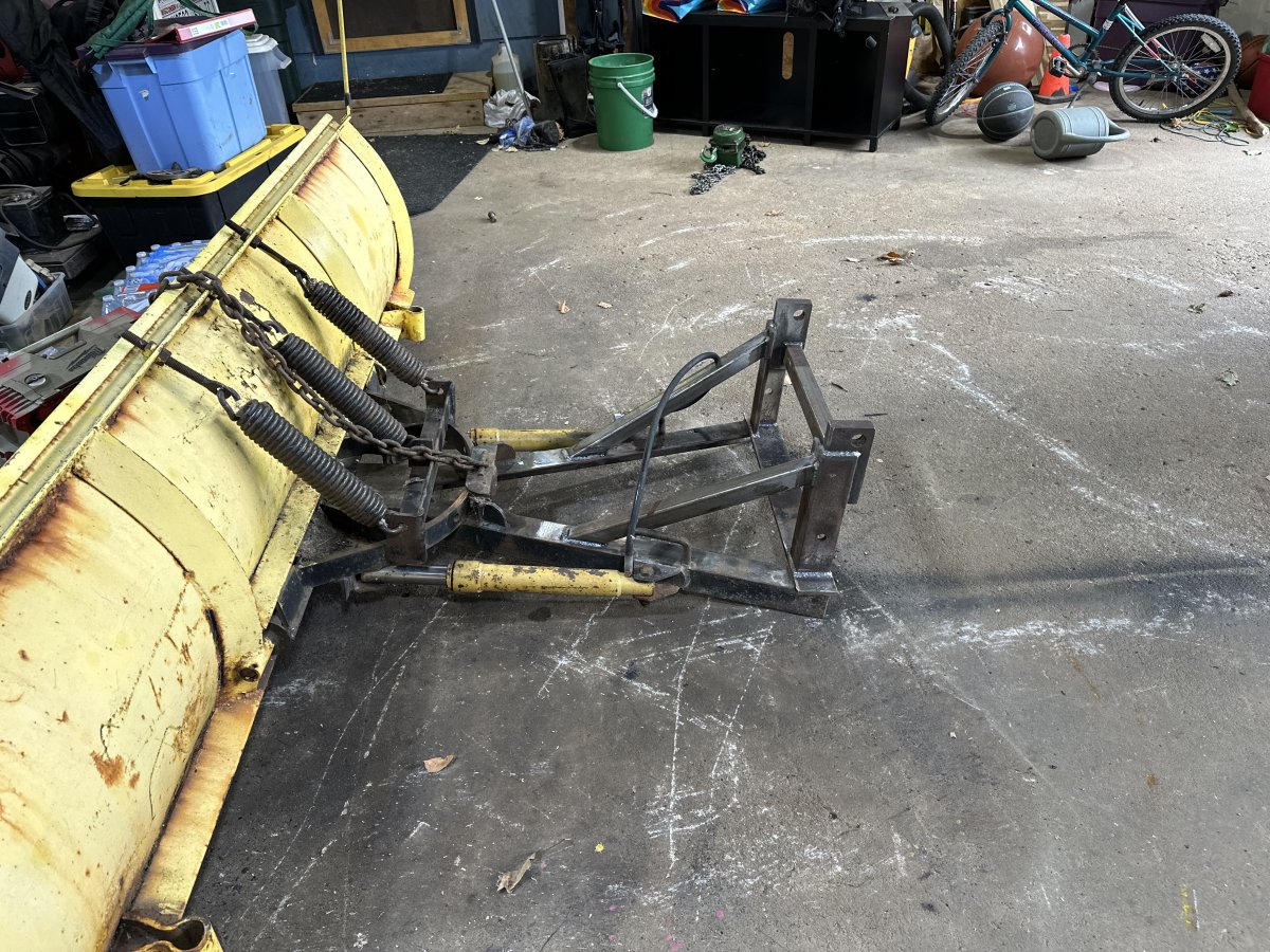

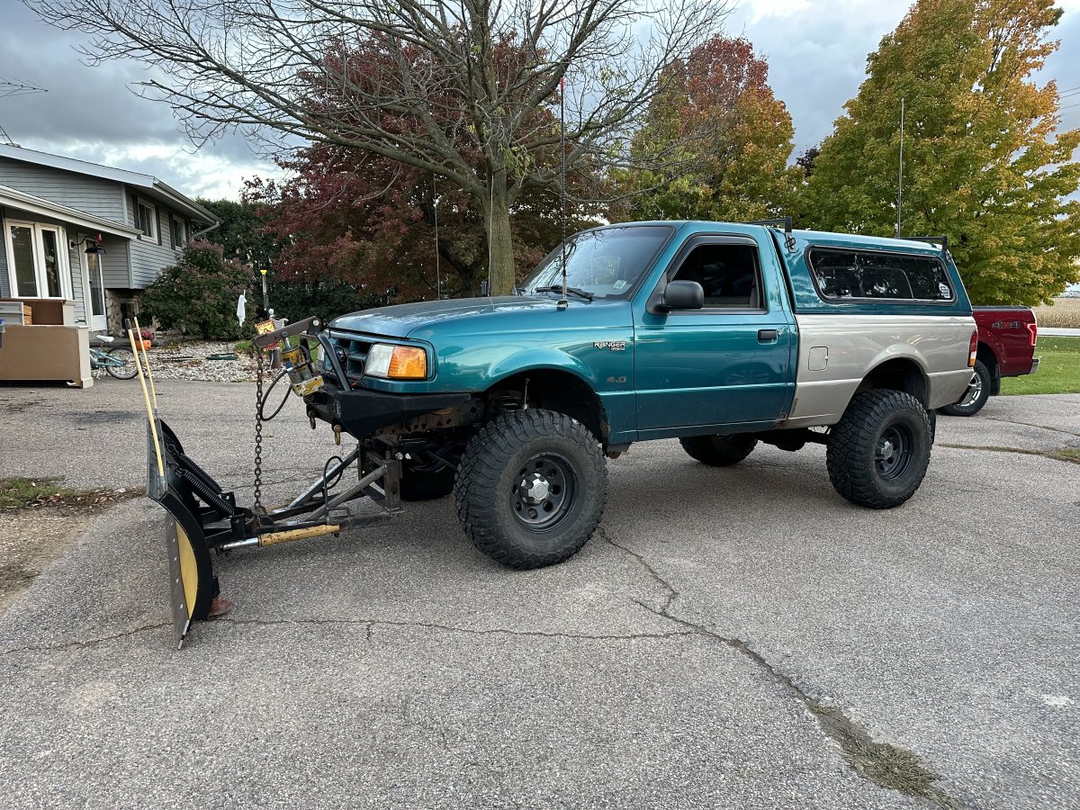

Finished up the the push frame for my plow today. I wasn’t willing to drop the pivot bracket on the truck down any further so I modified the frame from the parts plow to meet it without the crazy angles.
‘94 4x4 Swap/Build
The cross brace between the uprights was an after thought and there was enough weld contraction to pull the pivot blocks in 0.25”. Had to get creative on pushing them back apart.

Just have to wire the controls and wait for snow.

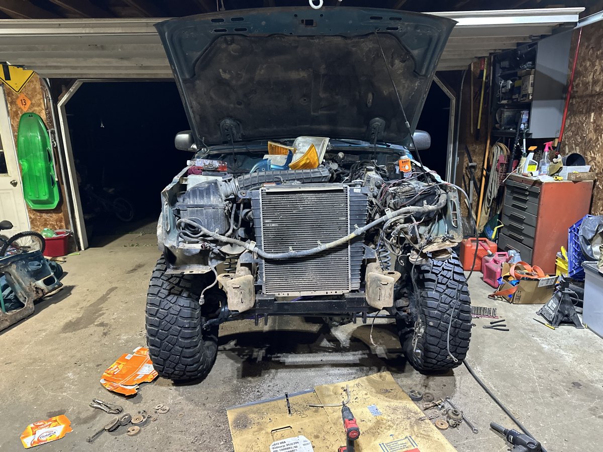

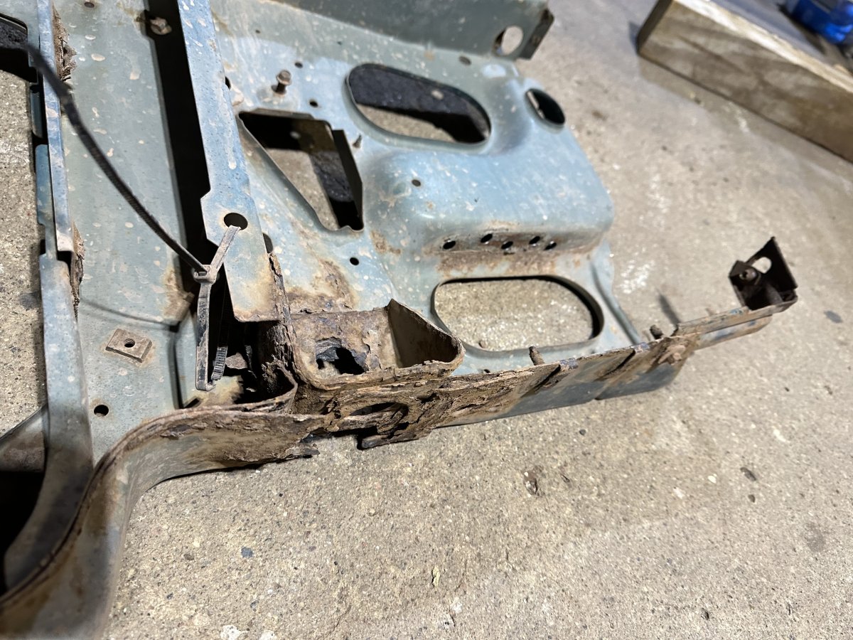

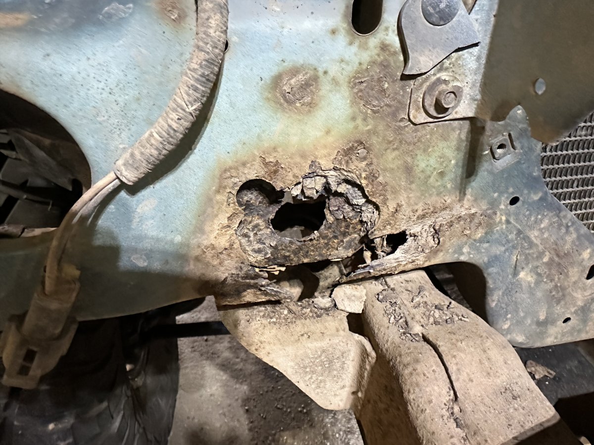

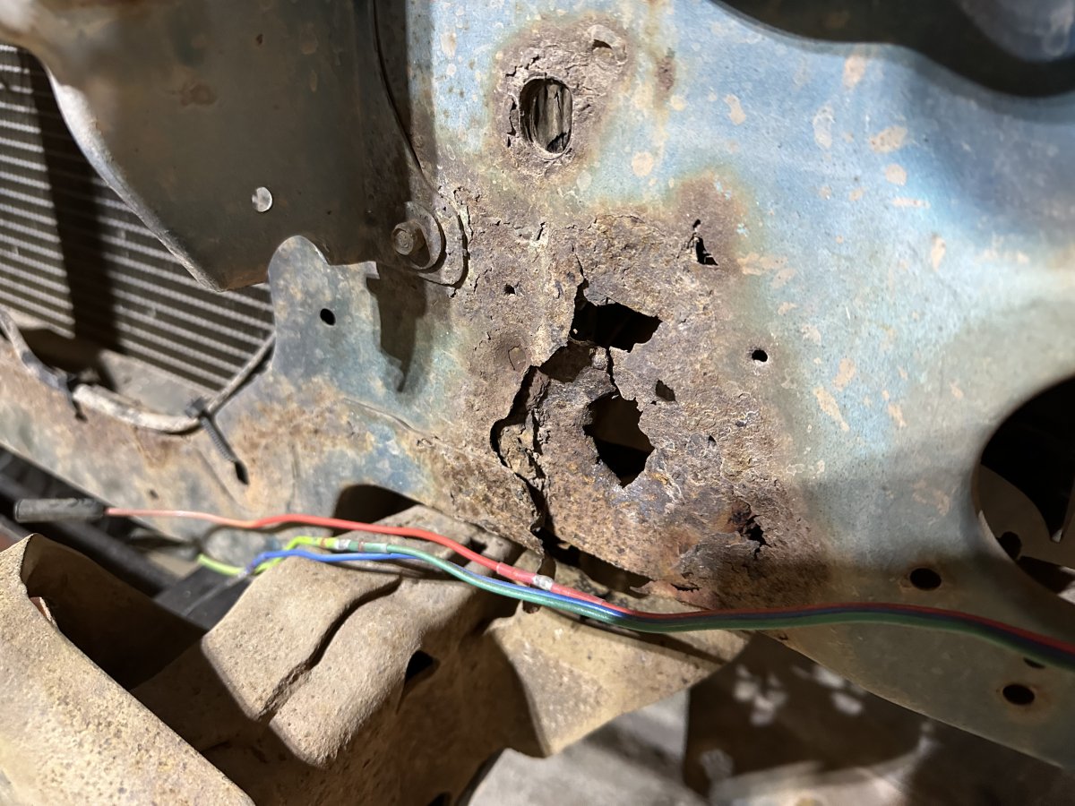

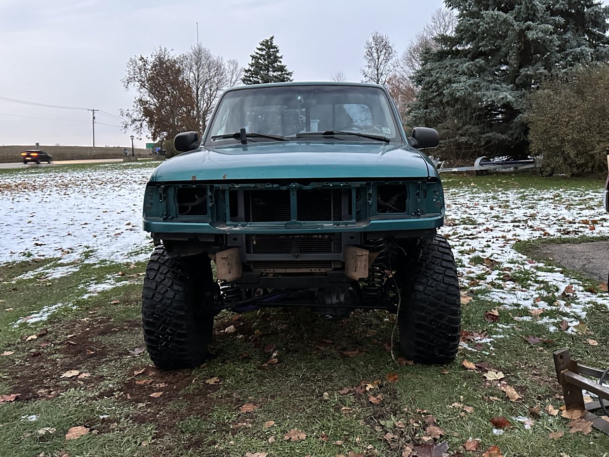

and because why not, I tore the front end off to fix the core support. Unfortunately it’s too far gone to mess with so patching it up is out of the question.

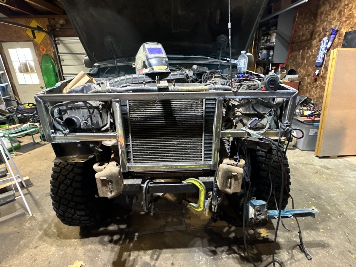

One thing lead to another and I tore the whole front end off. Plan is to build a support out of square tube like PlumCrazy did on his truck.

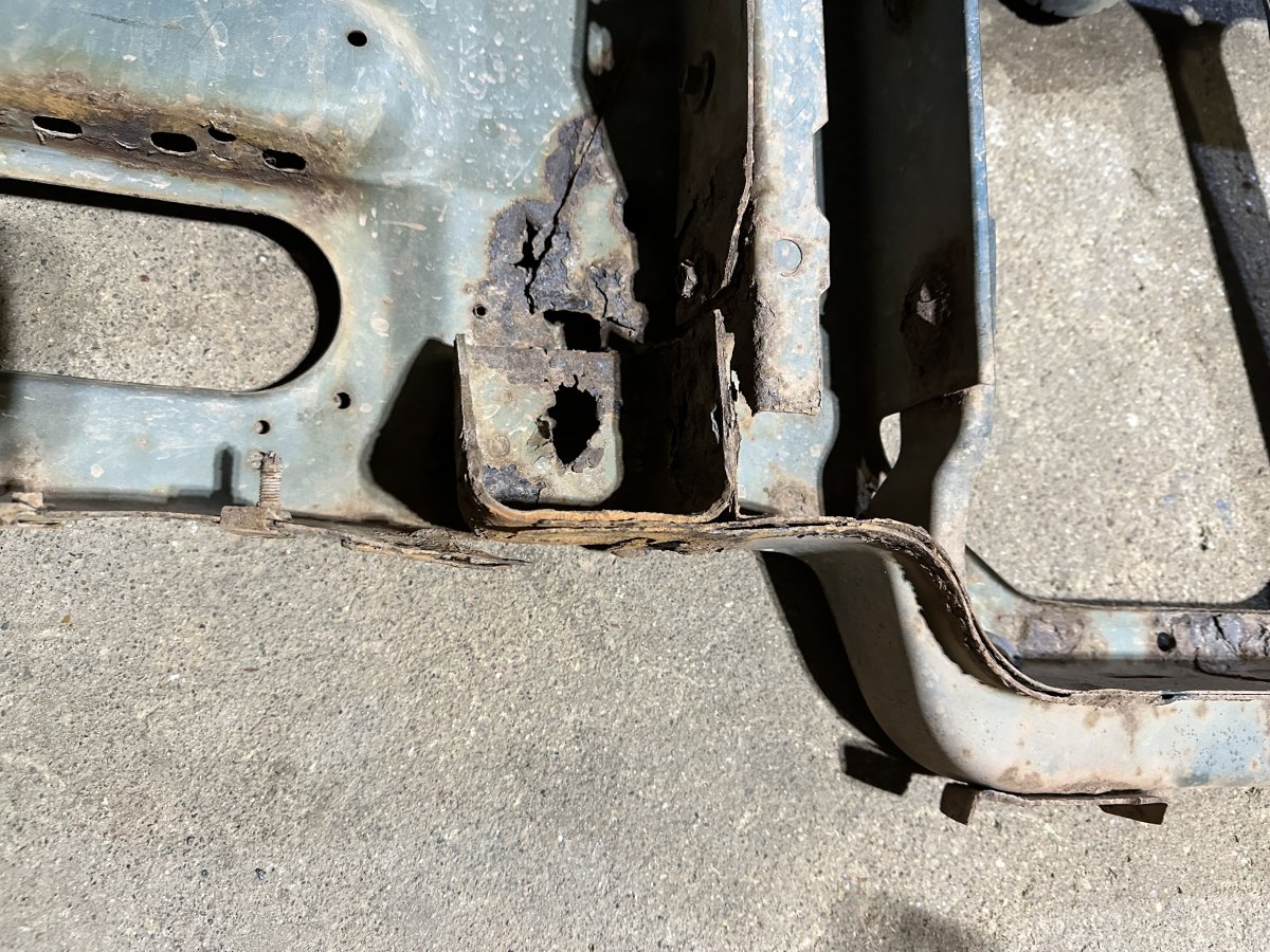

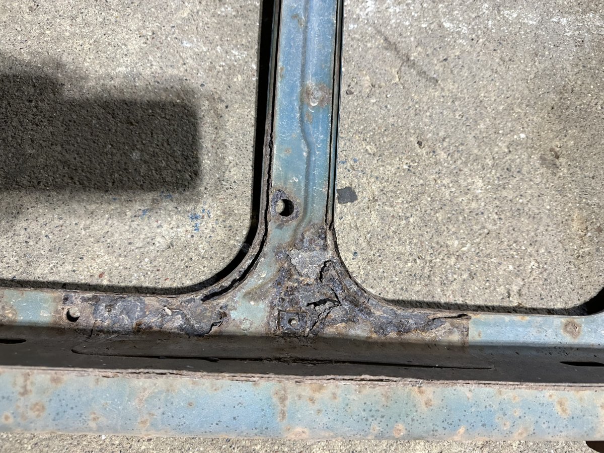

Better look at the rot.

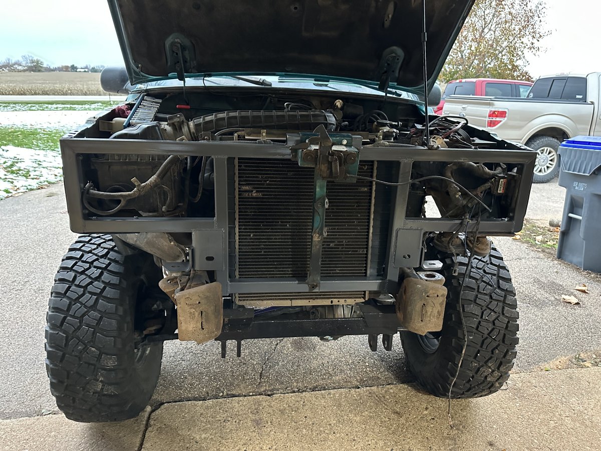

This is as far as I made it today. Got the upper radiator mounts done and the EDIS module mounted so the truck is moveable. Little different design from what Seth did on his. I need to add some tube for the body mount ears yet and get the mounts squared away so I can put the fenders back on. After the fenders are on, the height can be set for the hood latch bracket. Then the header panel can be bolted on and the rest of the brackets bolted up. I’ll be making a lot of angle iron tabs.

New core support is done enough to put the header panel back on. Need to get the fender gaps on the hood straightened out but everything is fitting together nicely.

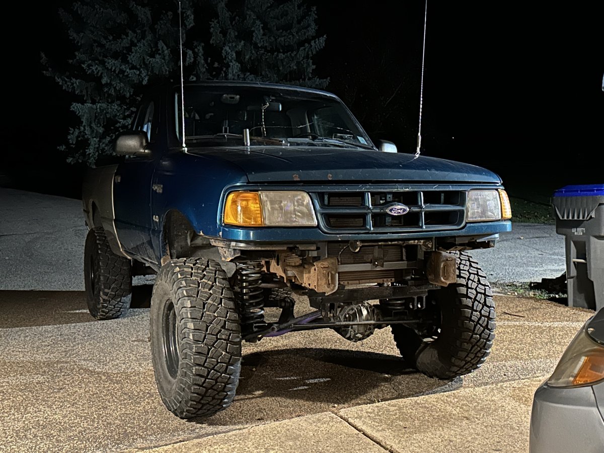

And it’s back on the road. Need to put the bumper back on and figure out a couple small, fairly unimportant brackets.
