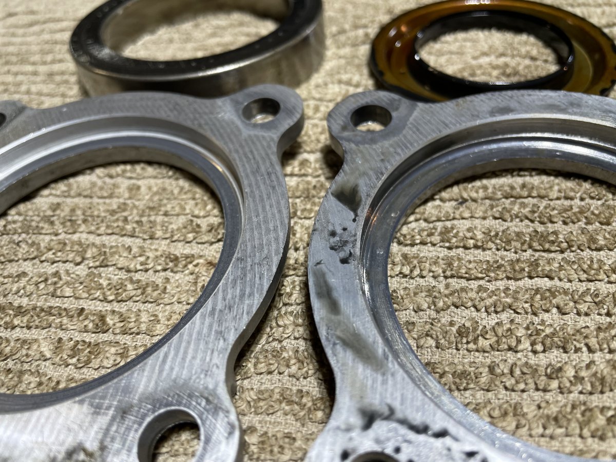

Found the culprit. Output shaft bearing spun the race. I’ve ended up using almost everything but the case from the 2.3 trans.

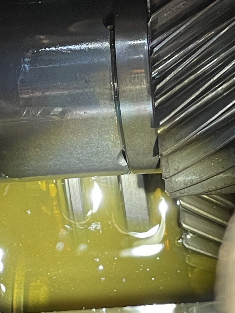

Thats motor oil by the way. NOT gear lube.
Looks like tomorrow I’ll be draining it and pulling the extension housing. Back half of the trans should be no problem to work on in the truck. Helps that I can sit upright underneath it.

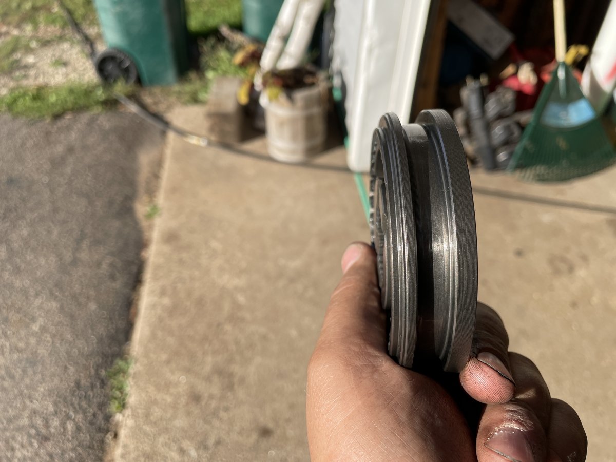

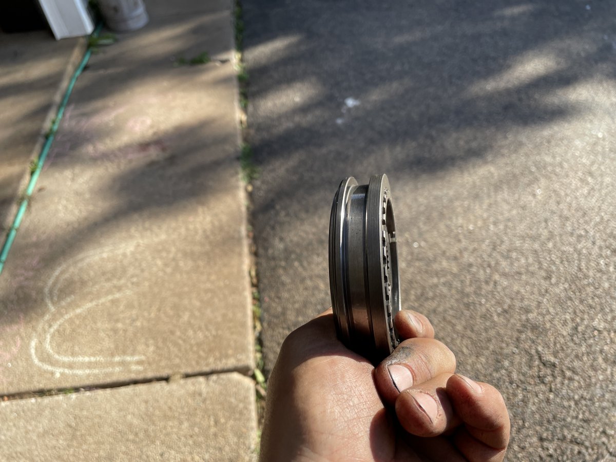

The hub of the slider is offset about 0.120”. I guess this is why you don’t work on it until midnight, shower and get up to finish at 5am.

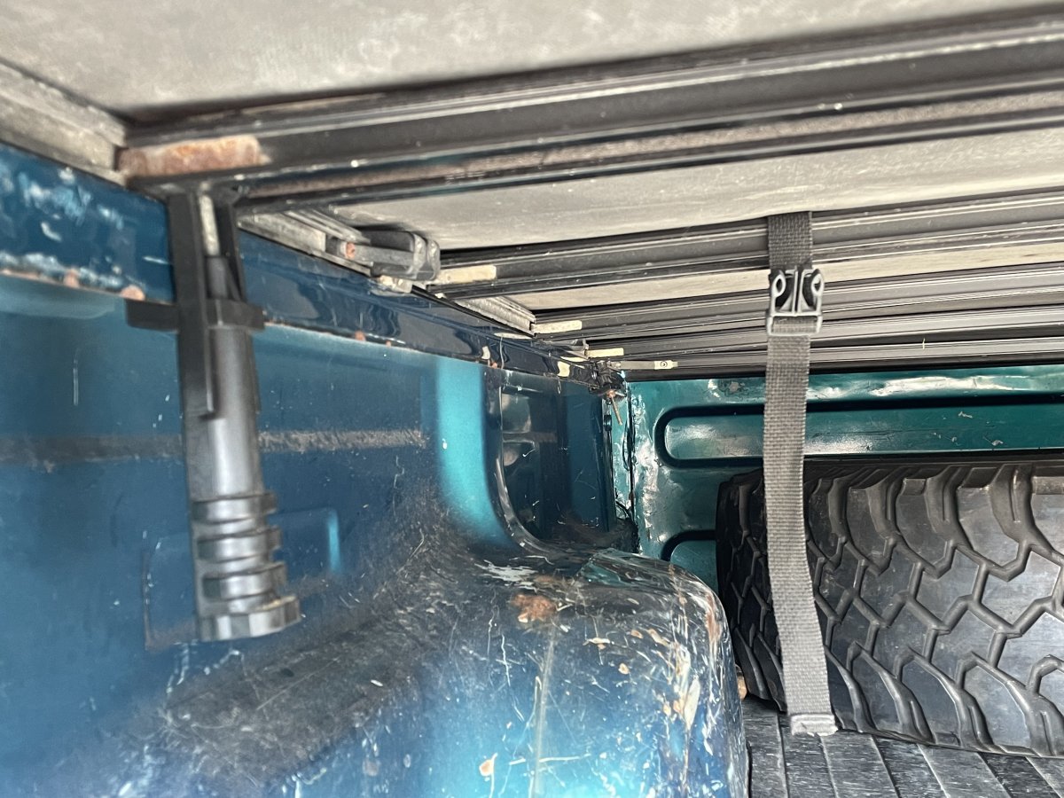

I’m not super crazy about how it attaches being a tri-fold. The front clamps require a deep well socket or a box end wrench to remove. The rear clamps are a quick style so it can be folded up easily.
66437
It would be nice to have the quick style clamps on all four corners but I don’t think they can create enough tension to keep things in place at highway speed.

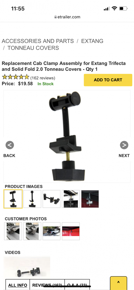

Further digging revealed that the front clamps should have speed knobs on them. Might have to purchase new clamps as I have one broken one anyways.

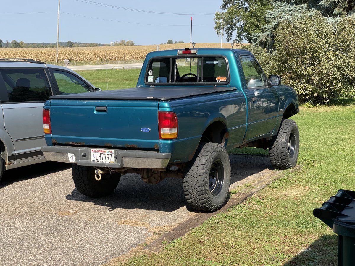

Things have definitely changed a lot for this truck
66536
It still has the same wheels on it that we’re on it in the pic above.
