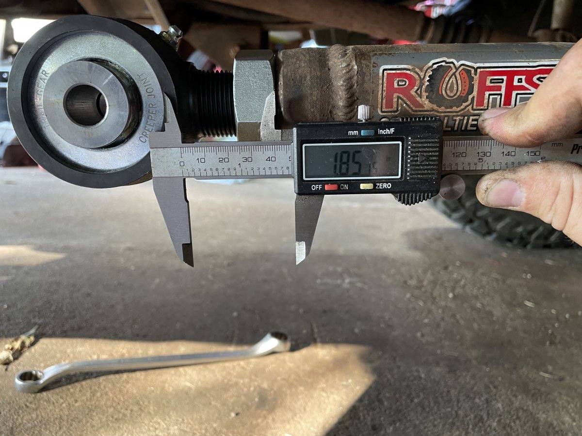

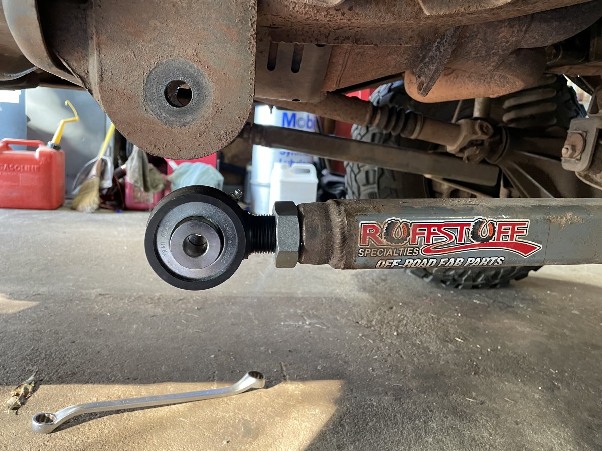

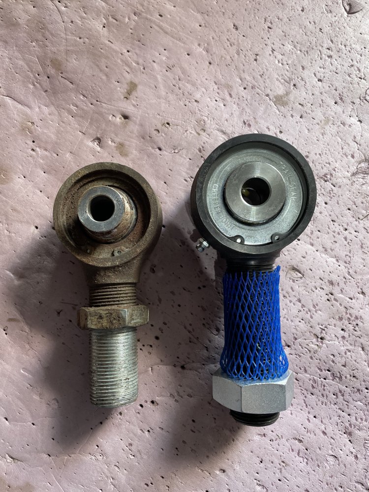

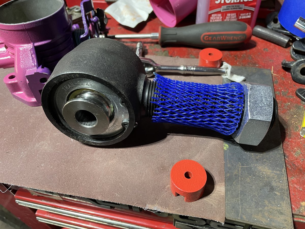

Got tired of the creaking QA1 Rock Ends so I finally ordered replacements. Decided on Trail Gear Creeper Joints and from the best I can tell, there isn’t much difference between them and Johnny Joints but there’s a huge difference between them and the Rock Ends.
66744
That’s a 1.25-12 creeper joint. In front of a 4.0 OHV throttle body.
66746
66747

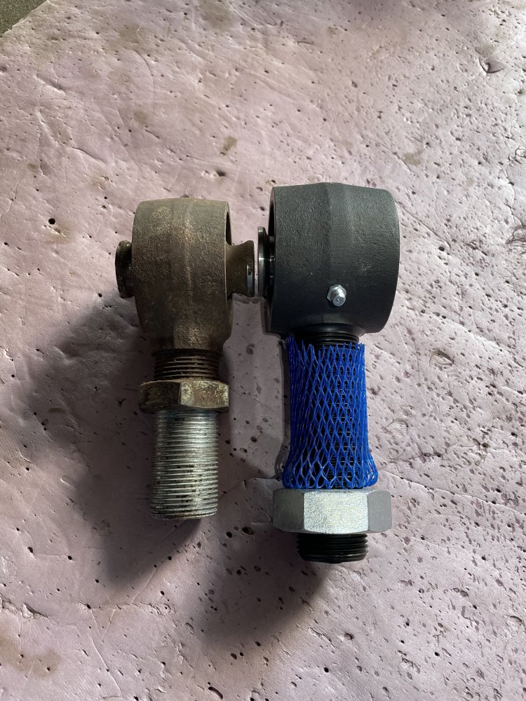

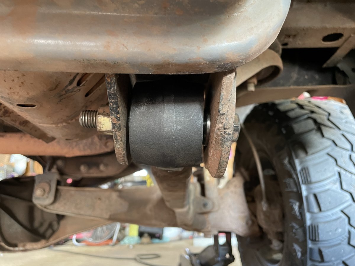

Pros: fully rebuildable, greasable, come with the jam nut, fast shipping through Summit Racing.
Cons: They’re wide.
So I put them in
66748
Measured from the ID of the bushing bore to the face of the insert. I measured the bore of both when I took the initial measurement. I had to subtract 0.030” from that length to set the new joints.
66749
These joints made a world of difference in how quiet and solid the truck feels going down the road. I do not regret that purchase one bit. Only complaint I have is how wide they are. Not a lot of room for movement with the body of the joint being so close to the width of the center.
66750
Seems to be plenty of room for the suspension to cycle though. I haven’t noticed any witness marks in the brackets and I flexed it as hard as I could. There’s enough room in my bracket to where I could shove a hardened washer inside on both sides of the joint if necessary.

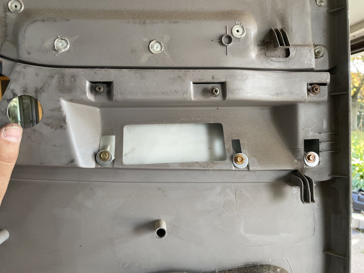

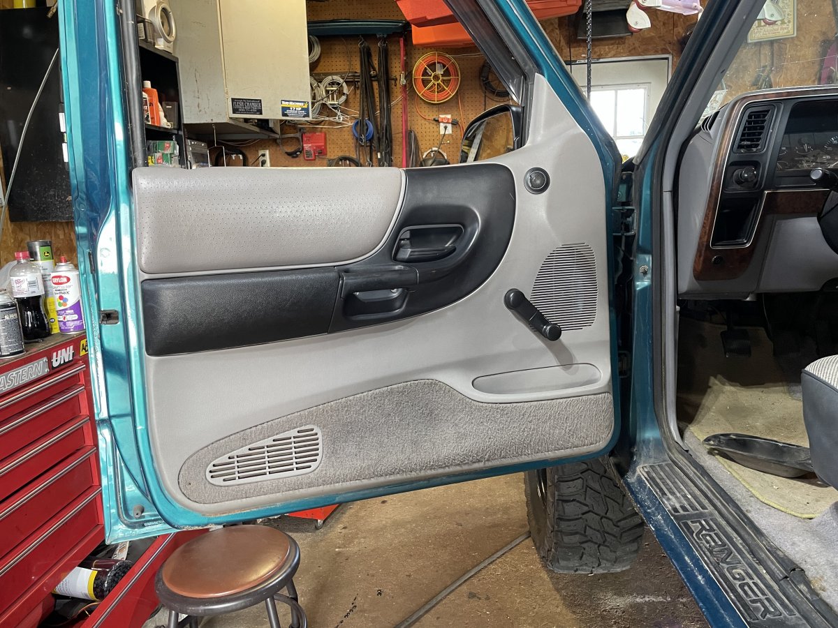

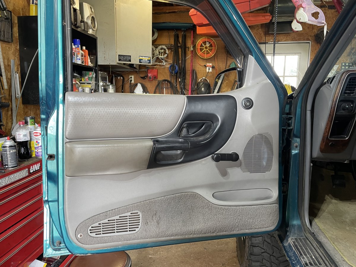

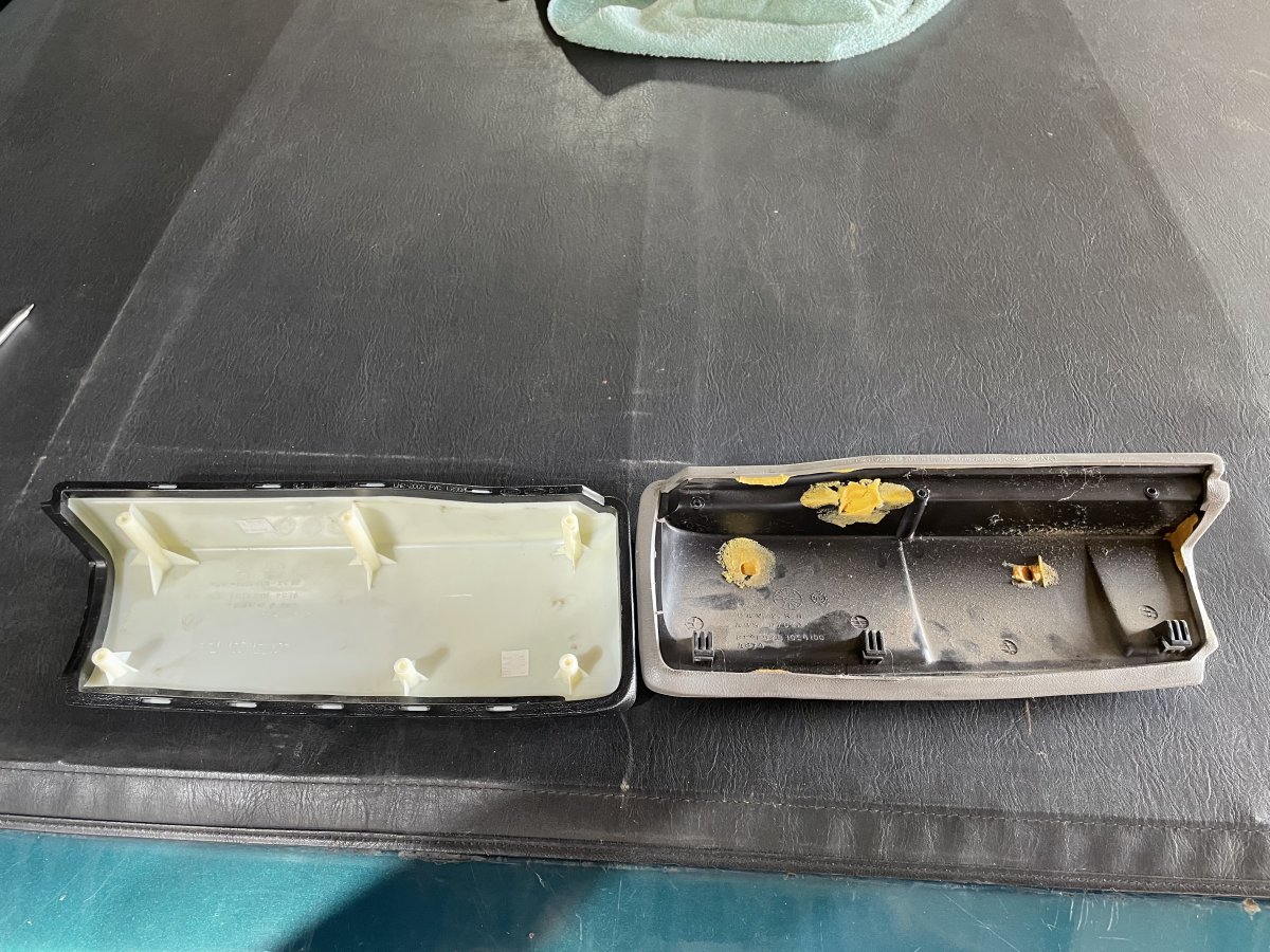

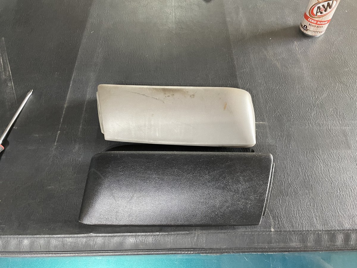

My old arm rests were stained and the bottom edge was separating so the updated design and black color were welcomed.
Only issue with putting newer pads on an older panel is the newer ones completely bolt on. The old pads clip in on the bottom and screw in on top.
66759
All the holes still line up and I used 1/4” washers on the bottom screws so they’d have something to grip.

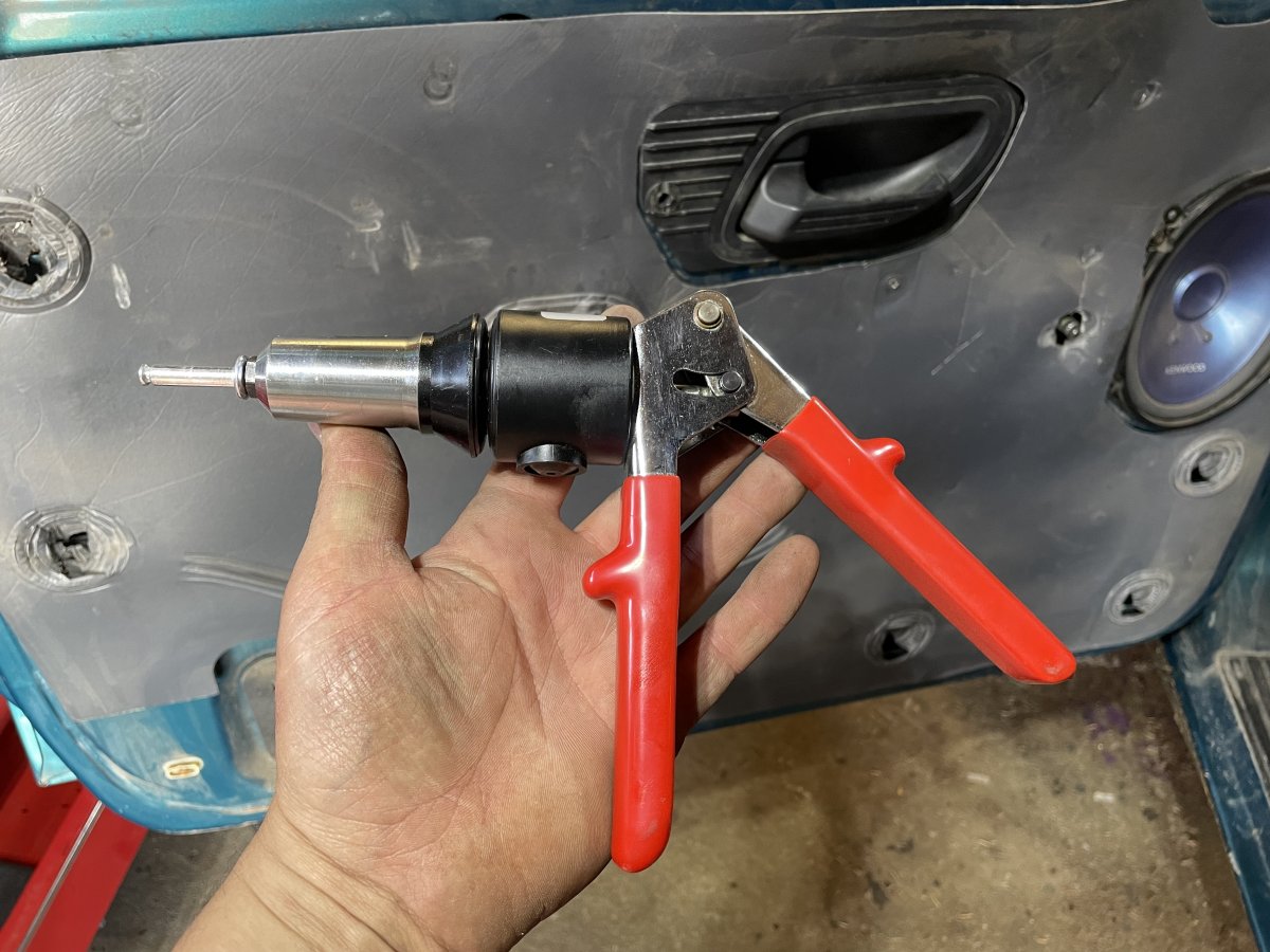

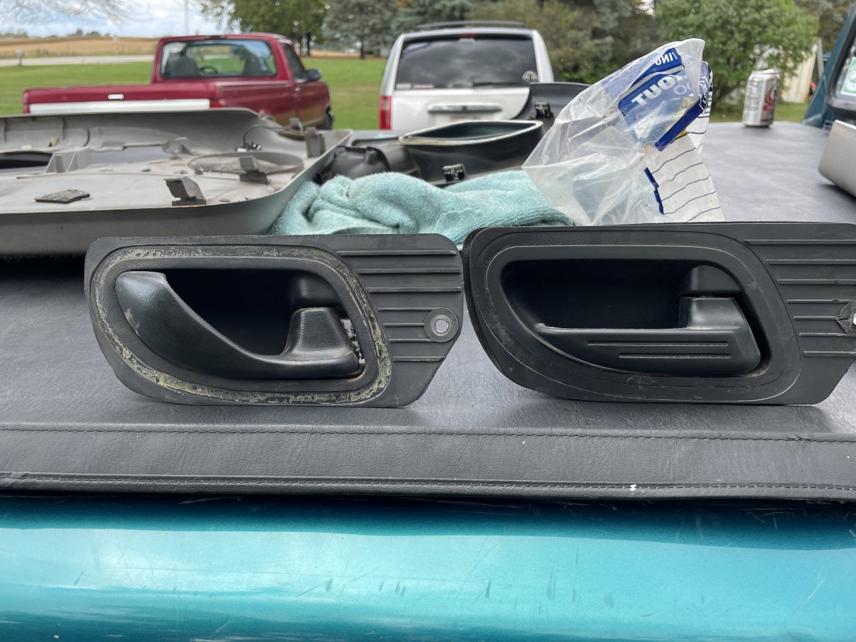

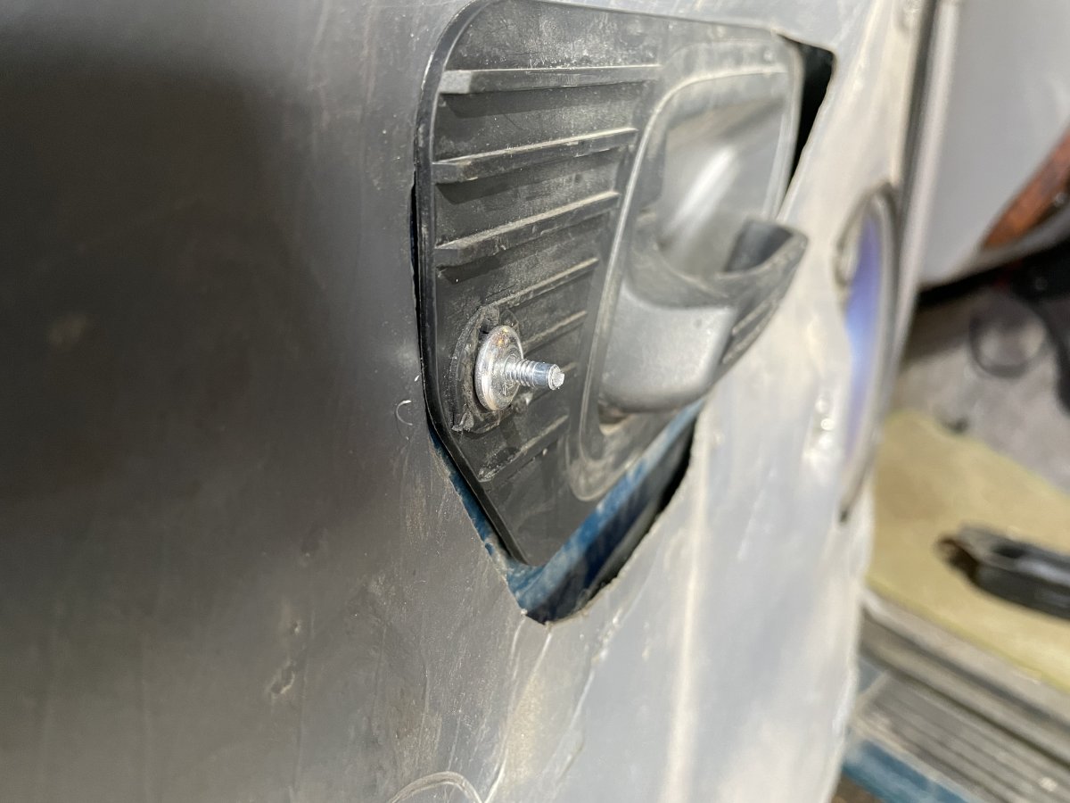

I like the newer door release handles quite a bit better. They don’t feel so cheap. I even had the correct rivets left over from replacing the window regulator some years ago.
66756
Both sides snapped off in the same place. No big deal. Just zip the rest of the stud off with a cut off wheel. The rivets are from a Dorman kit. I pull them with this…

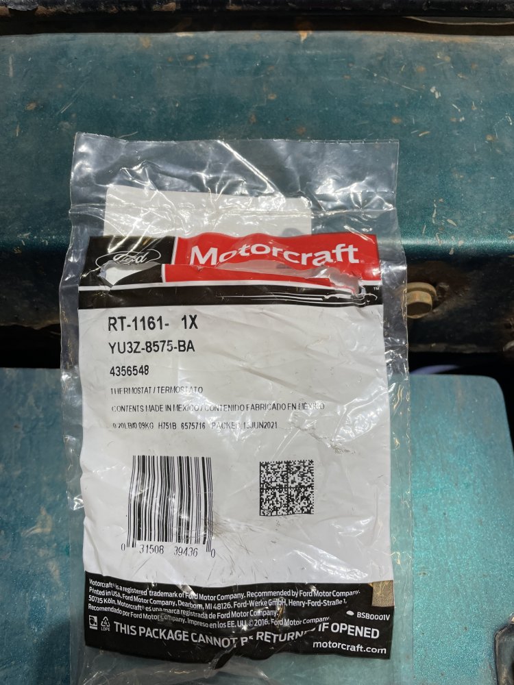

Pulled the truck in the garage for some much needed maintenance. I’ve been putting a cheap thermostat in every fall just to get good heat for the couple times I drive it every winter. Finally splurged on a Motorcraft stat. Hopefully this one can stay put for a while.
I’m not sure why the 4.0 OHV is so hard on thermostats. My old ‘99 Explorer needed one every year also.

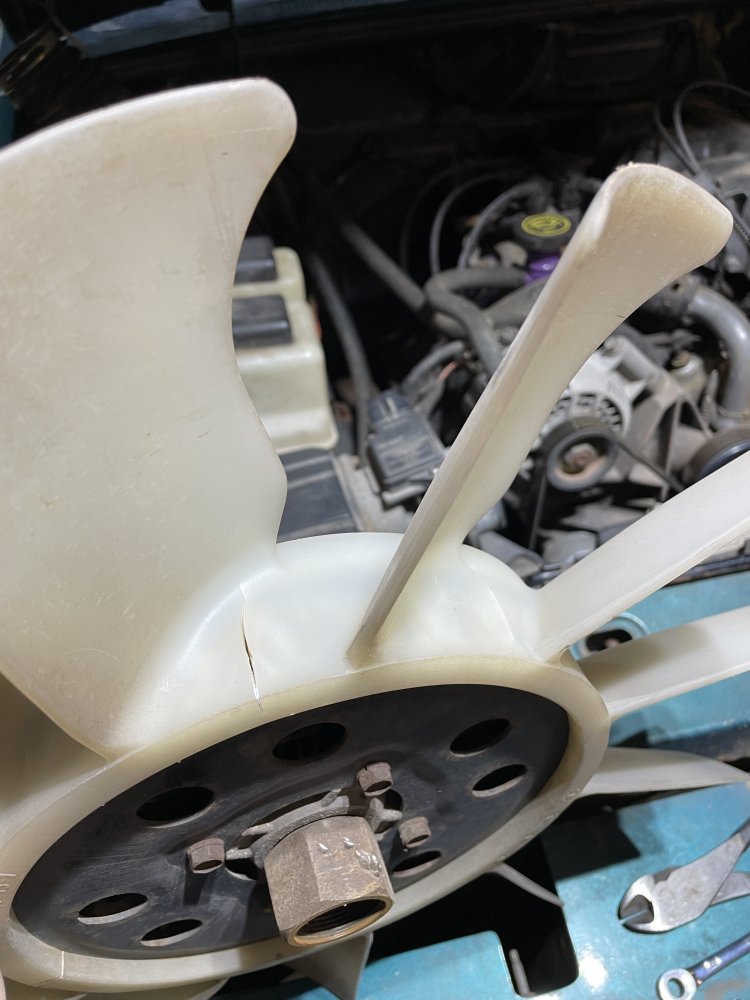

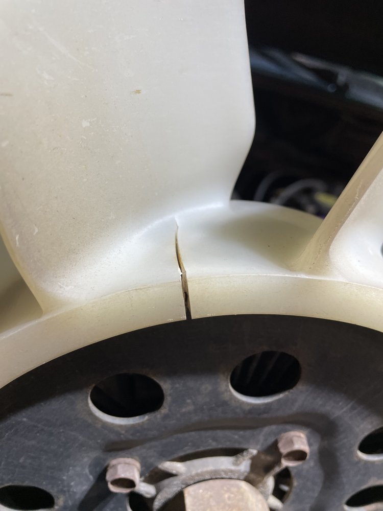

Noticed when I did the 4.0 swap that the cooling fan had some cracks in it. It doesn’t seem to take long for these cracks to get bad once they start so I Amazon’d a new fan. Ended up with a Taiwan Dorman unit.
69357
I drive the piss flaps off this truck and can’t believe the fan didn’t explode at 5,000 rpm.

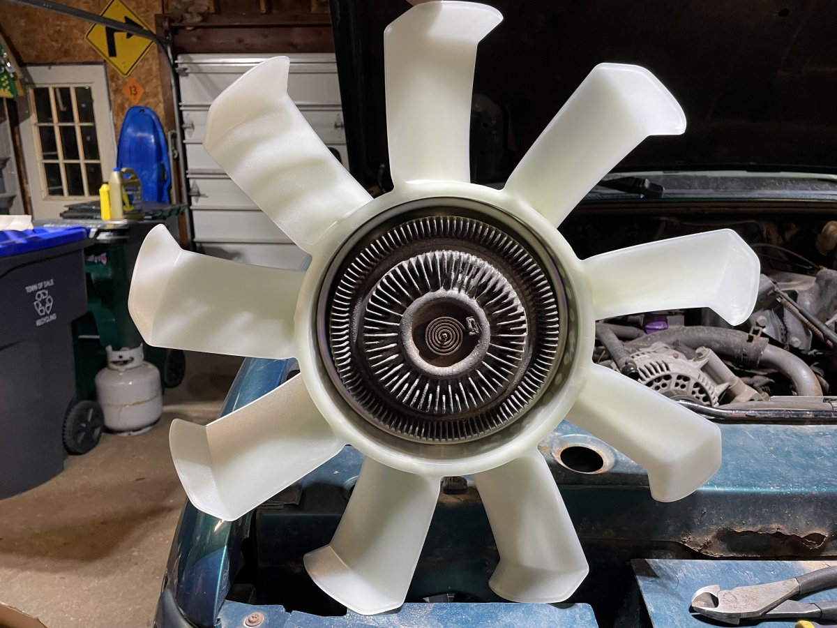

Dorman unit. This thing moves some air!

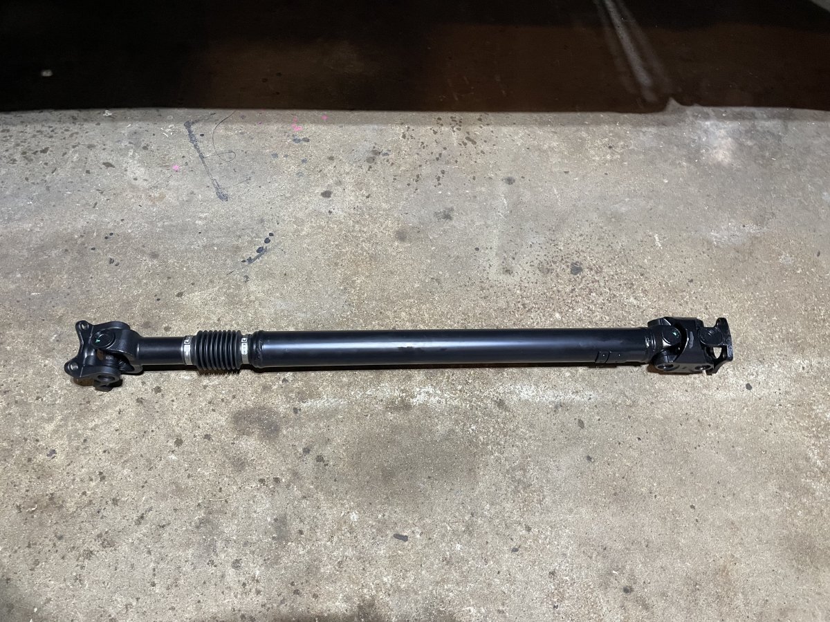

I finally bought the correct rear driveshaft for the truck. It should have a double cardan shaft. When I built the truck, I shortened the long half of the 2-piece rear shaft from my donor truck. It vibrates a little and I’m sure it killed my trans bearings.
New shaft
69363
I probably won’t get around to the driveshaft until it gets warmer outside again. I’d like to swap in some Chevy springs and ditch the stock lift block but I’ll have to cut the spring perches off and reset the pinion angle. Not really that fun in winter. Probably weld the axle tubes to the center section at that time also.

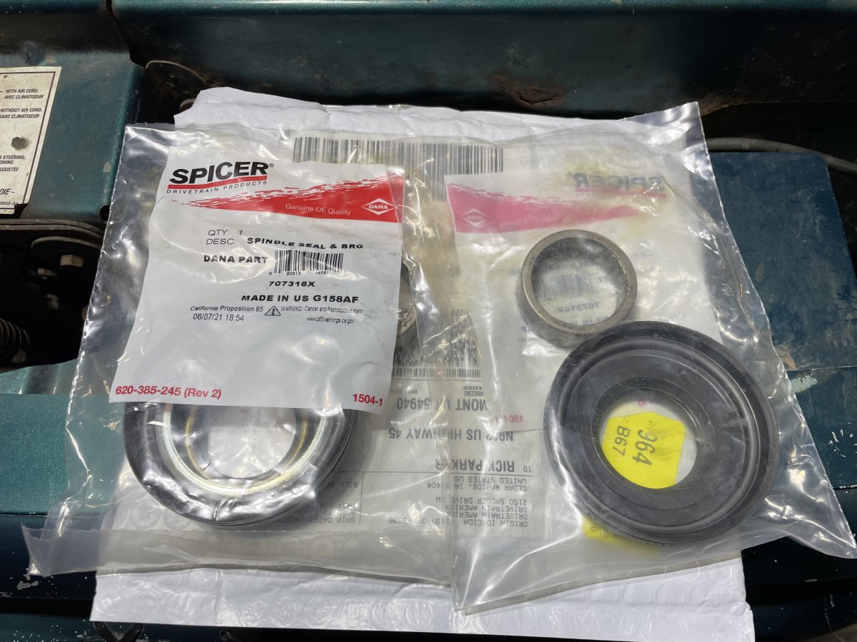

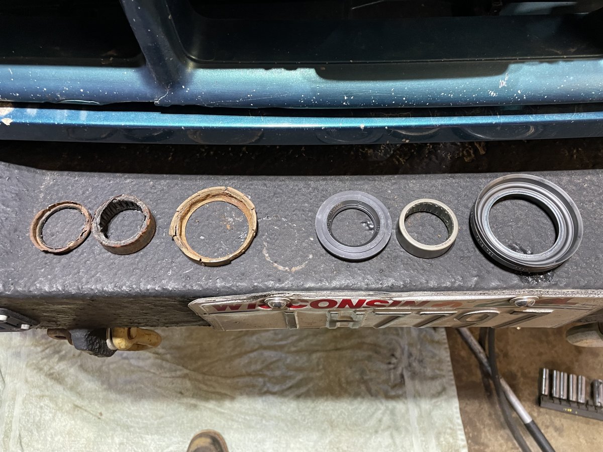

So here’s what I found behind the spindles;
69395
Compared to new…
69396

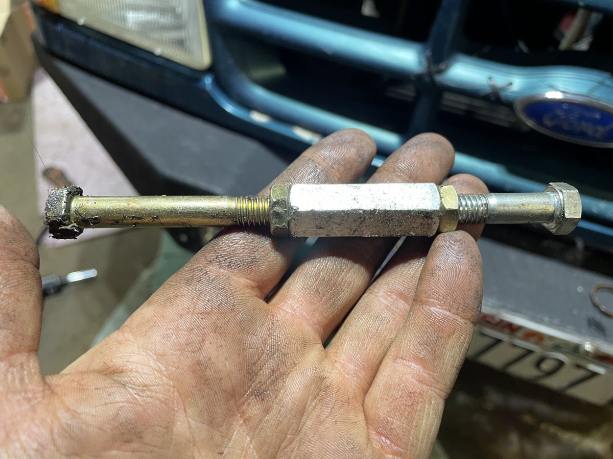

This is all I use to pound out the bearings. 3/8” grade 8 bolt. Coupling nut and shorter bolt to extend it so I’m not whacking my hands with the hammer. The head of the bolt fits perfect in the groove below the bearing.
69397

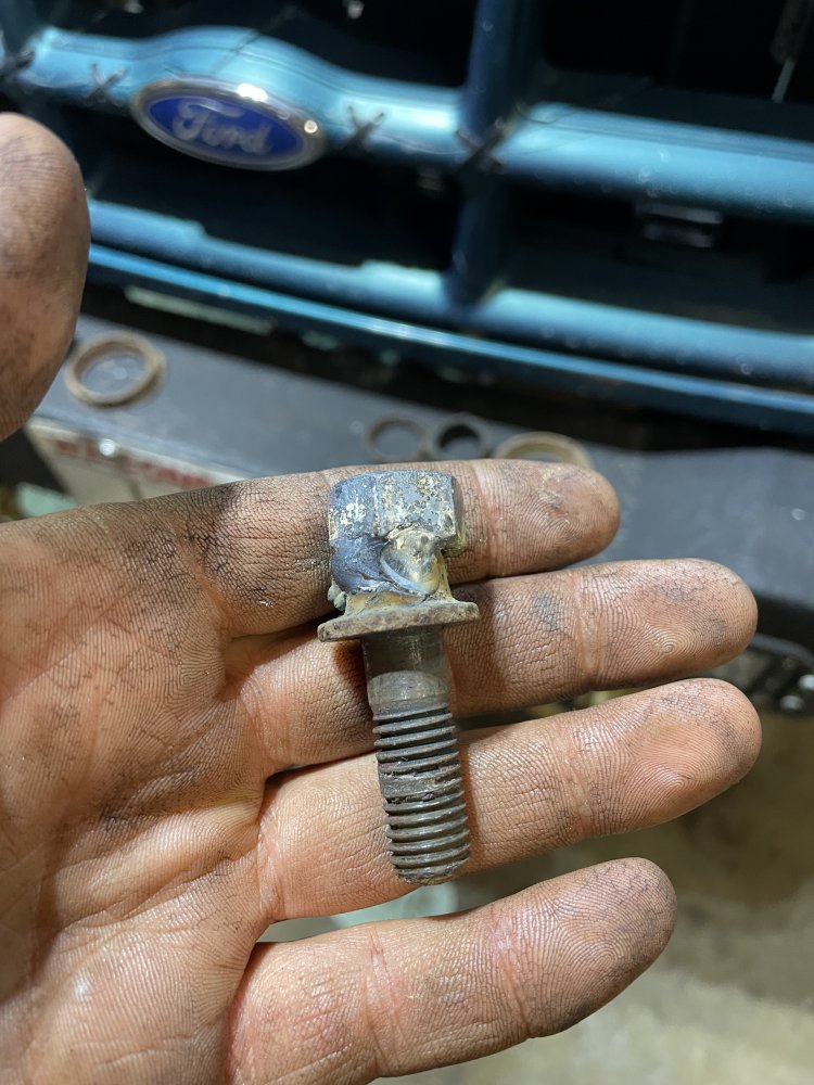

And two of my caliper bracket bolts ended up like this..
69398
The Dorman section at any auto parts store has two packs of replacement bolts for about $8. Otherwise it’s an M12 x 1.75 flanged bolt.

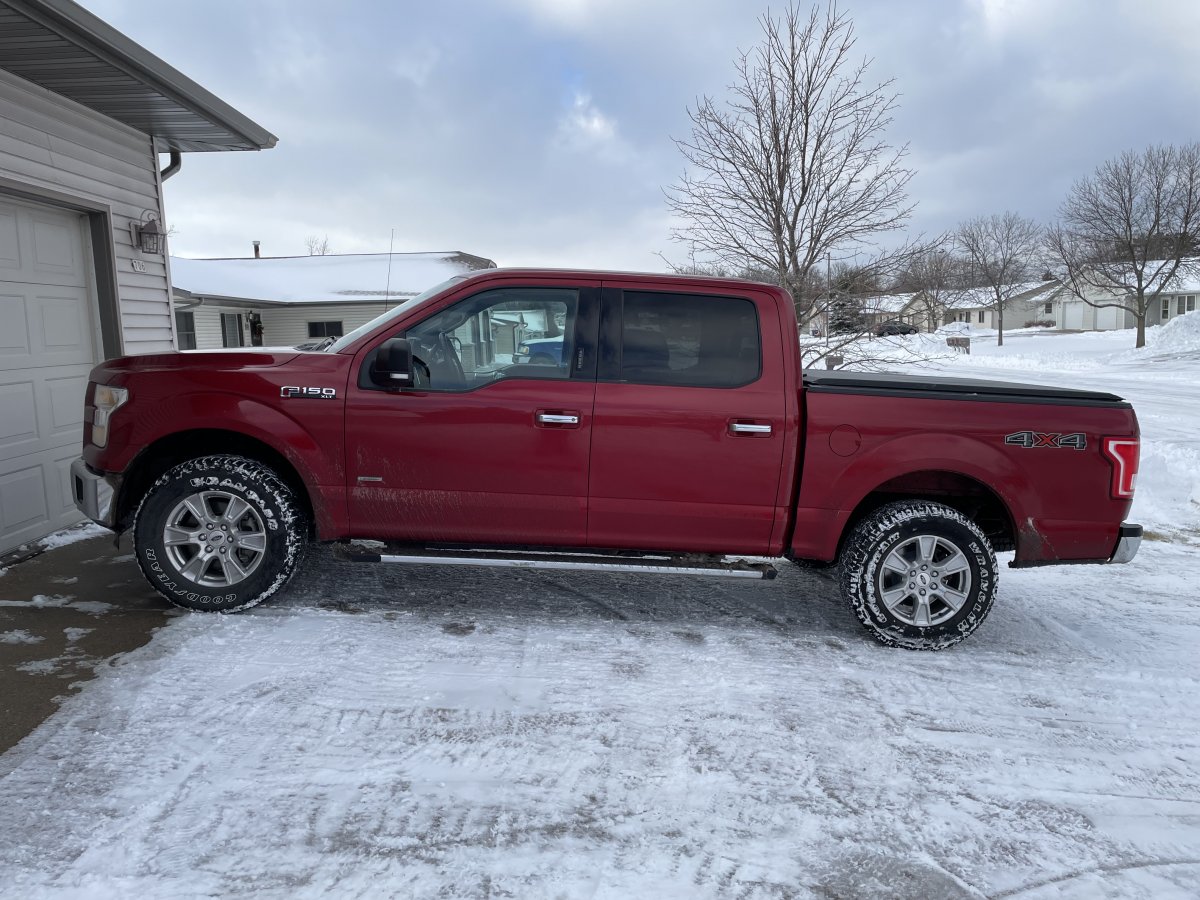

According to the truck, the slope of that driveway is 6°.

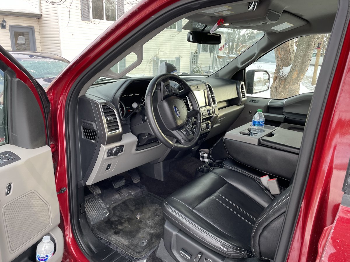

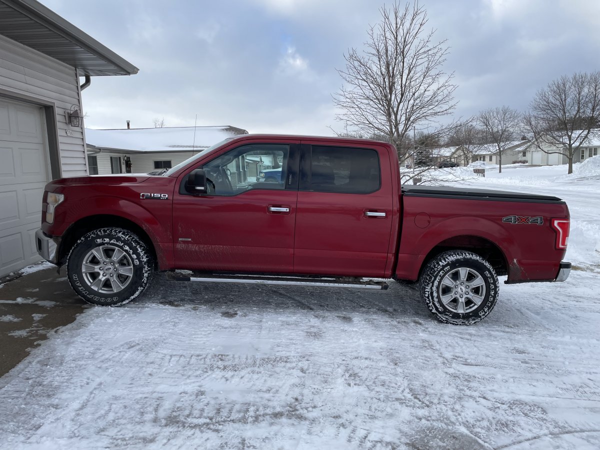

After a series of let downs and replacing parts, I was joking with my wife just before Christmas that we should take our Grand Caravan to her moms in western Wisconsin and trade it in. She said “Ok, what are you going to buy”? Found it! I’ve never had a vehicle this nice so I’m happier than can be.
It’s a 2016 XLT 3.5 ecoboost. Katzkin Black leather, electronic locker, trailer brake, touch screen, tonneau cover, blah blah blah. I love it.
