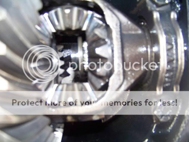

stands. remove rear cover completely. you will now want the transmission in neutral. rotate the ring gear until you can see the retaining bolt for the cross pin.
when it is directly in the middle, cross pin level, go put the trans in park or 1st gear to hold the drive shaft-ring/pinion in place. the cross pin retaining bolt is a 5/16 hex head, it is in tight and with loctite from the factory, get a 5/16 wrench with a 6-point box end and put on the bolt, tap with a hammer to break it free.
once you remove the retaining pin, go put the transmission back in neutral so the carrier will move, turn the carrier and the cross pin should slide out.
once the cross pin is out, push each axle shaft in one at a time and remove the "C" clip retainers.

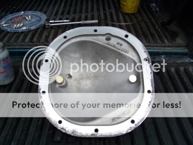

clean up your cover and the mounting face of all silicone or gasket material. wipe down with brake clean. from the factory a lot of these used no cover gasket but just rtv silicone. you can get a gasket if you choose. I have a aftermarket cover and prefer a gasket. after you clean both surfaces, take a break and slide the brake drums back on.
adjust brake shoes if needed (my self adjusters don't work, I'm sure many others have this issue) use whatever method you wish to seal your cover, rtv or gasket. put cover on and start all the bolts.
