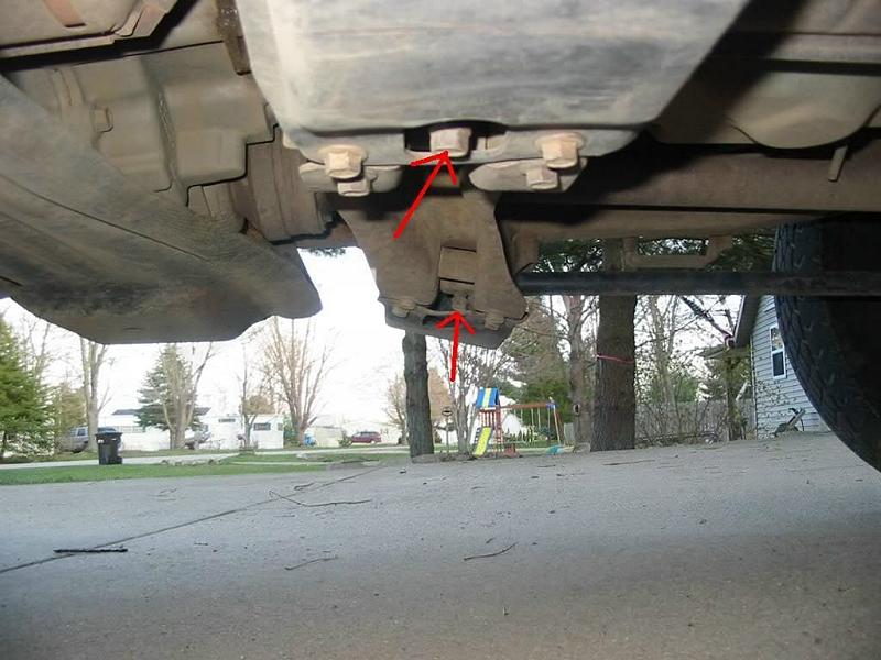

Spray WD-40 on the torsion bar bolts. There are no locking nuts or anything to loosen.
Measure the distance that the bolts are out in case you want to put them back to stock.
Ford Ranger torsion bar bolts location
Location of Torsion Bar Bolts
CRANK THEM BABIES… as you turn the bolt in you should see the tires drop toward the ground. Stop after about 2-1/2 inches. Try to get the same number of turns on each bolt with the same distance gained.
