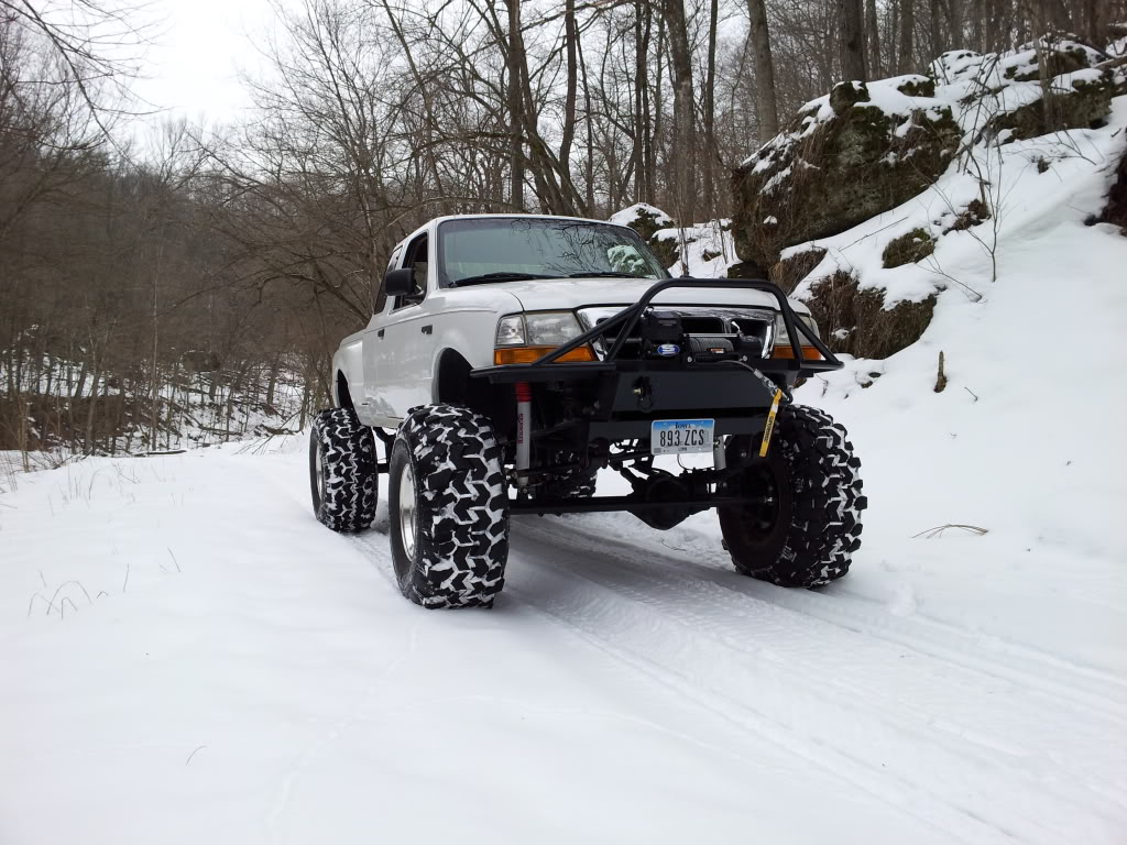

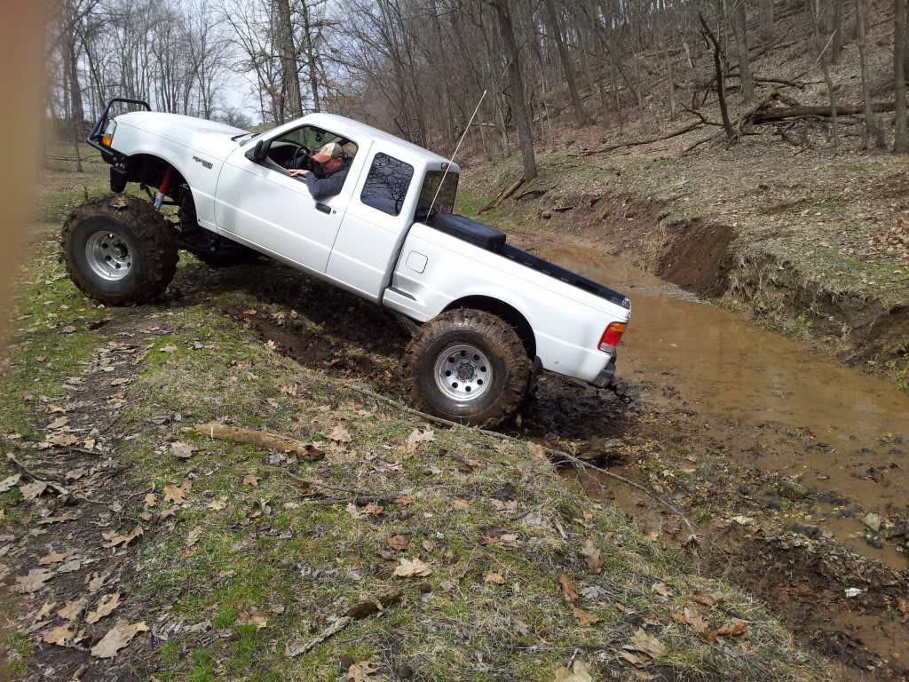

Seeing a 1998-2011 Ford Ranger converted to a solid front axle (SAS) isn’t all that rare, but it is rare to see one that’s been done with front leaf springs.

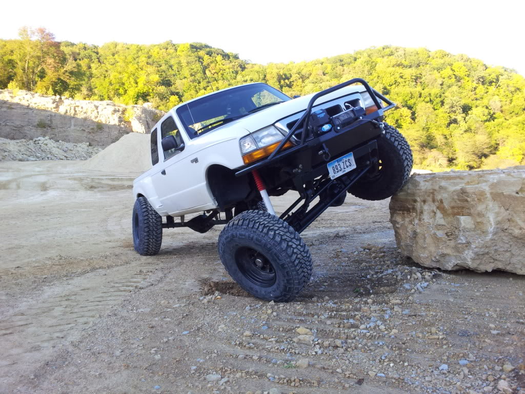

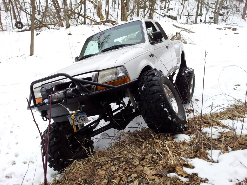

When forum member Ford78 built this 1999 Ford Ranger 3.0L 4×4, he decided to swap in a Dana 44 and use Rancho 44044 front leaf springs. The Rancho 44044’s are a 2-1/2 inch front lift spring for the 1974-1989 Jeep J10, J20, and Wagoneer. They are 47-inches long with a 300 lbs./in. spring rate. The front mounting bracket is a SAS hanger for a fullsize Chevy from Sky Offroad. Ford78 mounted the front bracket where he wanted the axle to sit, and mounted the rear shackle where it had about a 45 degree angle.
The front Dana 44 has been upgraded with Yukon chromoly shafts, 5.13 gears and a spool.

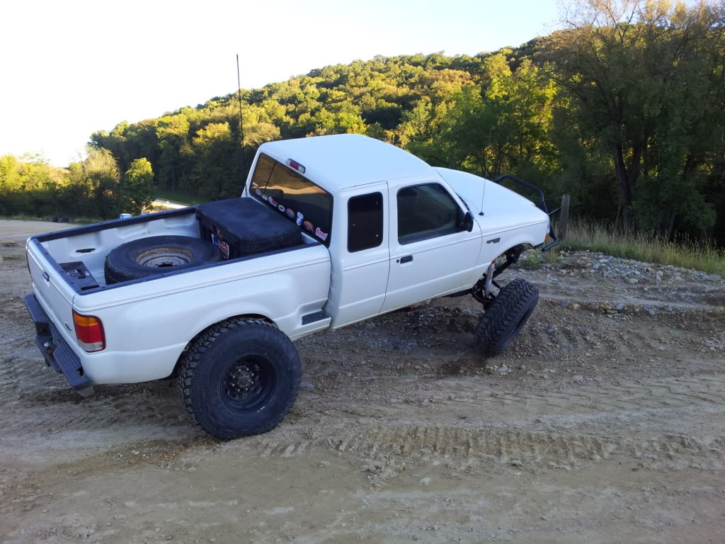

The rear axle is a Dana 60 that has also been re-geared with 5.13 gears and a spool. It’s mounted under the truck with a 6-inch lift spring, 5-inch lift block, and Chevy 2-inch lowering shackles.

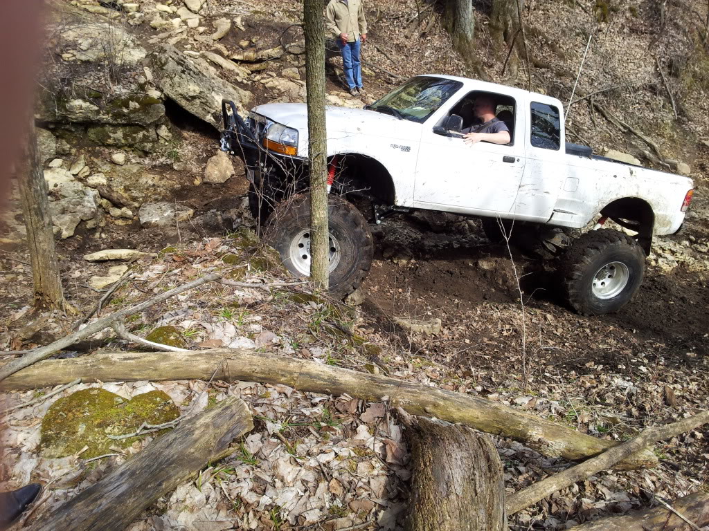

Ford78 drove with the 3.0L / automatic setup until the 3.0L died, and then swapped in a Ford 5.0L (carburetor) with a NP435 manual transmission, and NP205 manual transfer case. The exhaust finds its way out of the motor with help from Advance Adapters headers.

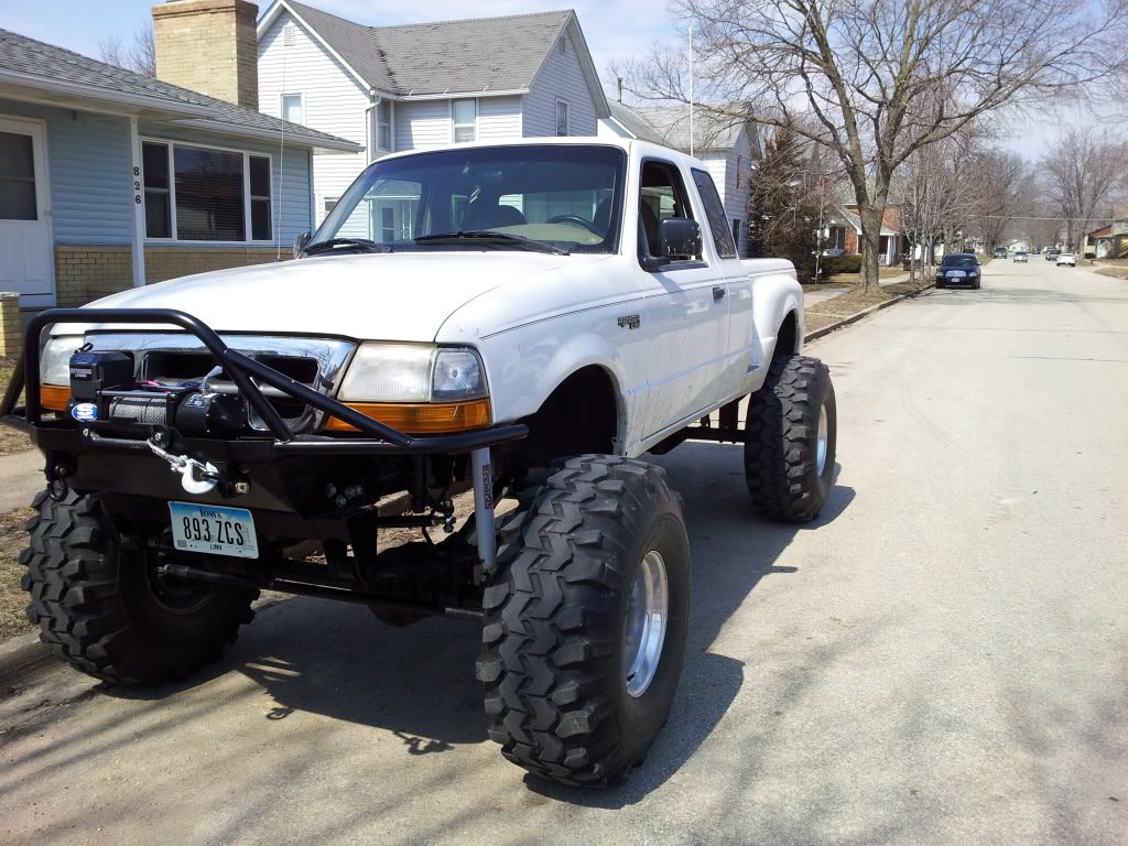

Ford78 has ran 39.5×15 tires on the truck, but the current setup is 37×12.5 tire Goodyear MTR’s.
Although he didn’t originally build the track with a front trac-bar, he later added one to help the handling and steering.

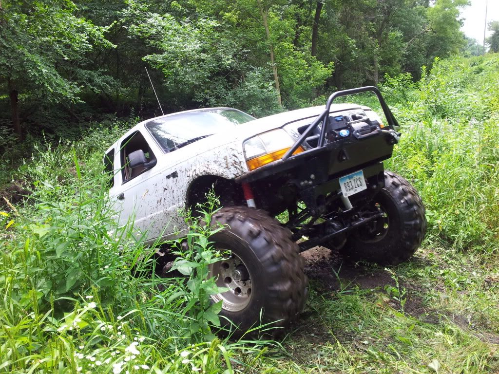

Other upgrades to the truck include a front bumper from RLC welding, and Superwinch winch. The interior received a panel with custom gauges, as well as a relocated shifter.
