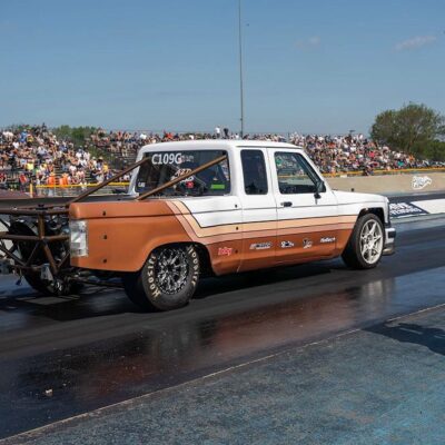

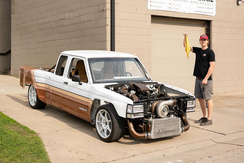

Built to compete in SEMA’s Battle of the Builders and the Young Guns class, Ryan’s Ranger is an all-out, stick-shift, turbocharged drag truck designed to push the boundaries of what a Ranger can be.

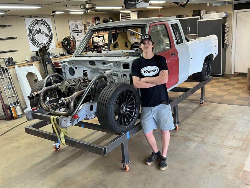

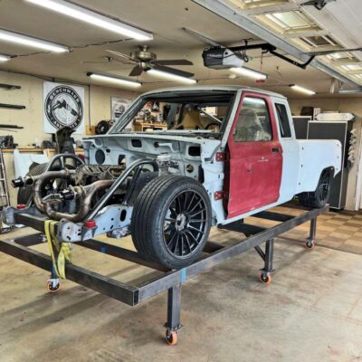

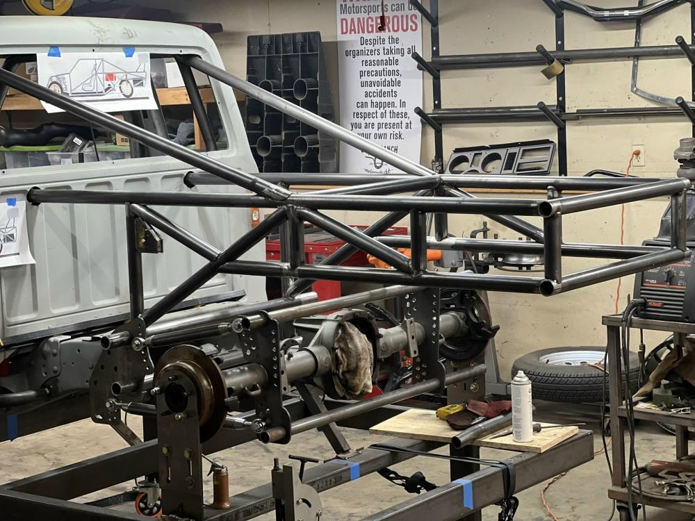

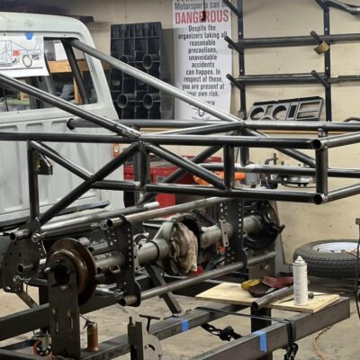

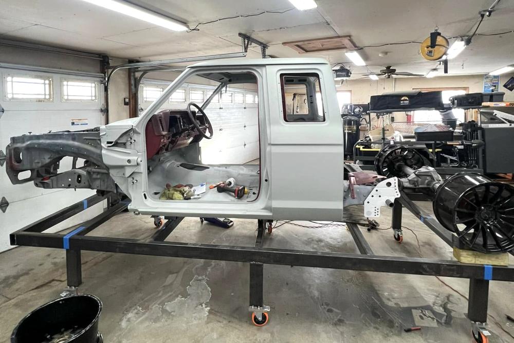

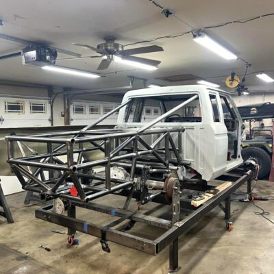

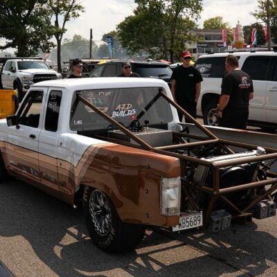

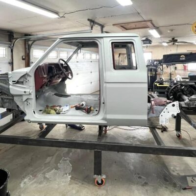

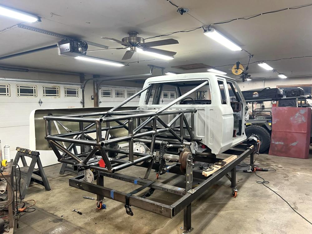

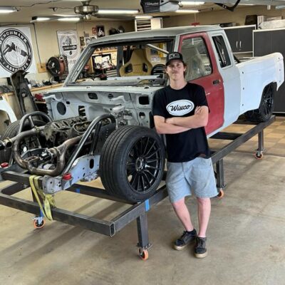

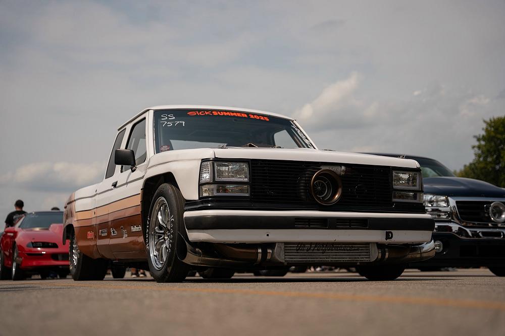

Ryan started with a clean 1988 Ranger and stripped it down to bare metal—literally. The cab and frame were sandblasted before paint to ensure a clean foundation. He then modified roughly two-thirds of the stock frame and replaced the rest with custom tubing, ensuring the chassis could handle the immense power and repeated drag-strip abuse.
To tie it all together, a roll cage made from 1.75-inch tubing was added for safety and stiffness. Up front, the factory suspension was replaced with a Mustang II independent front suspension, while the rear features a custom four-link setup connected to a Ford 8.8-inch rear axle—a proven, lightweight housing strong enough to handle big torque.
Ryan also updated the truck’s look using a 1989–1992 Ranger core support, which allowed him to fit the fiberglass front fenders from a wide-body kit. The rear wears matching fiberglass bedsides, giving the truck its aggressive, race-ready stance.

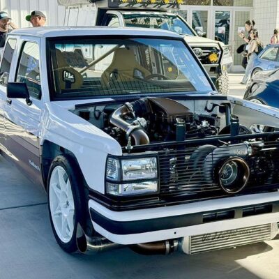

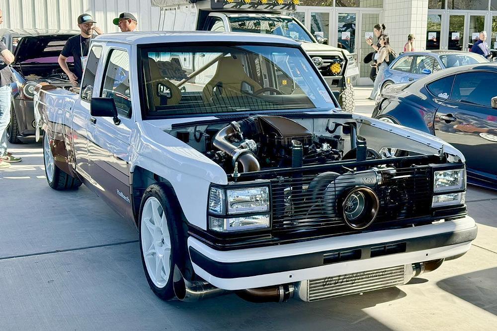

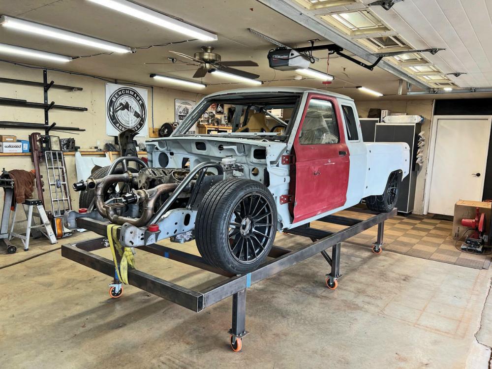

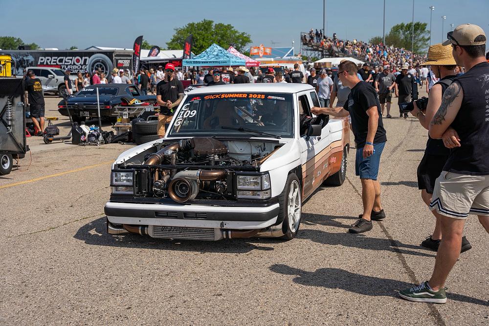

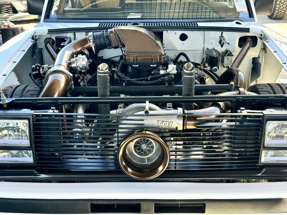

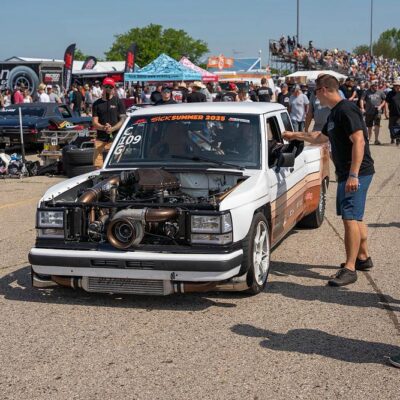

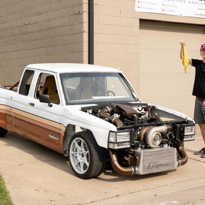

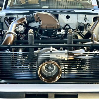

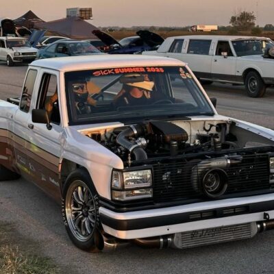

Under the hood (and behind that massive turbo) lies a GM LT4-based 6.0L LS engine topped with 5.3L 243 heads. The engine’s internals are forged and ready for big boost, with Wiseco pistons and Manley connecting rods providing strength and reliability at high horsepower levels.

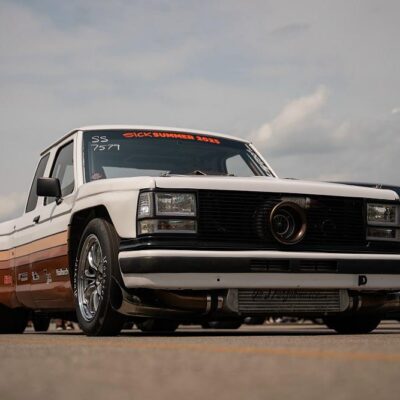

Fuel and air management are handled by a Holley Hi-Ram EFI intake manifold, while a TDI (Turbo Diesels) GT55 88mm turbocharger feeds massive airflow through an air-to-air intercooler. The combination results in brutal acceleration and a sound that turns heads long before the truck crosses the finish line.
Fuel delivery comes from a Holley fuel cell, and to help manage heat, Ryan mounted the radiator in the rear of the truck—a popular setup in competitive drag builds to improve weight distribution and airflow efficiency.

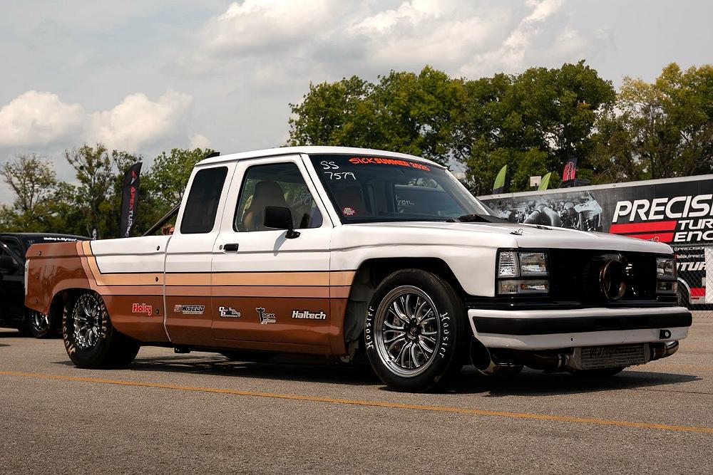

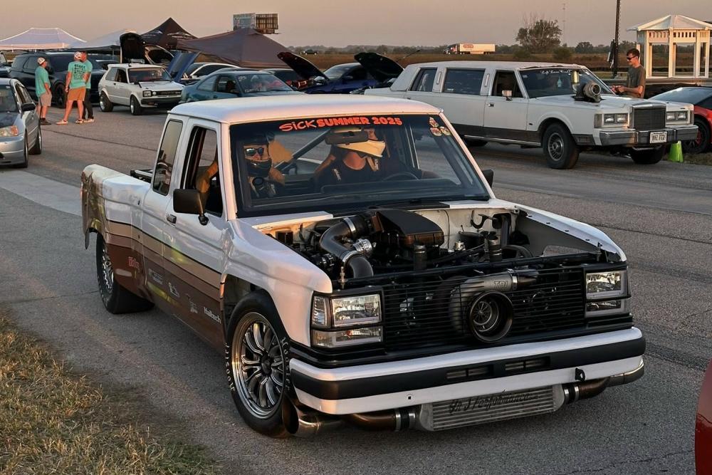

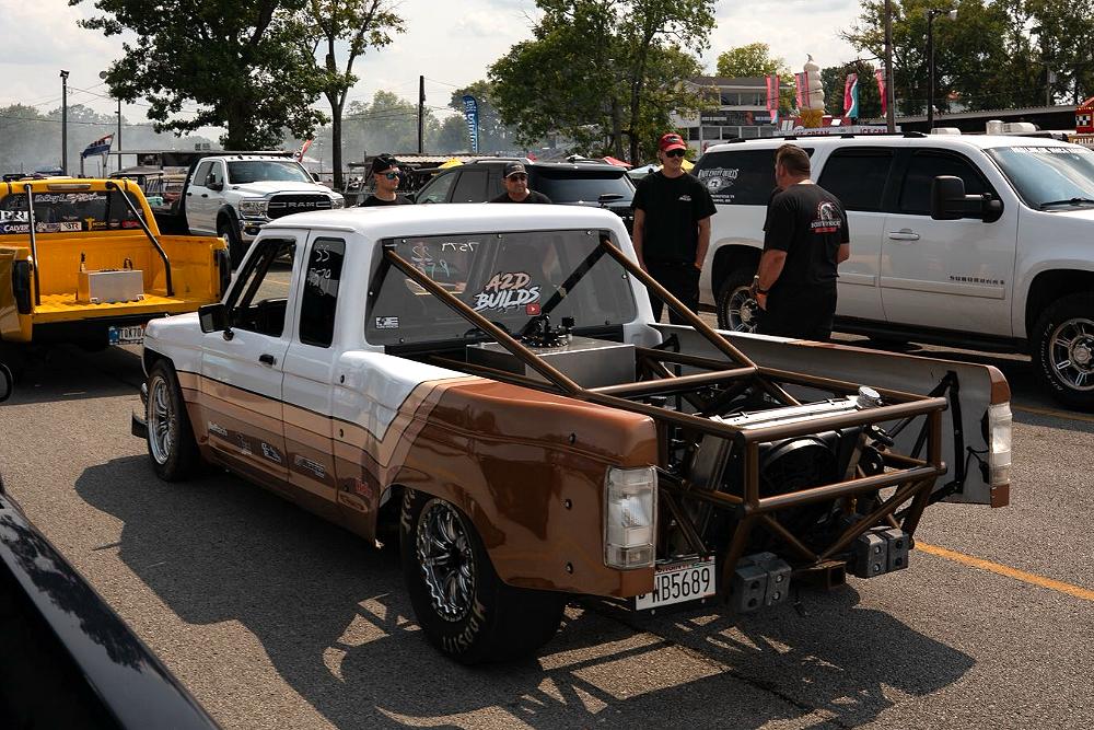

Visually, the truck blends street-truck simplicity with race-ready aggression. The fiberglass wide-body kit gives it a planted, muscular stance, while the later-model front clip ties the body lines together seamlessly. Every inch of the Ranger shows the detail-oriented craftsmanship Ryan put into the project—especially considering he handled the sandblasting, fabrication, and assembly himself.
The rear-mounted radiator setup, tucked-in roll cage, and clean engine bay show both function and form—this isn’t just a showpiece; it’s a purpose-built drag truck.
