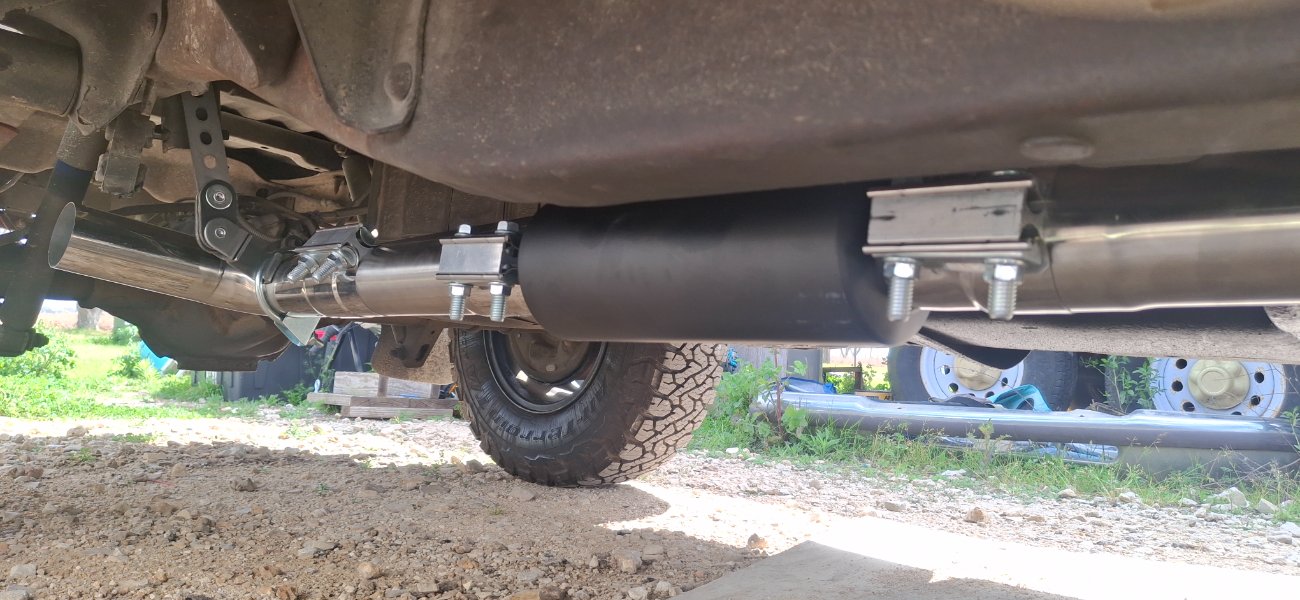

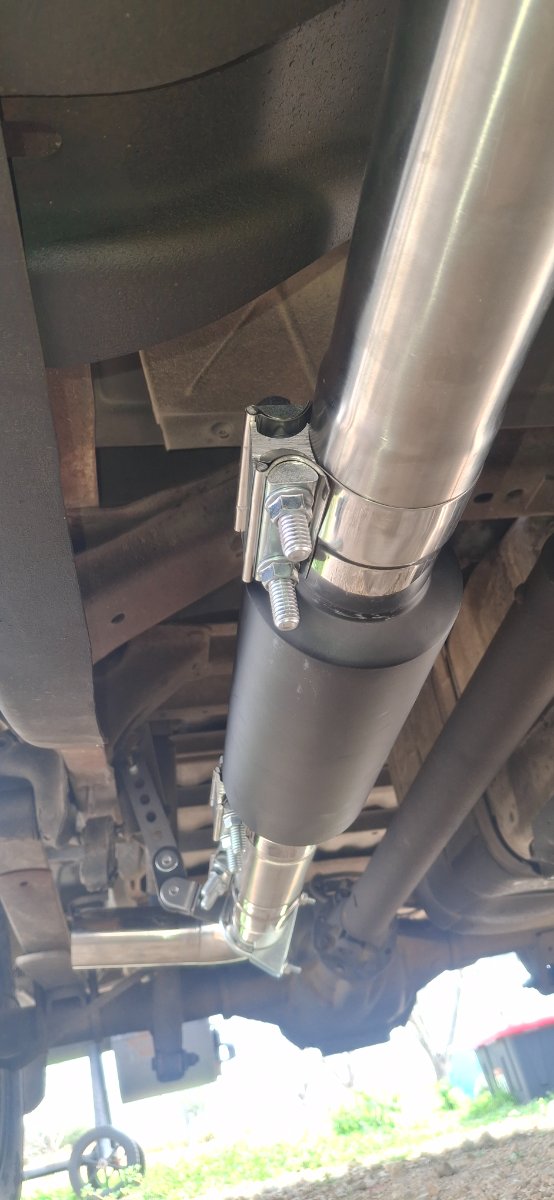

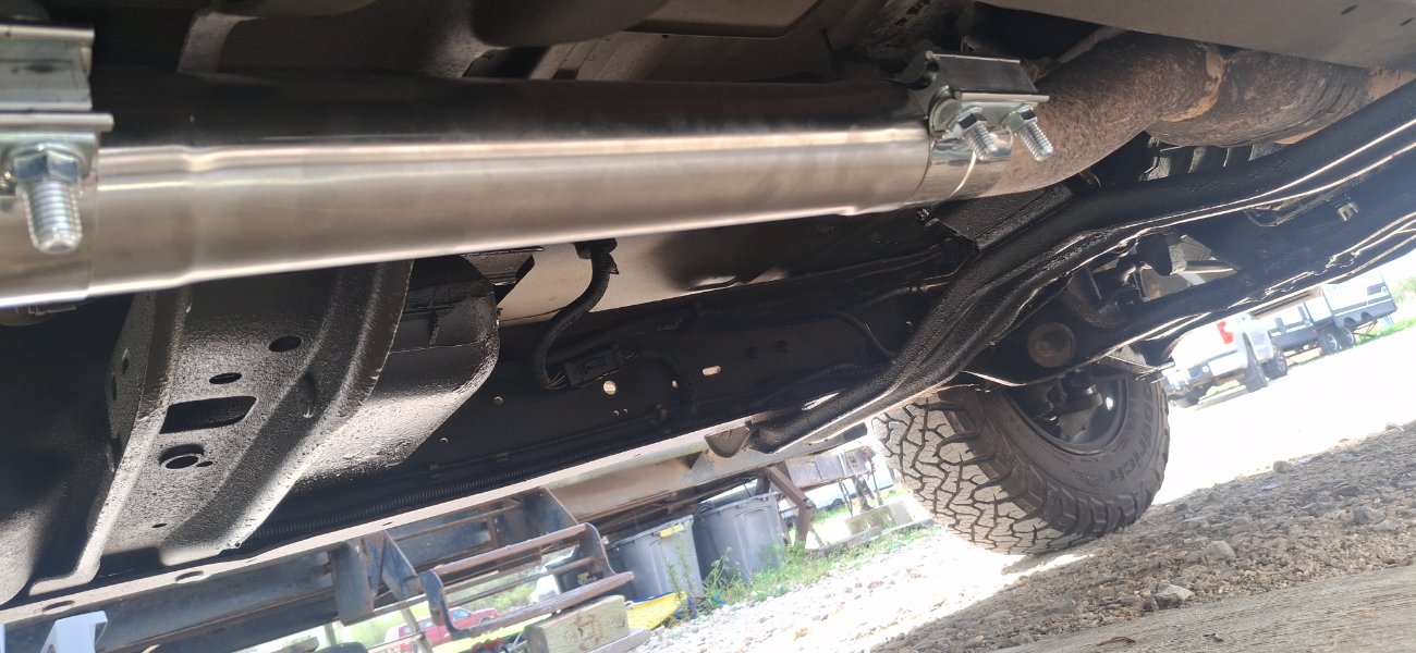

The first connection that's behind the cat is at the manifold so I'll have to do it there. As long as I leave the only 2 hangers attached it shouldn't fall or anything. One is attached to the transmission mount I believe and the other is the rear hanger at the elbow after the muffler. Added some pics of my recent exhaust repairs to give more of a visual as to what I'm referencing with the rear hanger.
