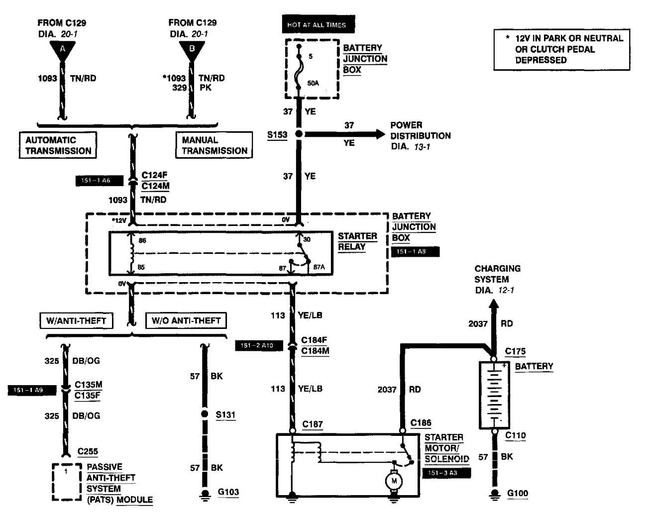

Ok, sorry I was in thinking in the older truck world. Your newer truck has the "starter relay" in the underhood fuse box.
1999 Ranger No Crank Electrical Gremlin

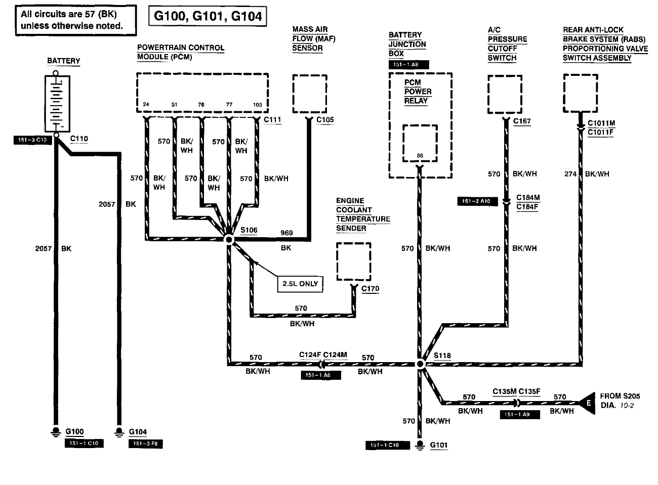

Here is a grounding diagram.

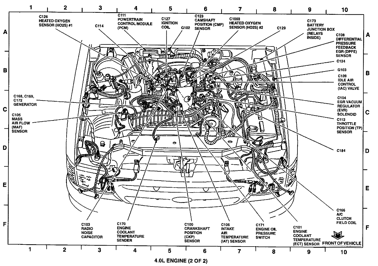

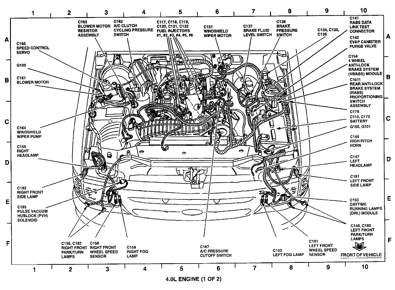

Here are g100, g101 and g105
Checking grounds again this morning I haven't found any of these to be bad. However, I ran a couple feet of wire from the negative post on the battery and touched the other end to various grounds. If I run the ground wire to a random spot on the steering column my issue goes away and the truck starts and runs fine. So there seems to be a ground issue somewhere around the steering column.

Whelp I figured it out. After triple checking the G100 grounds I found the G101 was ever so slightly loose. This is the second ground on the radiator support stud. Its mounted behind the G100 on the same stud so I didn't initially see that it was loose. I tightened this up and all my issues have gone away.
I also haven't seen anything directly tying this to the interior electronics but it makes sense since it shares the same harness.
Moral of the story is, triple check the simple stuff before you start throwing parts at it.
