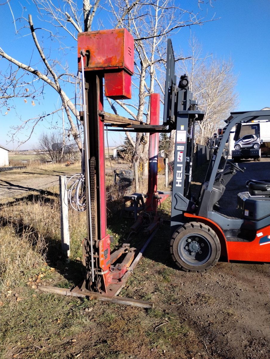

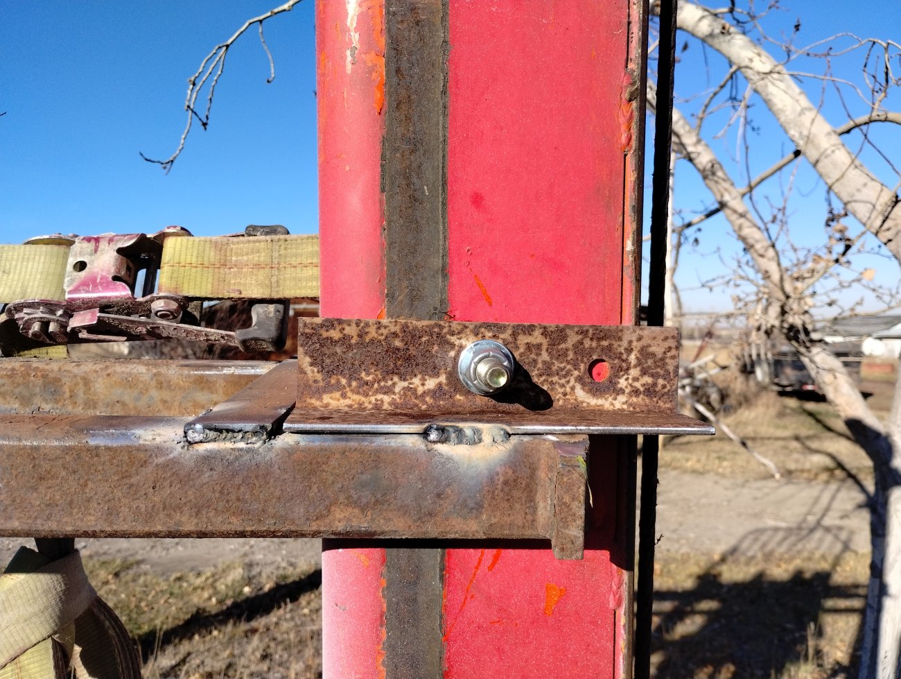

A couple years ago I bought a new to me car lift from my boss. It sat at his place until last fall and he got tired of looking at it. He got a couple of the other guys to help move it, I wasn't there. It has a sub-frame that is bolt to poured in place concrete slab about 1.5'x5' by I don't know how deep. The used a couple 1.5" x 1.5" x 1/8” angle to span across the posts at the top. Then used a chain from one post to the other and a fork lift...
The angle folded and the sub-frame bent to crap...

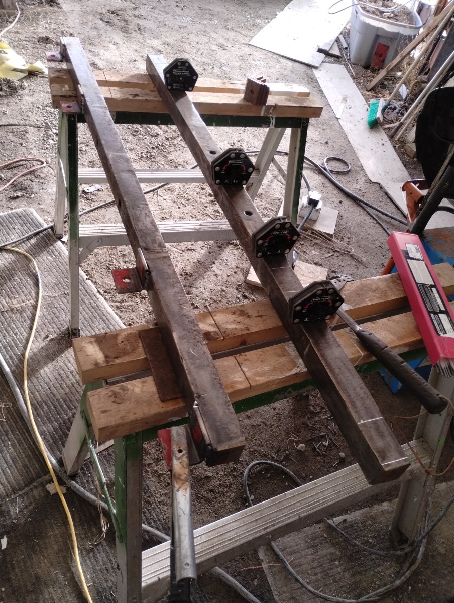

The last few weeks I've been slowly getting a new sub-frame put together. The only parts I used from the old one were the 2 end pieces, 2" x2" solid bar 55" long. I cleaned them up and welded some 2" x2" x1/4" angle to the top to be used to attach a 6"x6" x10' pressure treated beam. The beam is in place of concrete. It will sit on compacted recycled concrete. The other part of the sub-frame is two tubes, 2"x2"x3/16"x134", which are welded to an I-beam that has been cut in half to form a T. Two holes were drilled to match the holes in the base of the lift and the 2x2 was welded into the opposite side.

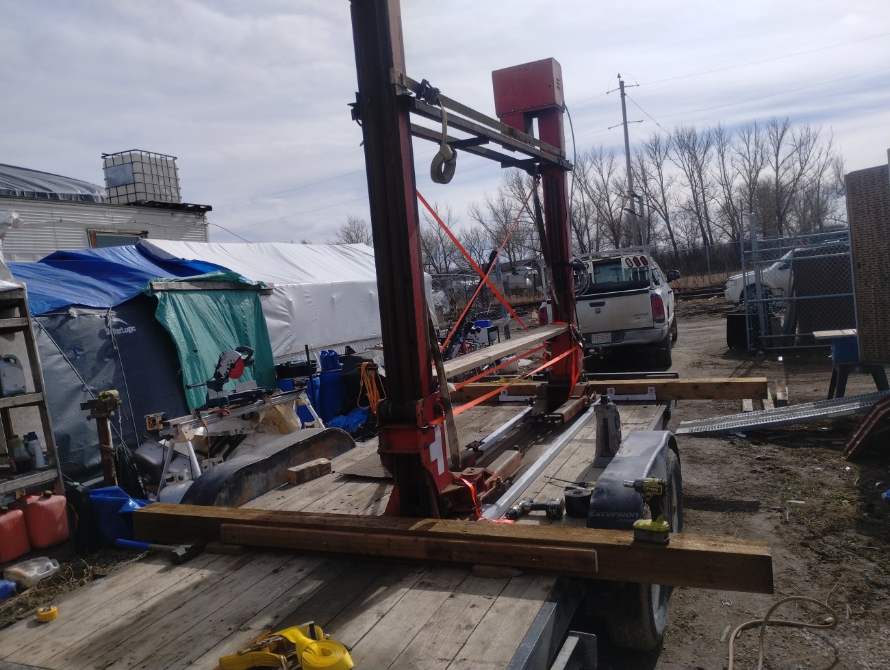

Using some 2x2 tube that I found at work, I built a better spreader bar to keep the posts from folding in;

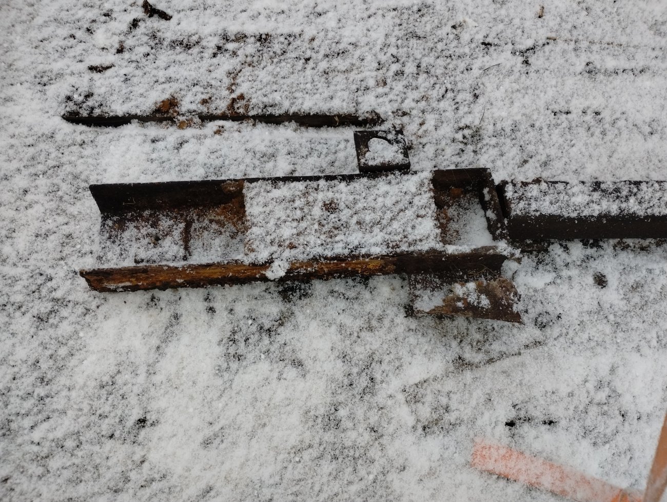

Next pic its hard to see the rot under the snow, but its there;

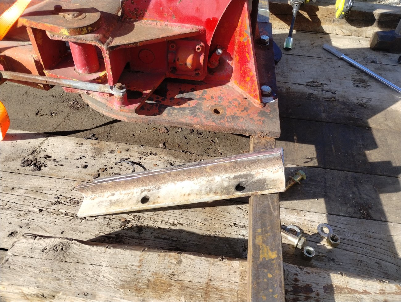

The next set of pics is of the crossbeam of the subframe. First is of the I-beam cut in half and drilled to match the post holes;

Tacking the 2x2 to the plate;
Car lift - 7,000lbs
Then a full perimeter weld. I don't want water getting in between and rusting. Ends are capped too.
Car lift - 7,000lbs
Then I cut and welded some 2"x2"x1/4" Angle to the solid bar that form the ends of the subframes.

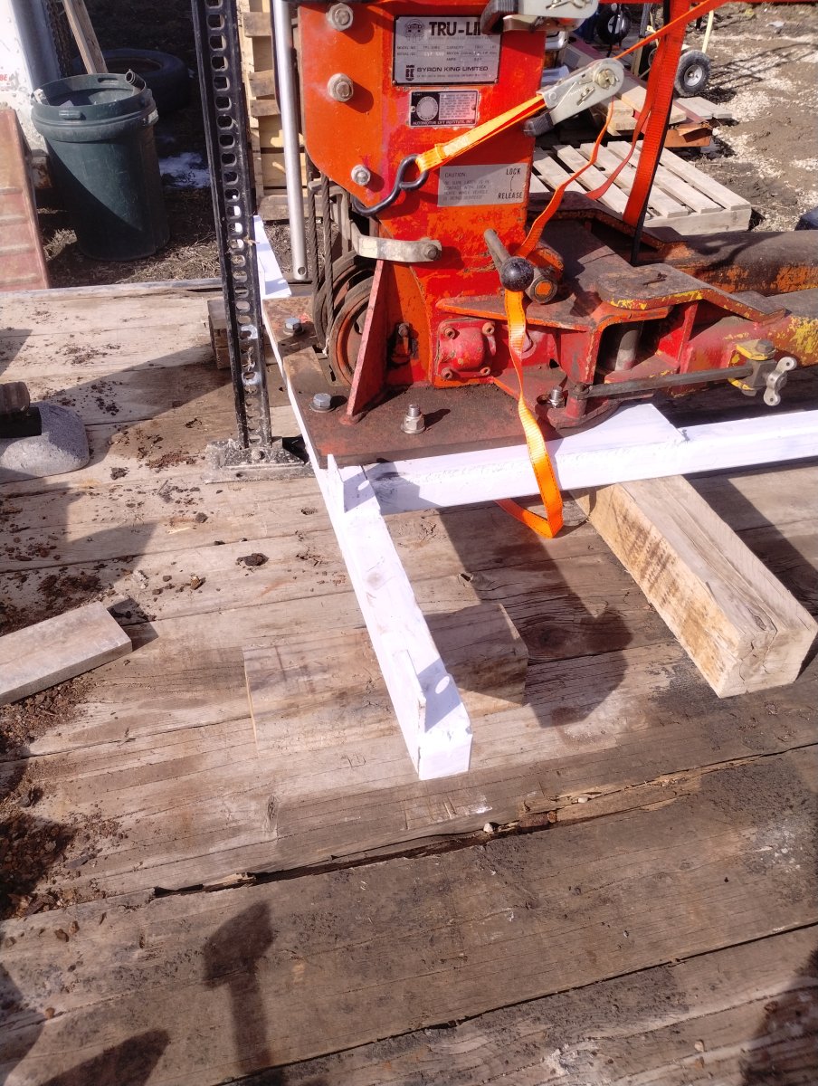

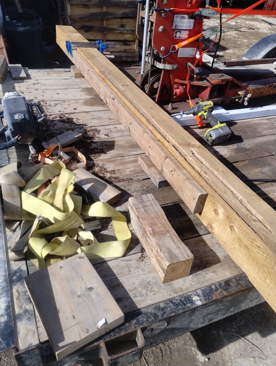

Attaching the 6x6 beams. I put a 2x4 on the outside of the beam to have something to put a jack under. I only did that because the lagbolts were too long by an 1.5" and I didn't want to cut the ends off...lol
You can see some black stuff on top of the 2x2. That is joist guard to protect the metal from the pressure treated wood. The PT will accelerate oxidation of the metal if it touches.

So the heavy steel columns are bolted through those wood beams with lag bolts? That still concerns me a little bit. I’d rather see regular threaded bolts through the wooden beam with flat plates or giant washers on the back. As that thing rocks around it’s going to be a tremendous amount of force on those leg bolts, and I fear they might loosen up one day. If it’s bolted all the way through with big washers or plates on the underside, it may get to the point it moves, but the bolts aren’t going to pull out of the wood.
In addition to that, I’d like to see some 45° braces from the columns to the wood at least 18 inches out and preferably 24 or 30 inches out. But I know that could get the way of doing work. But if you go out a little bit with a 45, that’s gonna take a lot of strain off the bolts holding it down.
And what is it going to stand on? Is it just going to lay on the dirt or gravel? You might wanna put some dirt or concrete anchors at the end of the wood leaves about three or 4 feet into the ground. Basically, it would be a big threaded rod With a flat square or round plate on the bottom down about 3 feet in the ground. Pour some thin concrete on the top of it so we can run down the sides and seal lady voids, and then bury the dirt, but compact the dirt. So the thing ever wanted to lift up, it would provide a bending moment, but also more counterweight.
My two cents, certainly available for questions
