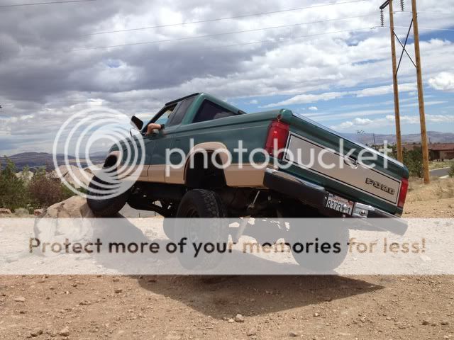

So I'm also trying to decide if i should take out my overloads [ they are from a 2500! ], and add a leaf from my original pack to still have around the same height in the rear. Because I've noticed that the OL are preventing full articulation, or drop on the other and the side being forced up. But I think my shocks might be short, but i don't know because I haven't been able to cycle my suspension. I don't have a forklift or a ramp. I'm just disappointed over all. My brother got even higher on that rock with no tires coming off the ground. In a cherokee.
This was when i went to Reno, I should have gotten out and checked but i didn't.

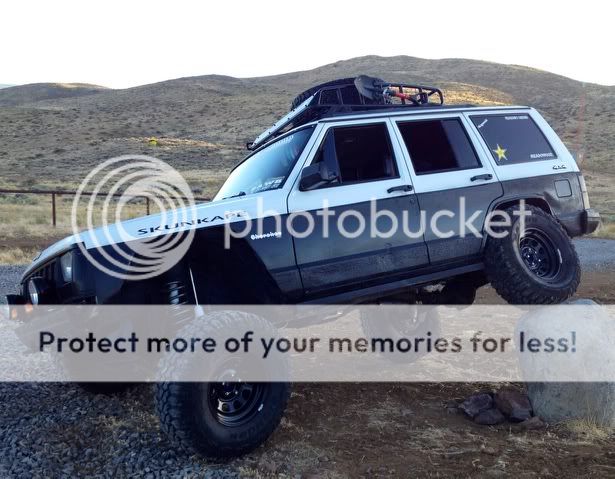

And my brothers rig. Even though he has xj coils, the rear can articulate way more then my rig, he has no overloads.
xBLAKEx's 1988 Supercab Build
The main reason he's getting more flex is he has a solid axel up front and you have the ttb. You've gotta heavily modify ttbs to get good flex. IMO its easier to sas it instead of trying to modify the ttb setup.

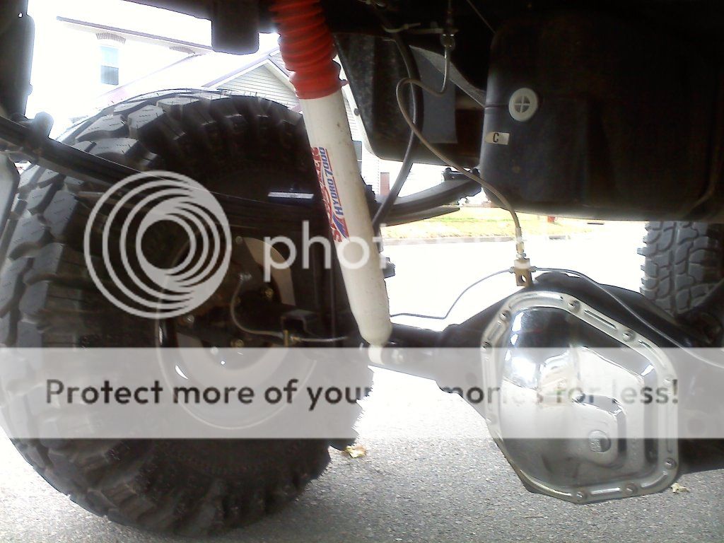

The things I could think of are, The stock shock location it preventing the shocks to fully compress and extend, and possibly the shackles are bottomed out? What do you guys think of it all? I want more out of the rear end.
I think your shocks are running out of travel. Ether need longer shocks or do like i did and move the lower shock mounts higher up on the axle to get some of the down travel back out of the shocks. It also looks like u have alot of up travel on the shocks that u will never use, so i think the best bet would be to move the lower mount.
